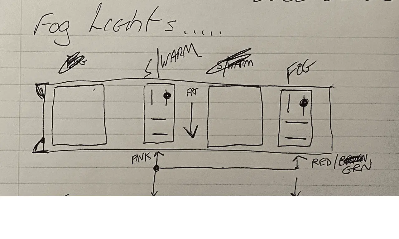

The heated seat relay is used as it is the easiest. Lots of other options. Find any "key on" 12v source. Some have used the green park light wire.

I will help as much as I can, but a voltmeter is going to be your friend. You say there is no pink wire at the relay, so what colour is it? Does it have ignition power going to it?
Looking at the relay holder, here are the pins/wires we are dealing with:

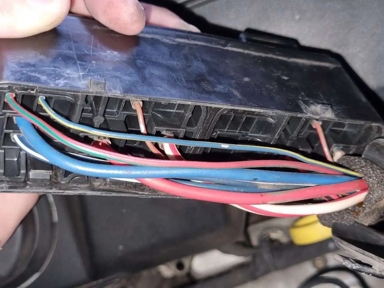

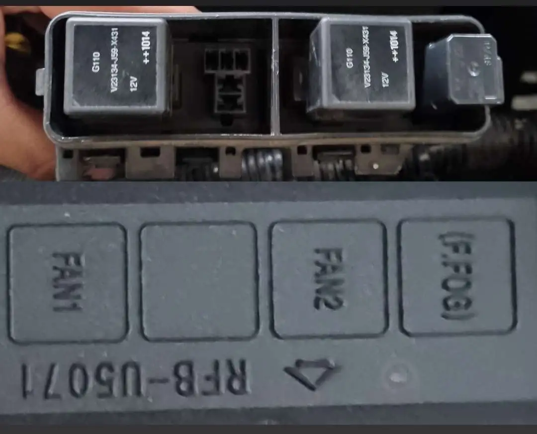

These would be the only existing cables in the front relay box, without seat heater or pink cable, only FAN1 and FAN2, Fog Lamp Relay.

No seat heater at all. I would run a wire from the park light circuit (green wire I believe) to the fog light relay. Or find an ignition hot circuit in the fuse box.
yes, indeed there is no heated seat relay, on 2010/2012 models, My CX9 2011 Grand Touring with heated seats and factory fog lights. but in the parking lights there is a yellow cable and 2 green ones, I would have to wear it during the day to test which of the 2 sends the 12v at the start.
