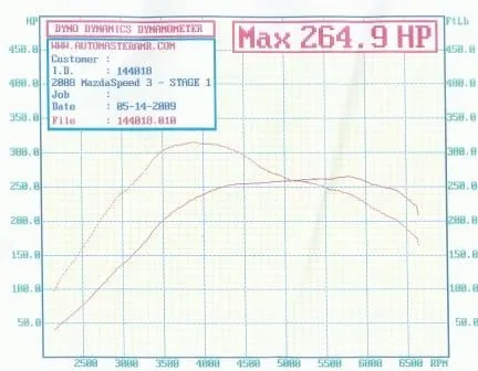

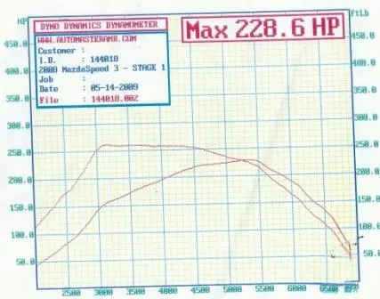

just to give you an idea of the awesomeness of the mazdaspeed top end
heres a before and after ap dyno, literally 10 minutes apart.
EDIT: I DO NOT RECOMMEND AUTOMASTER AMR FOR TUNING PURPOSES
