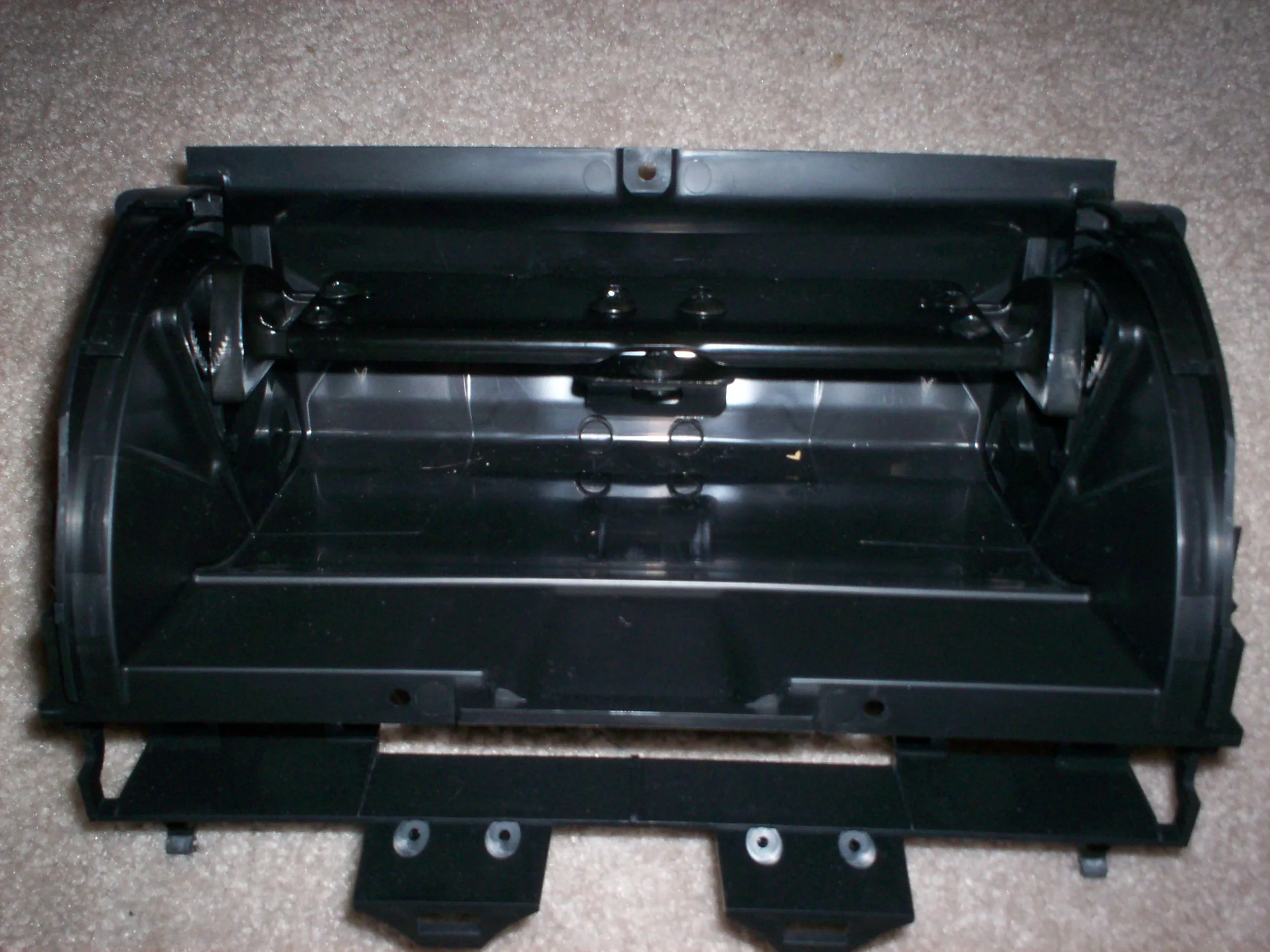

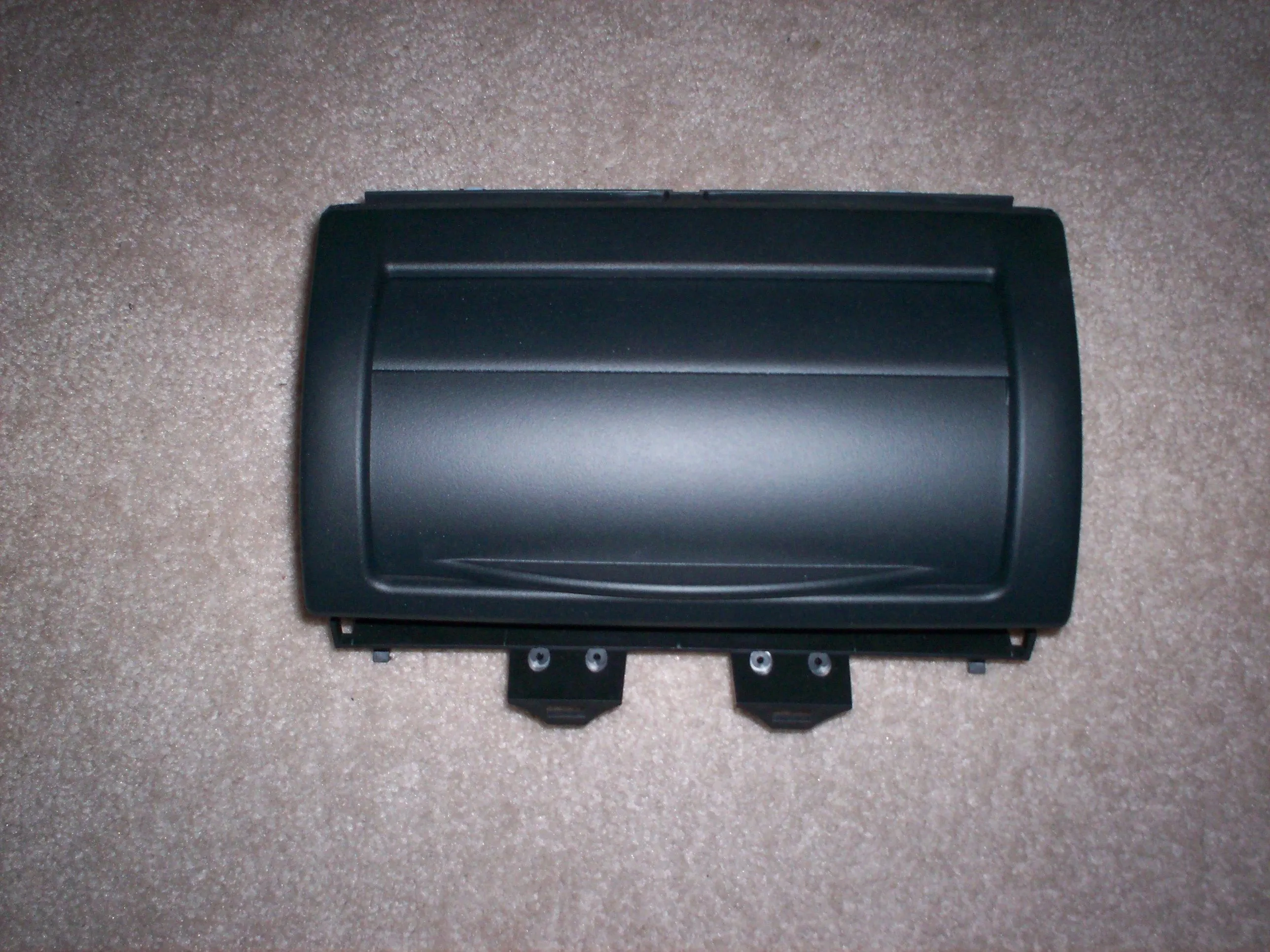

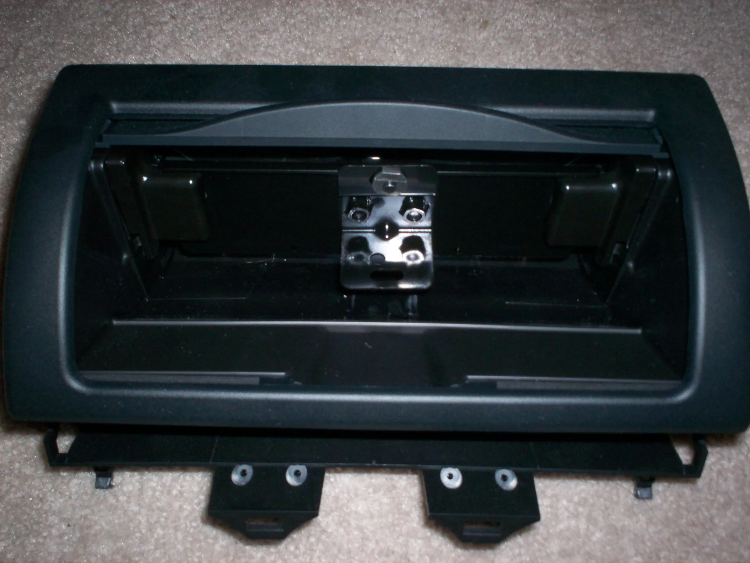

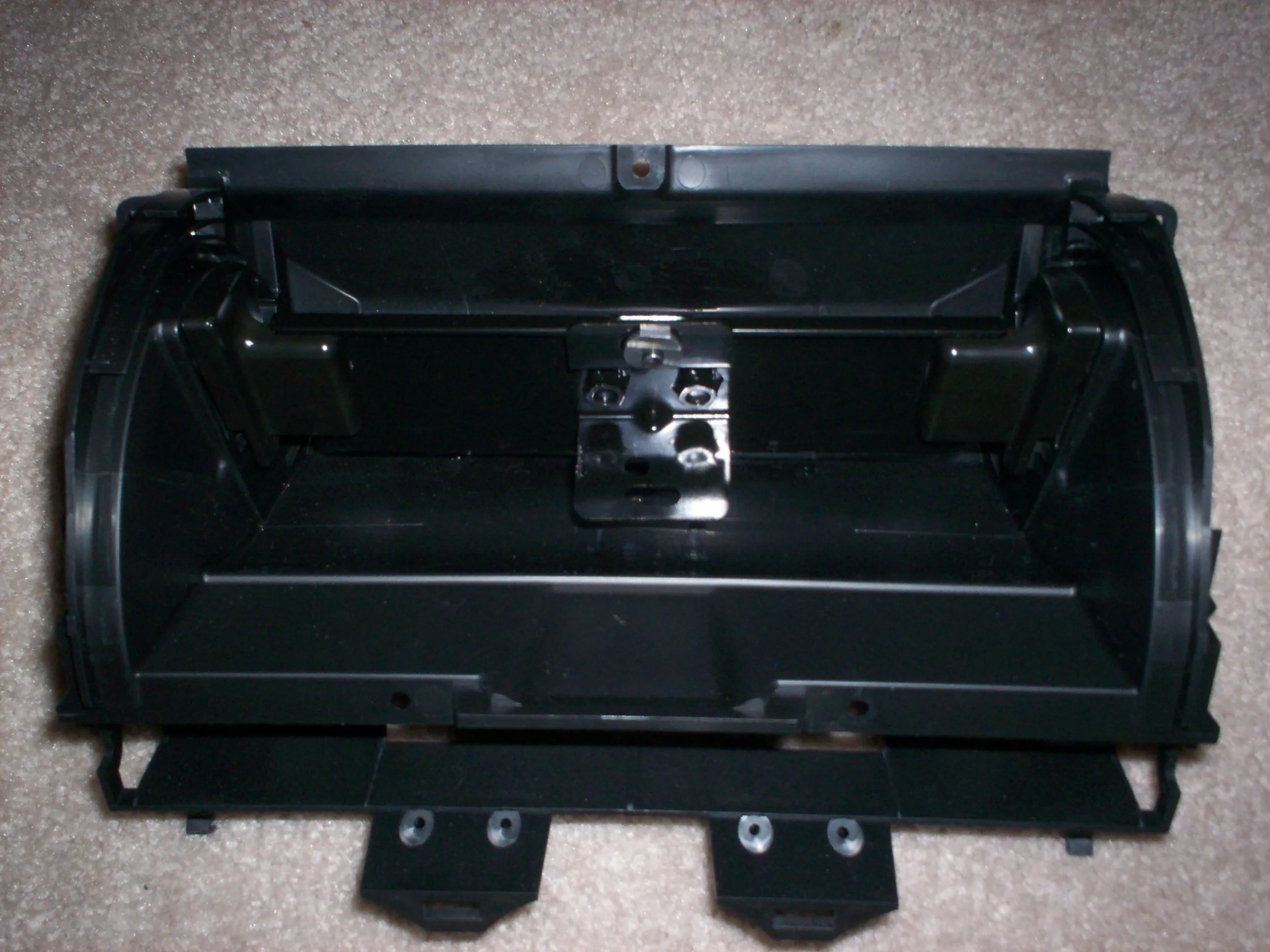

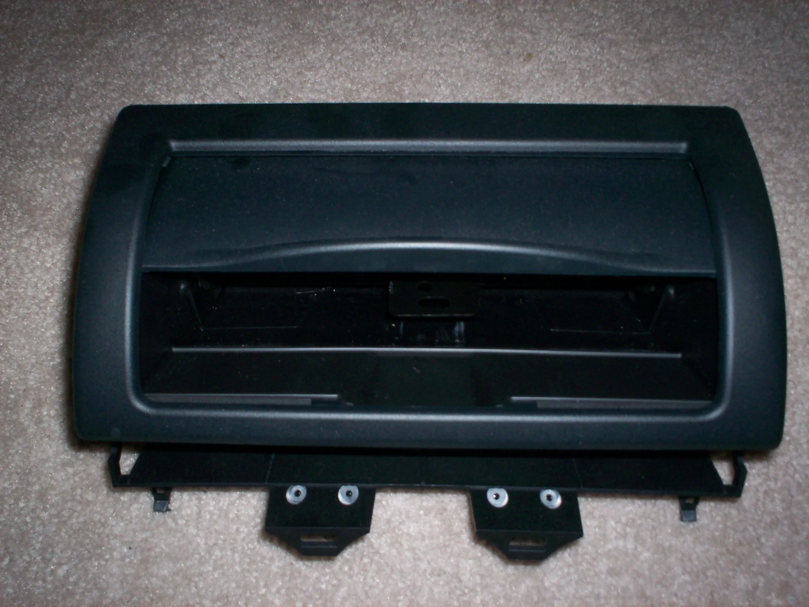

Well I got the piece from www.japanparts.com. Their customer service was great and I got the piece in a timely manner. I haven't bought the screen or the navi yet, but here are some pics of the mount. It seems well made, and should accommodate a 7" screen with no problems. I'm looking at the Kenwood LZ-702W with a Kenwood KNA-G510 Navigation system.

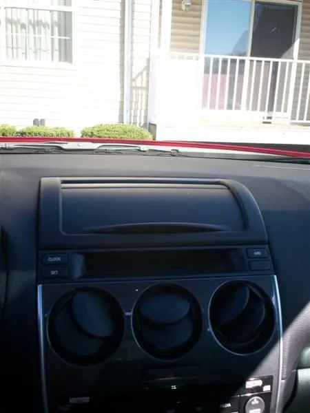

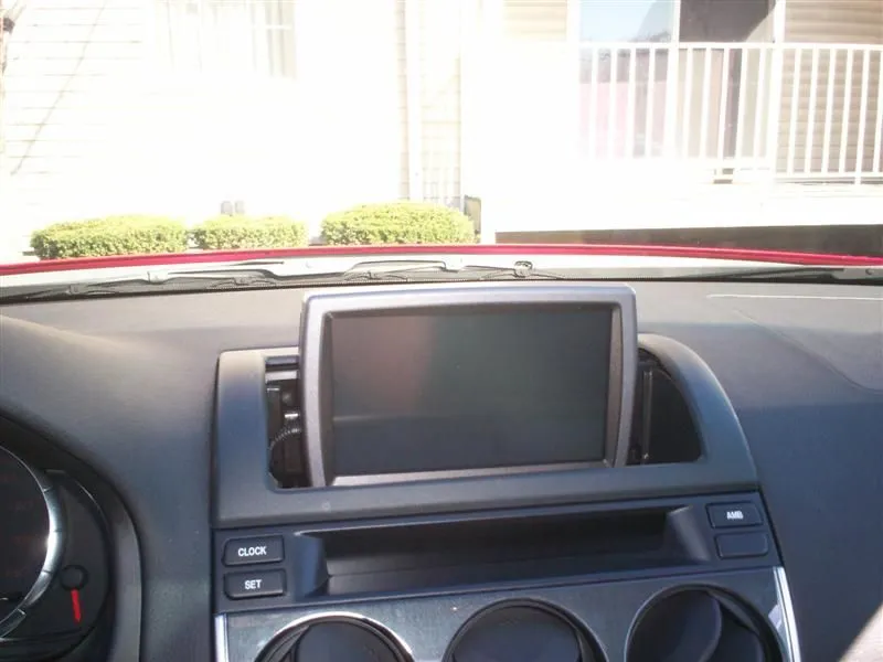

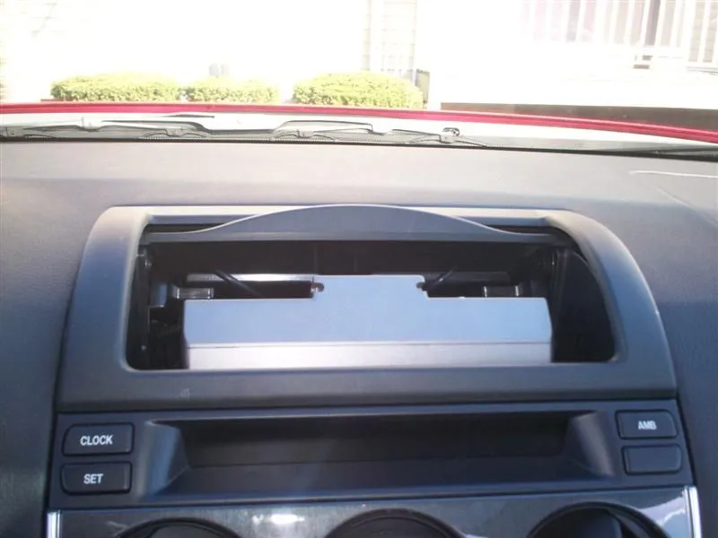

Update: Well after saving for a few months and doing tons of research, I have finally completed this project. It didn't turn out exactly how I wanted, but I think it worked out great all around.
My original plan was to install a Kenwood KNA-G510 add-on navigation system with a Kenwood LX-702W touchscreen. That screen looked like it would go perfectly with the box I bought, probably a little better than what I ended up going with. I planned on connecting the line out of the monitor to an auxmod, hence giving me the ability to listen to navigation prompts over my factory speakers.
The problem with all that is that the auxmod utilizes the tape player input of the stereo, meaning if I switched to the navigation, I wouldn't be able to listen to my radio or cds. And the KNA-G510 does not have any sort of MP3 player (How a trunk mounted unit can have far less options than a 4", dash mounted unit is beyond me, but it has no MP3, no bluetooth). So basically if I wanted to listen to the prompts, that's all I would be able to listen to. This turned me off to the KNA-G510.

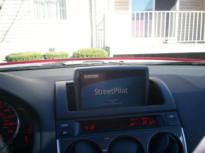

Enter the Garmin Streetpilot 7200. It has a 7" touchscreen, an mp3 player and XM radio capabilities. AND it will pause the music to give you navigation prompts. So using this unit I could upload music using a simple SD card and play the music while waiting or navigation prompts. Sure, I couldn't control the music selection with my steering wheel buttons, but I could control the volume and mute. This unit was a lot bigger than the Kenwood touch screen, but I thought it might still work.
Here is where I ran into a bit of trouble. The mount that came with the Streetpilot 7200 is rather large, and complex. It is designed to sit on the top of your dash. There was no way the mount was going to work with the box I bought, it simply made the whole thing too big. What I ended up doing (and this is not for the faint of heart), is taking apart my brand new $850 navigation system, removing the back cover, mounting the back cover to the mount of my dash box, and putting everything back together. It was tricky, but in the end I just barely got the unit to squeeze in there, and it still works great.
So I was able to install the Garmin Streetpilot 7200 into the box that I got from www.japanparts.com. I used an auxmod to connect the audio to my car speakers. Now I can switch my stereo input to the navigation, listen to mp3's through my navigation, and have the navigation pause the mp3 playback to give my guidance directions. I also highly recommend this navigation system, it has given me great directions so far, and has a lot of really cool features.
There are only really two problems with how I set this up, neither of which are really solvable the way I see it. The Garmin unit comes with a remote, but because it sits so low in the box, I have to hold the remote up in the air to get a clear shot. Not a big deal, the touch screen works great. Two, because I'm using an auxmod, if I lower the volume on the steering wheel controls, it lowers the volume of the entire unit, mp3 player and voice prompts alike. Not a big deal, you can go into the settings of the unit and lower the mp3 playback independently of the navigation prompts, it's just a little more difficult than pressing the volume buttons on the steering wheel.
Pics to follow.
Here you go.

that looks sweet, but quick question, is the screen powered? in terms of movement, i mean does it come out on its own, if not, then how does it come out.
No it doesn't. That JDM Mazda OEM screen mount for aftermarket nav is manual.
