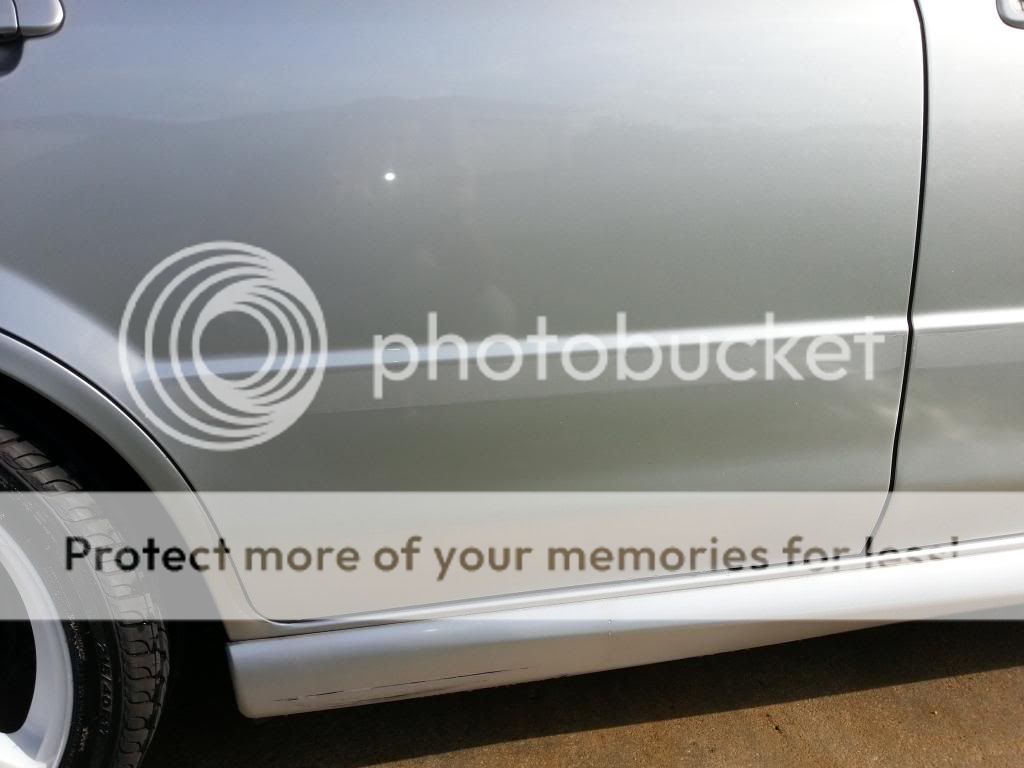

ok, just took off the door moldings. i used a piece of heavy fishing line, ran it between the molding and the door and it simply came off leaving the adhesive on the door.
now let me save you at least an hours work..... DONT WASTE YOUR TIME WITH OTHER PRODUCTS. i tried goo-b-gone, mineral spirits, gas, and "ops".....none worked very well. THE BEST was 3M adhesive remover. let it soak and it just eats away the adhesive, leaving a jelly like substance.
so after i took it off, got the glue off, i noticed a ring around where the molding was. Since it was on there since 2002, it was expected. si i took some compound and a buffer and got started.....unfortunately, this is how it turned out....
it has a very noticeable difference in color. for some reason the paint that was under the molding, is lighter then the rest of the car. so i dont know what to do now...luckaly i saved the moldings because i might have to put them back on...
the only saving grace is you cant really notice it from a distance, or up close for that matter. But i can tell, and im not to happy about it.....any suggestions?
I have no idea besides repainting it. I took off the molding today and closed the door. Put the molding right back on haha. It made it sound like such a cheap car.
Exactly what I was saying before....like a tin can...damn it, it looks so clean without them though
It sounded absolutely horrible. I'm not taking them off till I have sound deadener covering that panel haha

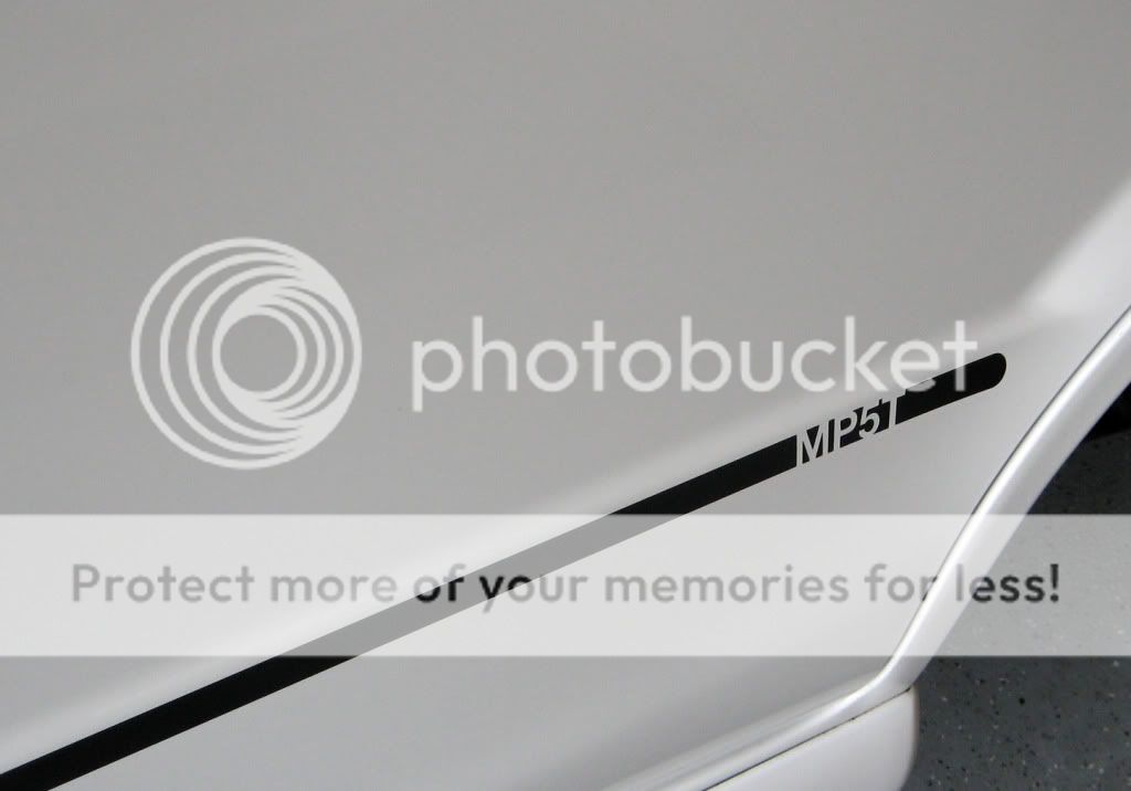

hummmm....maybe when i take the dip off the wheels, and they're black again the line could work. my "roof molding" just arrived....so ill be putting that on shortly.

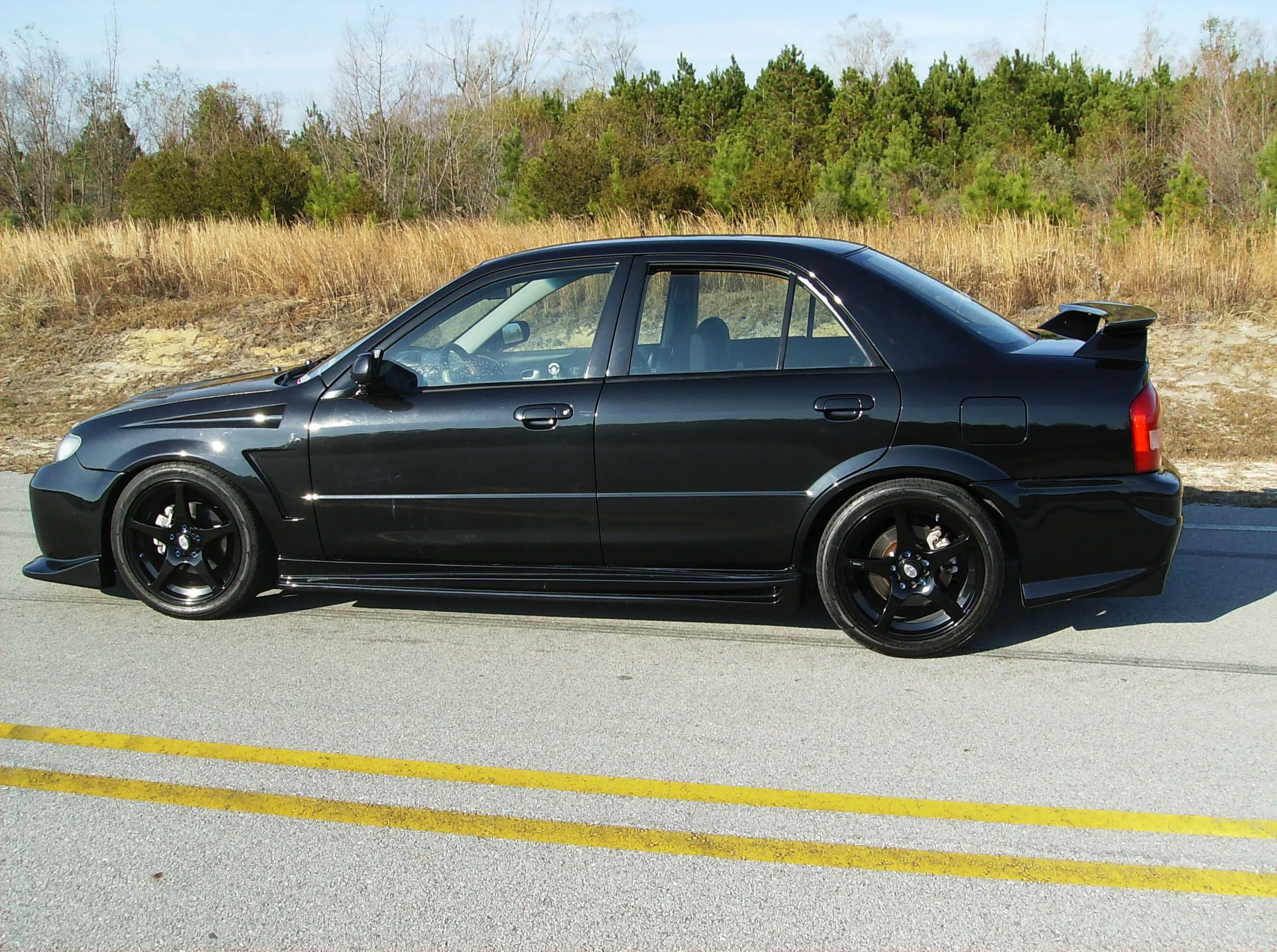

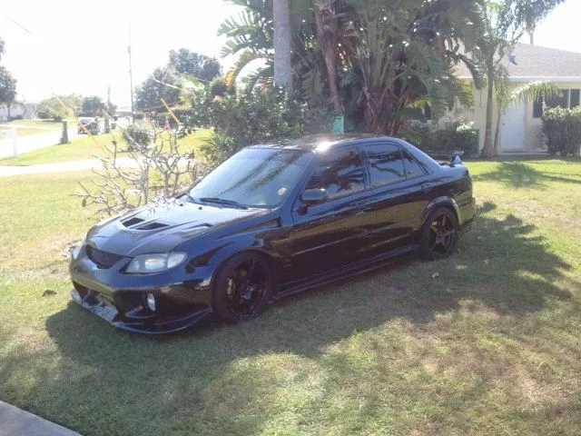

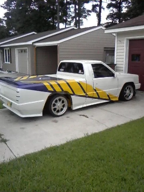

found pics of my old msp and mighty max.....dont hate on the truck, it was in my "fast and furious" days...

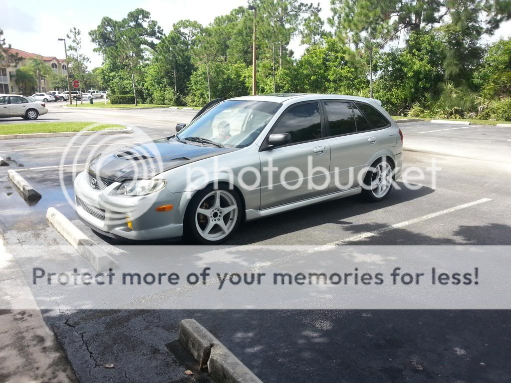

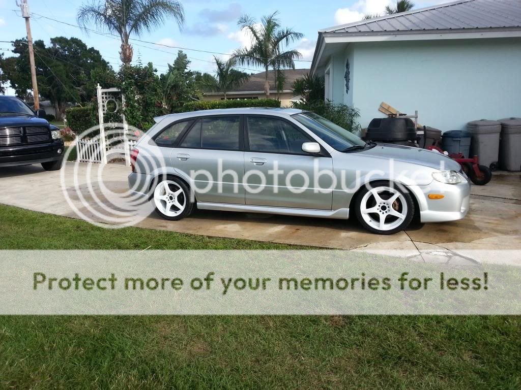

ive been out for a little, figure I would update the thread. picked up a CF hood "evo style" for $40.00, then decided I didn't like the white with all of the black accents that are being added.
so then I took off the plasti-dip and gave her a bath. I really need to paint the headlight housings and black out the mazda emblem...
what do you guys think?
