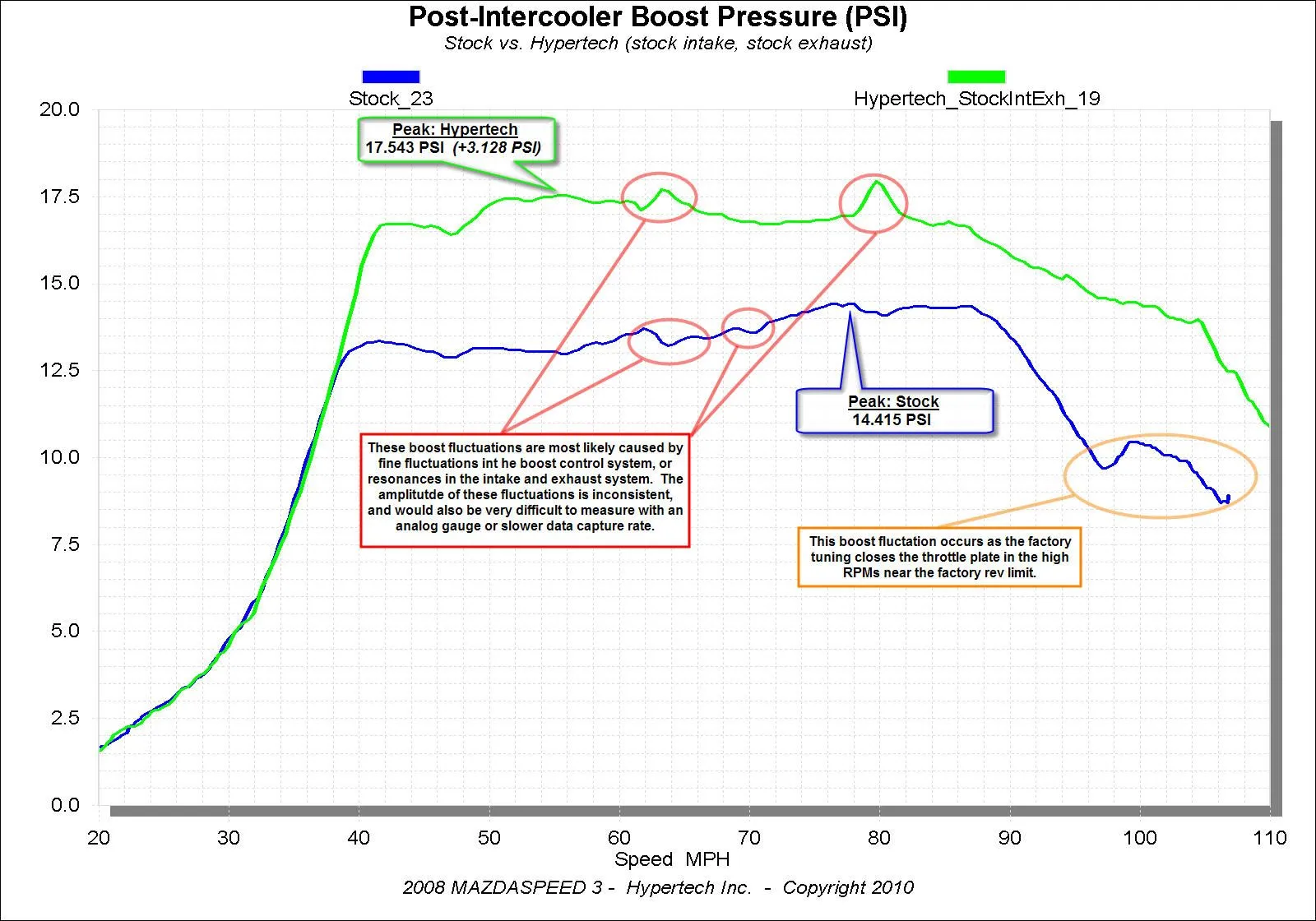

On a stock car, we measured a peak of about 17.5psi with the Hypertech tune, while the stock tune peaks at about 14.5psi. This was measured in 4th gear on our AWD Superflow dyno.

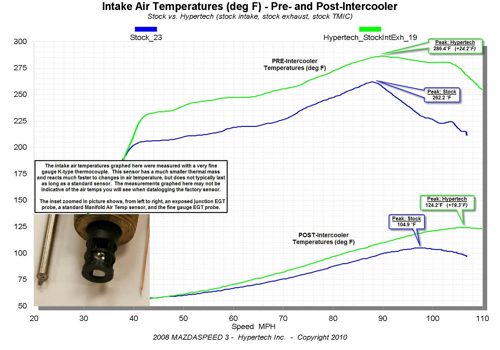

During the same dyno pulls, we measured a peak-to-peak increase of about +24F pre-intercooler, and about +19F peak-to-peak after the intercooler. These temperatures were measured with a fine gauge thermocouple that reacts much faster than a typical intake air temp sensor, so dont be surprised if these numbers are slightly different than what you measure with a datalogger. Our readings should be worse, if anything, during a similar test. This JPG does have an inset picture of the sensor we use, but it is still hard to tell that the sensor consists of two hair sized wires.

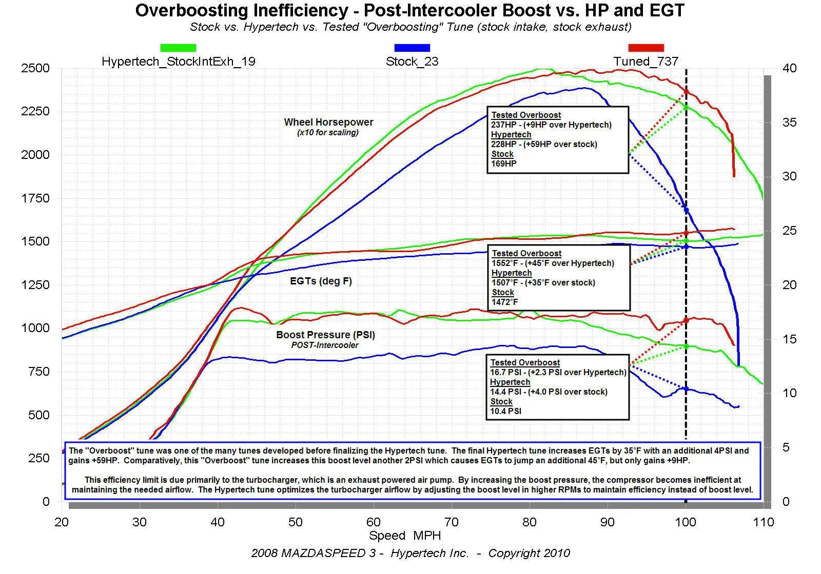

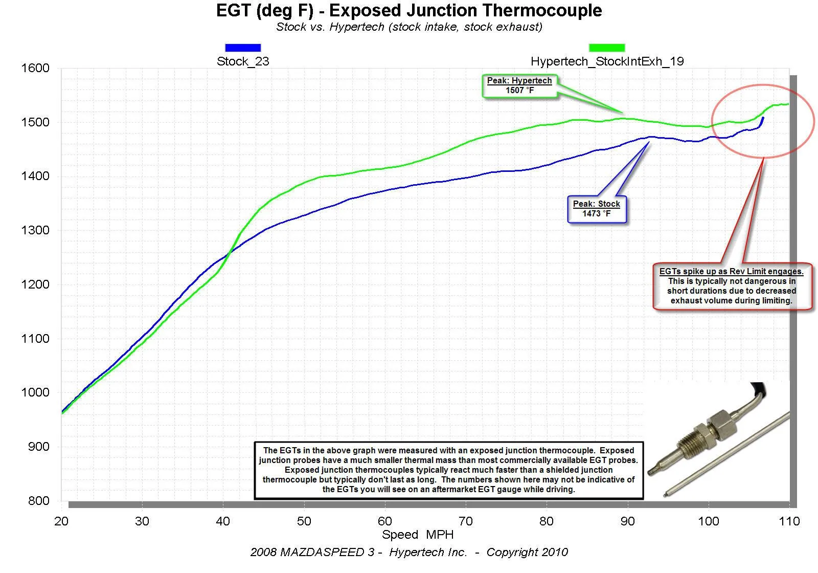

During the same dyno pulls, we measured an increase of about +34F, peak-to-peak over stock. This doesnt sound like much, but the EGTs are right at 1500F which is pretty hot when wide open. The factory tune didnt leave much room for us to make a tune that wouldnt cause problems in the long run. The power gains we got with only a +34F increase is really nice.
One thing to note is that we probably use a slightly different temperature sensor than most people are used to. We use a small wire, exposed junction thermocouple for our dyno tuning. These are much more responsive than a typical thermocouple sold with aftermarket gauges because the mass is much less (heats up quicker). This allows us to see quick changes in EGTs and have better insight as to what our tunes are doing during development. The downside to a fast probe like this is that they are fragile. If you have an aftermarket gauge your numbers may not match ours exactly due to the differences in probes and equipment.

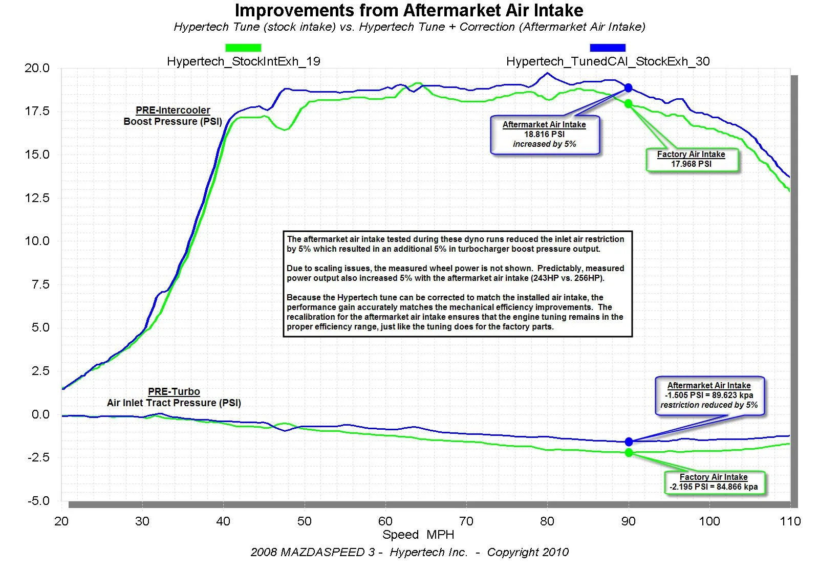

The boost curve the Hypertech tune was developed through extensive testing, and during some of that testing we tested a tune that maintained the boost pressure all the way to redline rather than dropping off in the higher RPMs. The overboost tune pushes boost up another 2psi and the result is about +50F and only +9HP. The final Hypertech tune increases boost 4psi over stock at the same point and only bumps EGTs +35F and makes +59HP. That additional 2psi just isnt worth it. Theres a lot of info on this JPG explaining what we measured.

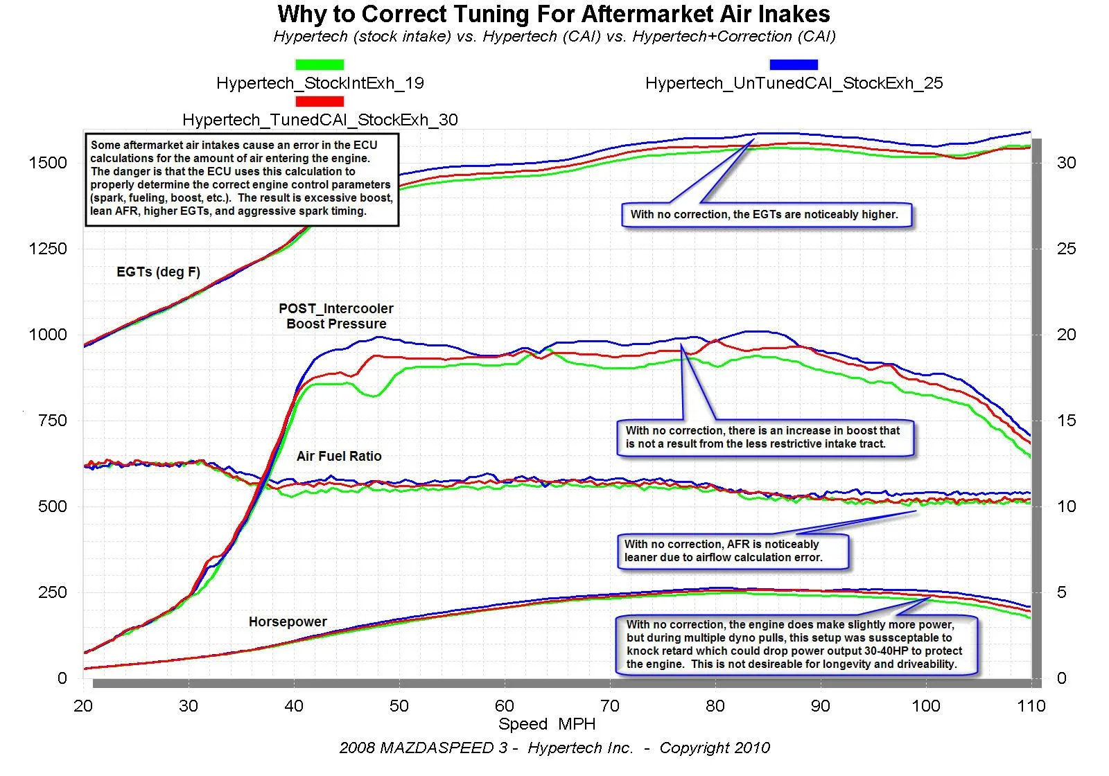

We have developed tunes for several aftermarket air intakes, and are currently adding those to the Sport. These will show up as a new feature. The new feature will ask if you have an aftermarket air intake installed, and then show you a list to choose from. This feature will be a free update for anyone who already has a Sport. It should be available by Wednesday or so next week. Ill keep you guys posted on that.
If you install an aftermarket air intake on the car, the changes to the intake tract can cause errors in the ECU calculations for the quantity of air entering the engine. The ECU uses this calculation to control many aspects of the engine, so a small error here can compound itself quickly. With no changes to the tune to account for these errors the EGTs will get hotter, boost will go too high, and AFR will lean out. By correcting these errors, the ECU will properly control the engine. The JPG goes into much more detail.
Obviously cold air intakes are popular mods because they make good power, but have you ever wondered why? We did. So, while we were testing we measured the pressure in the intake tract before the turbo with the stock intake and an aftermarket intake to see what happens. It turns out that an aftermarket air intake can reduce the inlet restriction by 5%, and because thats a direct restriction to the turbo, the output boost jumps up by that same 5%. And with more air comes more power. The Hypertech tune provides that same 5% increase in power youd expect when an air intake is added on. The tune is absolutely set to respond to additional mods.

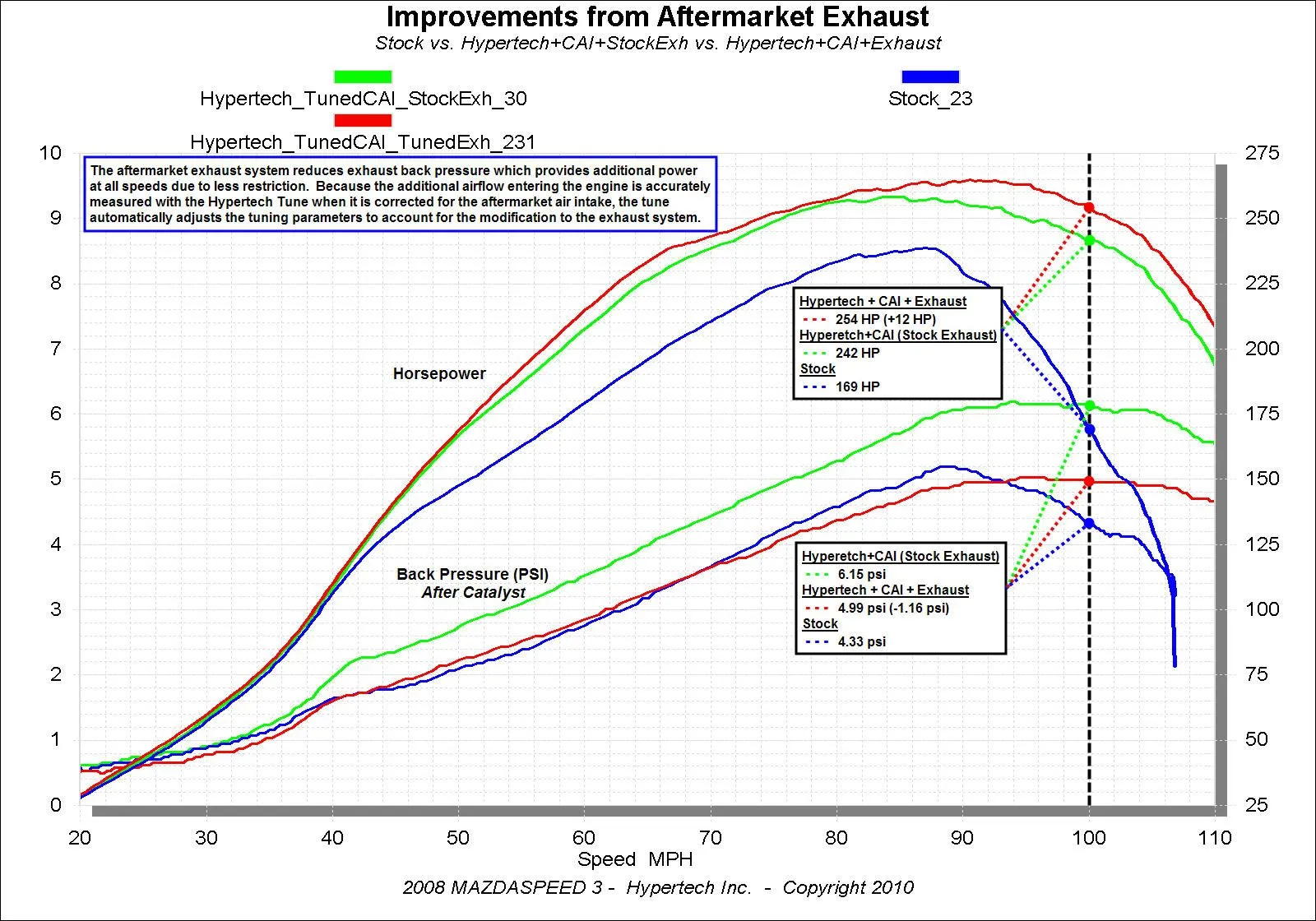

Exhaust systems are also very popular mods for these cars, and after testing our tuning with aftermarket exhaust systems on the dyno we can see why they make such an improvement in power. We measured the back pressure in the exhaust system after the catalyst during our dyno pulls and saw that an aftermarket exhaust system dramatically reduces the back pressure. Testing with an aftermarket air intake with our Hypertech tuning, we saw exhaust back pressure drop from just over 6 psi with the stock exhaust to 5psi with the aftermarket exhaust. This is roughly a 15% drop in back pressure, which resulted in additional +12HP to the ground. The additional fresh air getting into the engine was accounted for by the mass air calculations and the tuning was automatically adjusted to maintain the proper controls with the additional power. We did spend the time to adjust the tuning to see if more could be gained, but in the end, the tune is still optimized the best it can be. The additional modifications are already accounted for, so there is no need for an additional feature to adjust the tuning to account for an aftermarket exhaust system. You can see this is the case by the power gains measured at all points in the curve when the aftermarket exhaust is installed when compared to the same tune with the factory exhaust system.

2 - Your comments on the exhaust are just cat-back and not turbo-back, right?

2. Correct. Cat-back only. All of our tunes must meet 50-state emissions standards, so we wont offer a tune for this modification.
