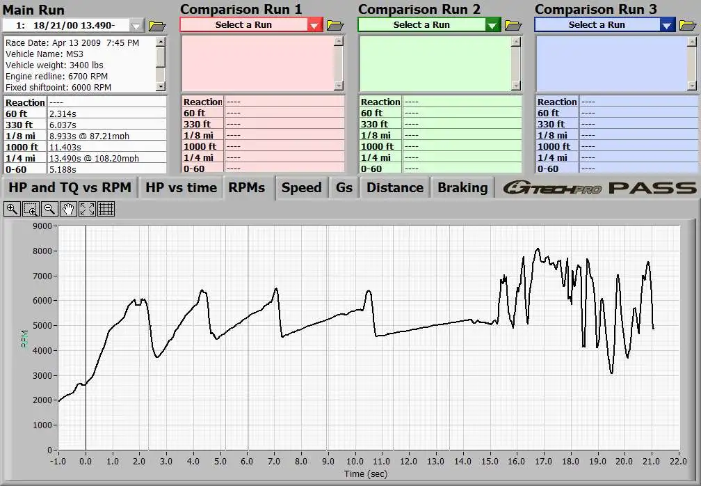

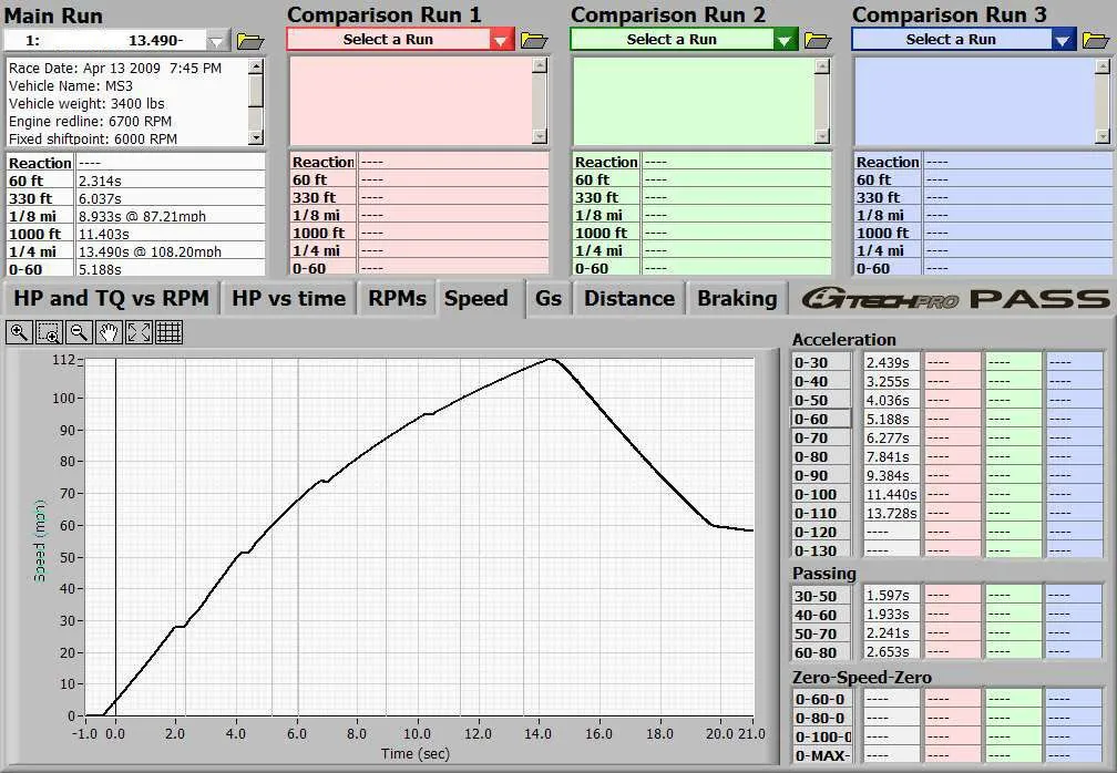

Or get that stop watch! Even better, there is a much better tuning tool than either a dyno or DH or AP monitoring -- a high grade accelerometer, such as the G-Tech Pro RR. It is about the same price as a DH but provides real time measurement of time, speed and distance measurements based on vehicle movement. It can make computer generated charts of all sorts of things. Attached is a chart made with my mods, showing exactly what the car is doing in terms of acceleration in every gear during a WOT run. And you can do a WOT in a single gear through any rpm range you want and see where any changes in performance are actually taking place.
Here are two charts - time v. speed and rpm v. speed. Note that you get artifact on the rpm chart when you completely lift the throttle at the end of the run, so disregard the big spikes at the end. And also note the effect of power or flat shifting at about 5,500-5,800 on each run.
I find tuning tools like this far more useful in evaluation whether a change is producing more power, but a good stopwatch will get you 90% there.
Dyno time gets expensive and can't really tell you as much as you think, especially if you cannot manage to do your before and after testing on the same day on the same machine with the same operator.
