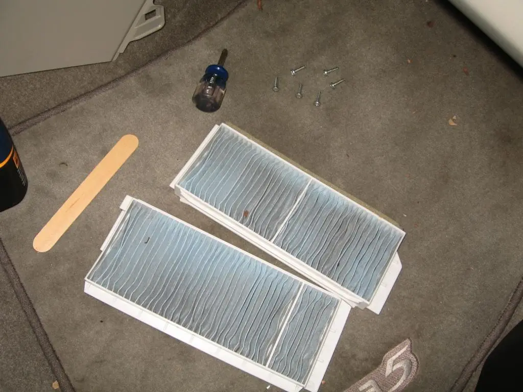

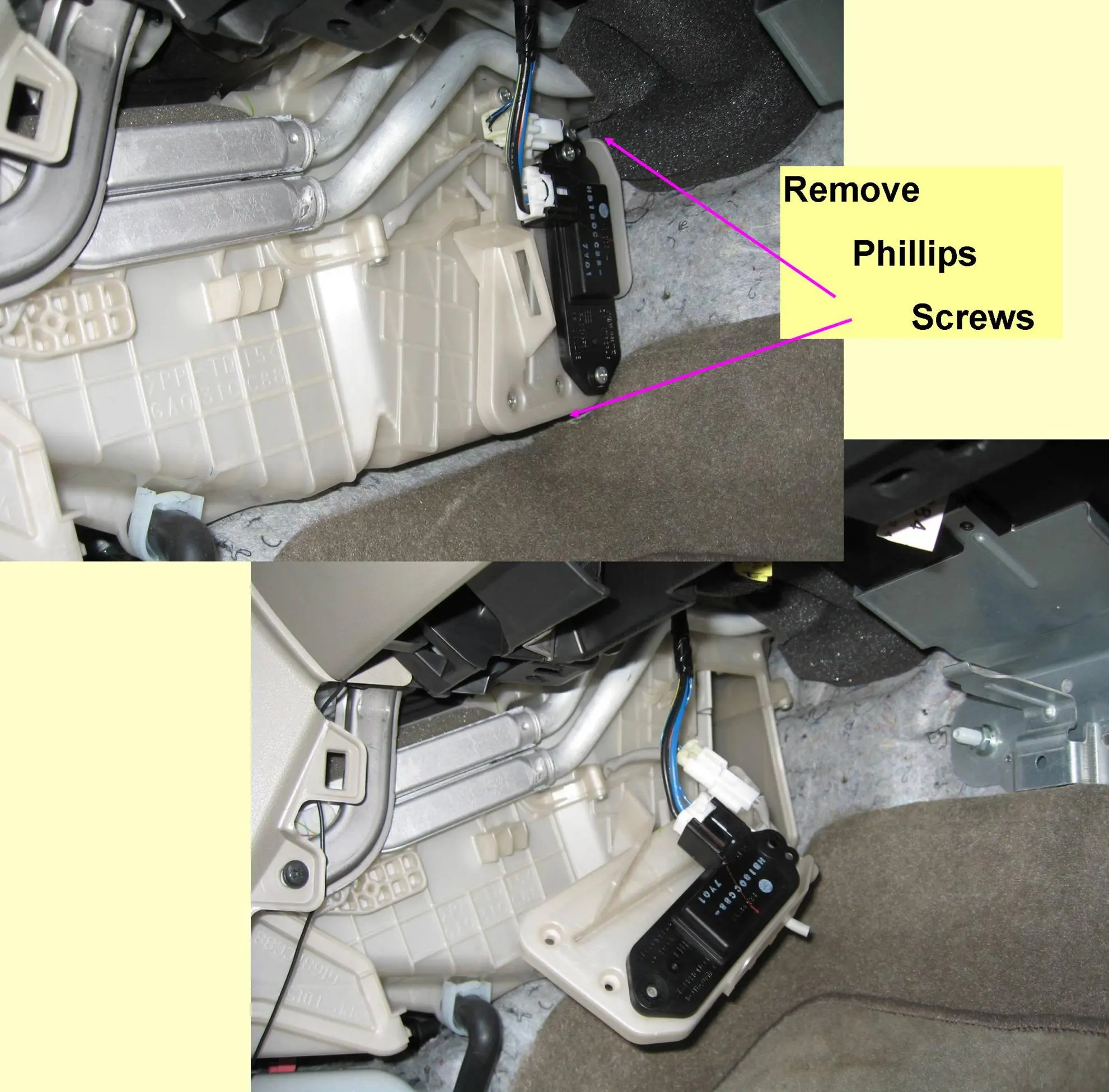

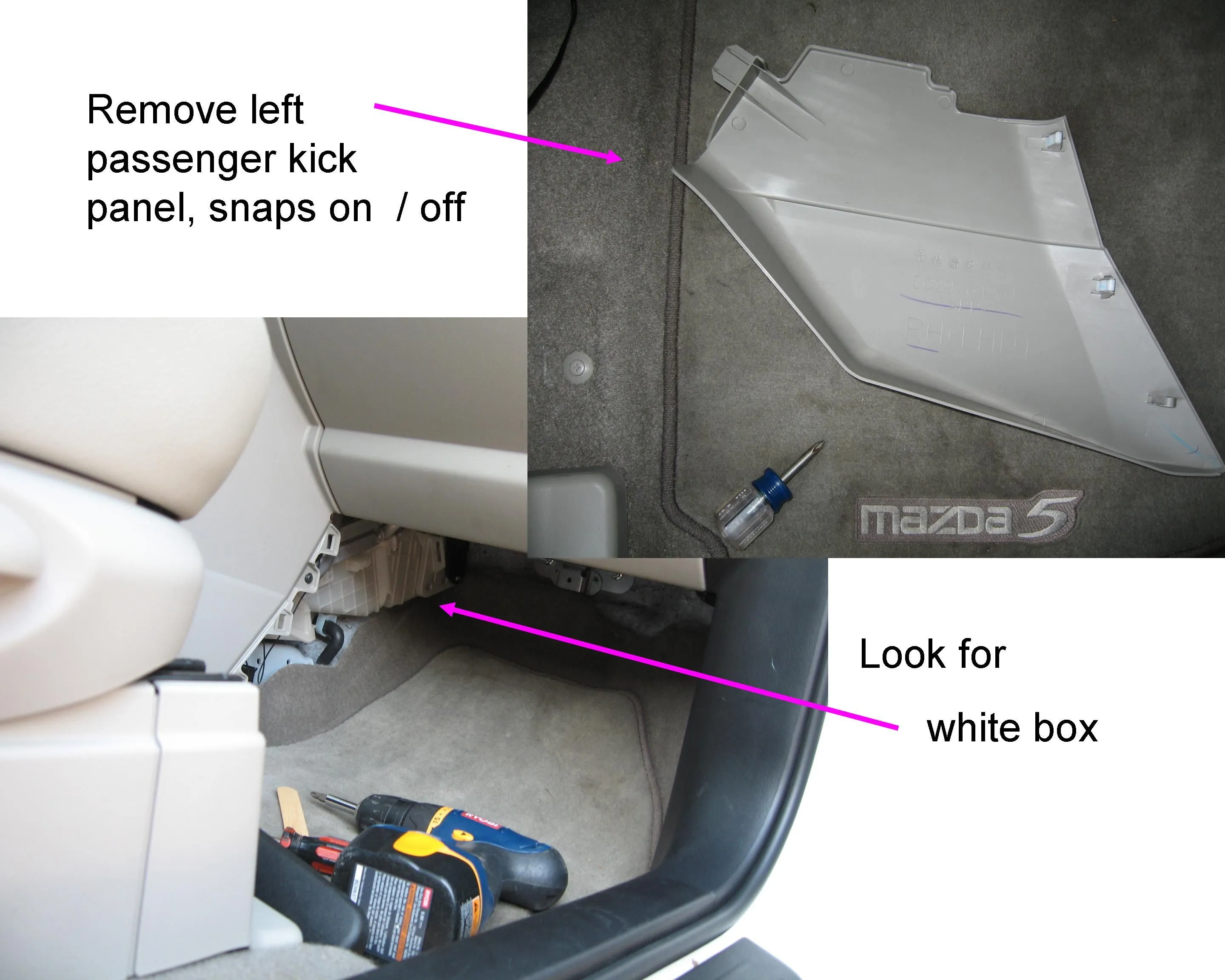

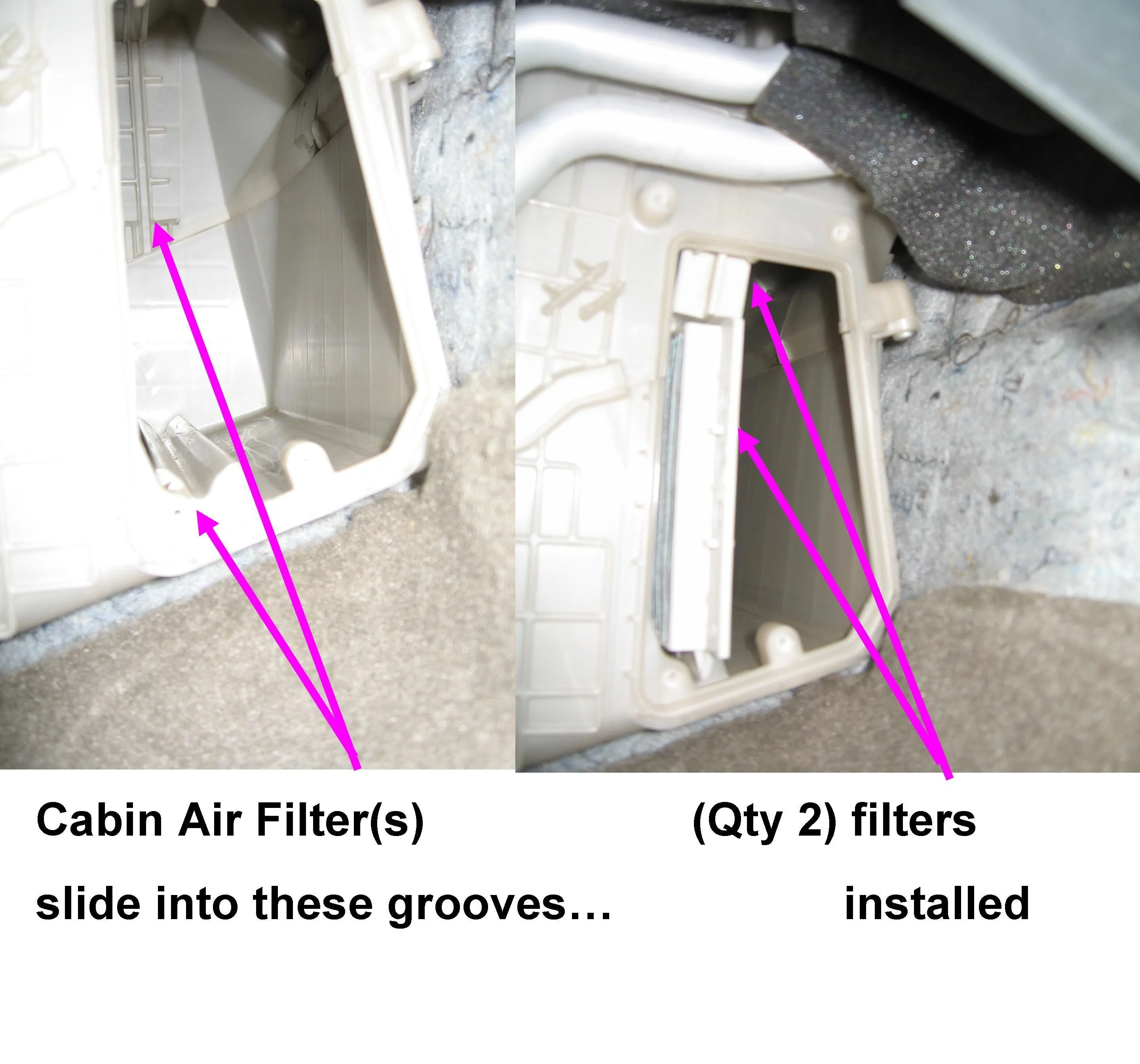

Here are some pictures of how to replace the cabin air filter in a 2008 MAZDA5. It is very easy to change the filters and should take about 20 minutes including gathering the tools (a short phillips screwdriver). The pictures do not show removal of the black under glovebox panel. This is easy to remove - permanently. It is a decorative piece no one can see unless your working under the dash / below the glovebox. It just snaps on / off. Pitch it or use it to mount your 12v inverter to power your laptop. Cheers!

Oy....just finished replacing my cabin filters. I should've just paid mazda $100 to change it for me. Did anybody else have trouble removing the 6th screw? I ended up breaking that last screw off. Putting the filters in wasn't as bad as I thought but i think i just got lucky. I ended up leaving one of the screws off (too much of a pain to screw it back in).
The top screw closest to the firewall was the most difficult to remove. I had to use a stubby screwdriver instead of a regular one. The next hardest was putting the filters back because one is stack on top the other and there was not must space to work. It is a DIY project that should not take more than an hour.

It's a DIY project, just be prepared to be cursing the designers. Ours is an 08 with rear air and trying to get both filters in is a challenge. I've had other cars with cabin filters and none were as oddly packaged as the 5! It can be done, but be prepared for it to take an hour.
FYI - I changed my cabin filters when I did my last oil change @ 19k. The car was on ramps, so there was not nearly as much contorting to do to get to the screws. I was dreading this based on everyone's expression of discomfort involved. But, I can tell you that the front end being on ramps made it very simple. A stubby philips head screwdriver is a must for the top screw.
Pay attention to how the old ones come out. Basically put the top one in first (foam gasket side up, finger tab facing you), slide it up to the top of the housing and hold it in place with your right hand, then slide the lower one in with your left hand, making sure the grooves of the two filters slide into each other.
Seariously, it took no longer than 5 minutes for my first time doing it.
Ah, ramps! That's what I'll do the next time.
Thanks Delsherif! Pictures were very helpful. Got a little confused b/c I only had to remove 4 screws rather than 6. Took about 20 minutes. As stated repeatedly, the screw closest to the firewall is a bi$%h! Maybe it was totally mental but it seemed like it was easier to remove if it wasn't the last one out. I couldn't get it to budge until I reinserted the bottom screw closest to the firewall. In my mind that took some pressure off the top one. Who knows? You are going to need a Phillips head screwdriver that is shorter than approx. 4" for the top one closest to the firewall. Other 3 can (and should) be accessed with a drill and bit. I like the plastic adornment (hey it's the wife's car!) so I replaced the plastic cover...although it seemed a bit floppy and I hate rattles more than I like adornment, so it may be gone soon. Didn't seem to follow the answers above so I will ask again...is the twin filter design part of the rear air set-up? I have an '08 Grand Touring (although I think the rear vents were standard). I assume that there is not a separate rear air filter as well.

holy crap this looks way easier than on other mazda's...on my 3 I have to pull the glove box...all of the wiring has to be disconnected from the fuse panel...and even then there are still one or two bolts that are blind....and a huge pita to get out and back in

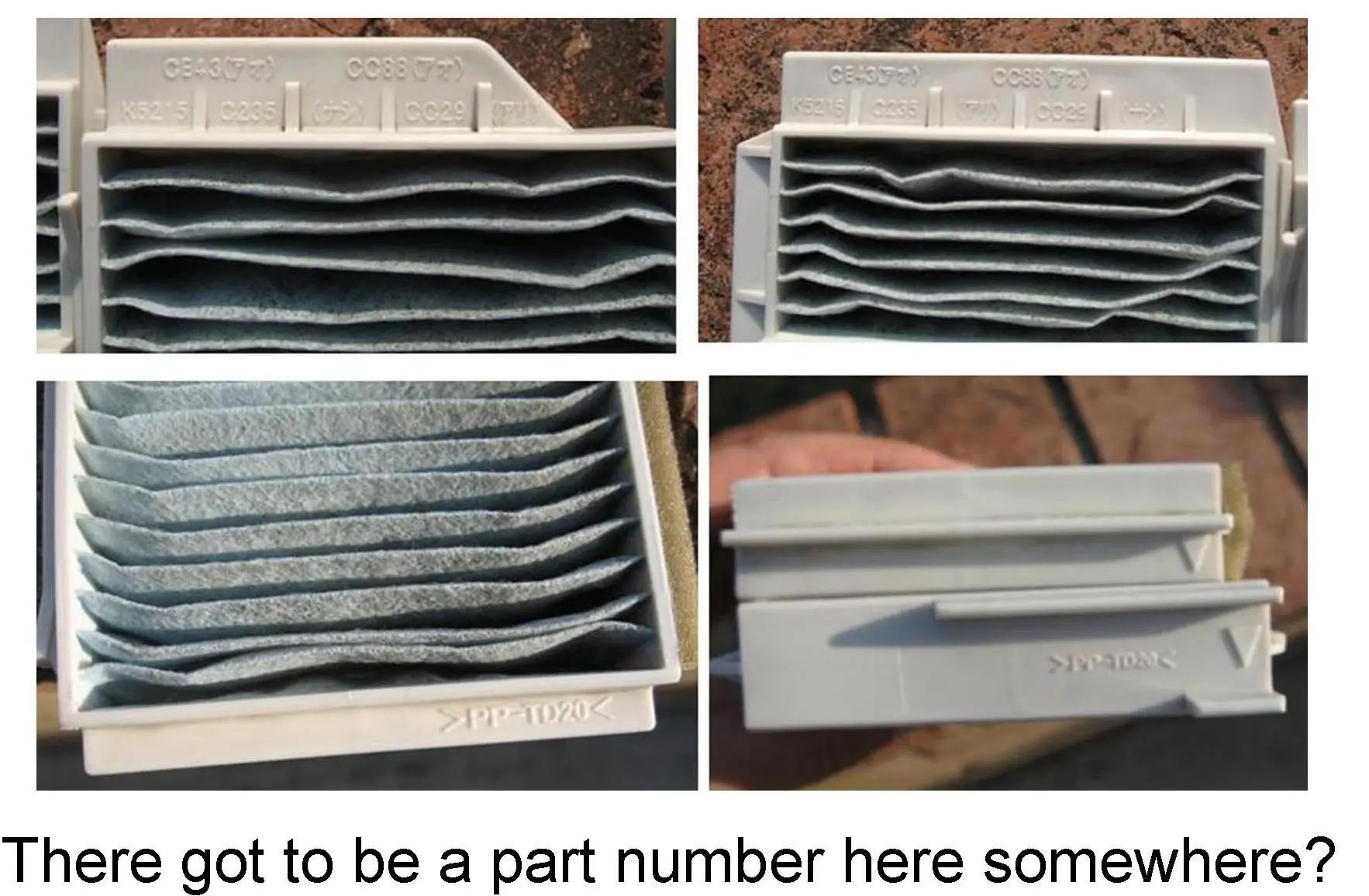

found these part numbers which may help
CC2961J6X FILTER,COOLING UNIT W/O R. VENTILATOR (Required: 001)
CE4961J6X FILTER,COOLING UNIT W/R. VENTILATOR (Required: 001)
I am not sure what the difference is between the elements but there does appear to be two different filters you could get depending on if you have the rear vents or not.
