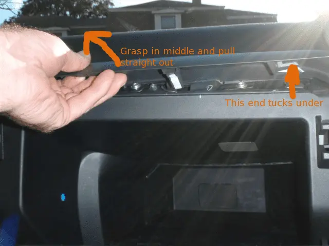

Step 2: Remove top trim
To remove the top trim (the long piece that surrounds the clock/audio display and covers the top of the glove box, use your fingers to grasp it in the middle and pull straight out. See the photo. The right end tucks under so be careful not to pull there. You will need to tuck it back in coordinated with pushing to reinstall the trim.

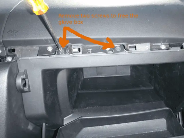

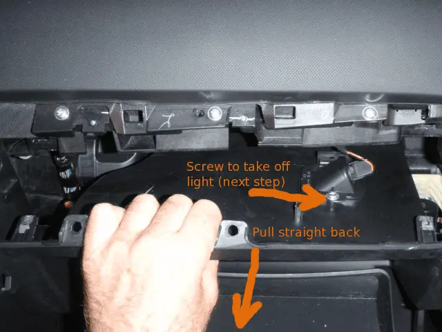

Step 4: Remove glove box
Empty the box. Remove the two screws at top. See the photo. Grab the top lip and pull straight back, releasing several retainers. You will have to stop before removing the box to unscrew and remove the box light.

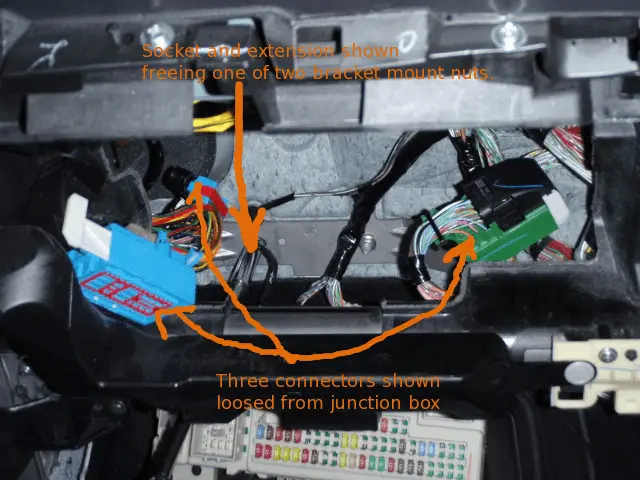

Step 5: Move the junction box
The electric junction box is in the way when the filters are slid out. Remember to disconnect the negative battery terminal. The service bulleting referenced later says to wait at least one minute before doing anything more. Unscrew the two retaining thumb screws allowing the box to drop down on it's hinges. Release the three electrical connectors that are on top. see the photo. Swing the box down all the way to expose two mounting nuts on the box's mounting bracket. Remove both nuts with the 12 mm socket. Pull the whole mess off the firewall and push it nicely down and right away from the center console. This part is difficult but does not have to be perfect. It is difficut because it is attached to the carpet and to other wire connectors. That is ok because you will need to reposition it frequently while jockeying the filters in and out.

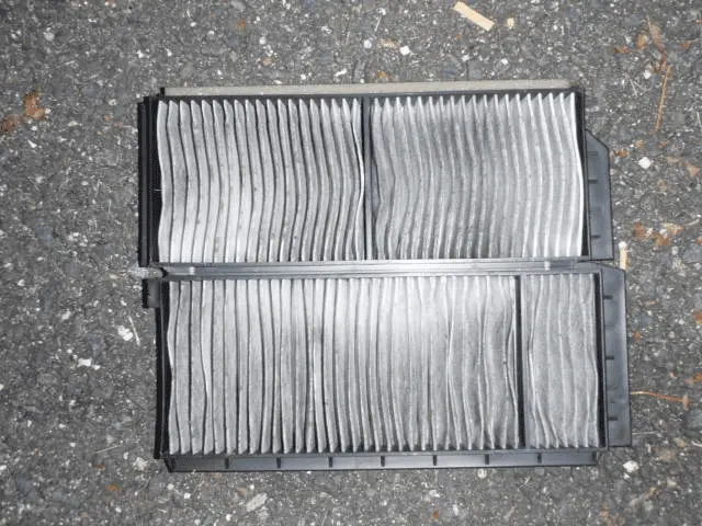

Note how they came out, especially fore and aft in the window. It's hard to see the mounting grooves in the housing. If you cannot remember which filter is which refer to the photo. The top one comes out last and goes in first. It is the one with the foam on top. See the photo for orientation. There are ramped lead-in flanges on the bottom of it for the lower, second filter to slide into.
Remove and replace the filters.

I am a non-smoker. The filters were pretty clean at 30K miles. You could hold them up to the light and see quite well through them. In fact I've set them aside for possible re-use.
The climate in New England is not very dusty and there are few gravel roads. I was not having any problems with feeling the AC, either. The reason for erring on the side of preventive maintenance was concern over getting my allergies riled up.
