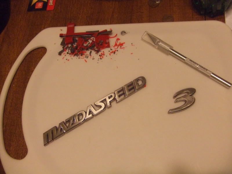

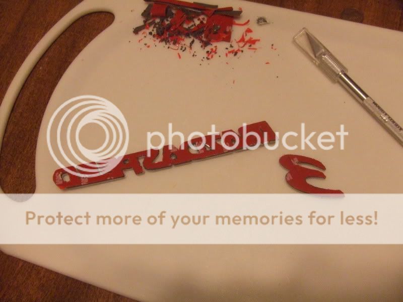

After the 3M Emblem Adhesive cement stuff ruined the paint on my badges, I tried this...
Went out and got a hobby knife/exacto knife/whatever you want to call it and some of that 3M double sided tape (it's a gray color and red backing). Covered the back of the badges with the tape and used the exacto-knife to cut around the edges and inside the As and Ds and such. Yes... it sucked and took forever but I don't feel like spending $85 or so for this stuff from SU.
Repainting tomorrow and will attach when back from vacation.
