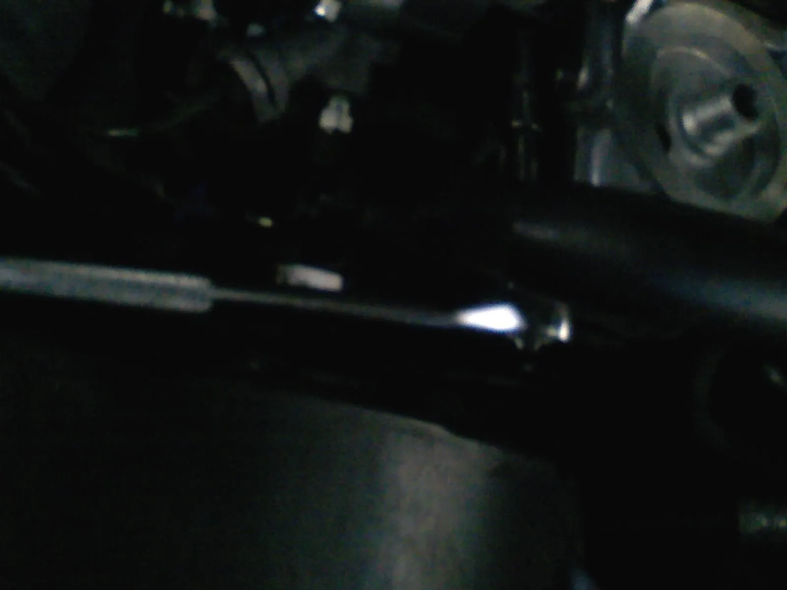

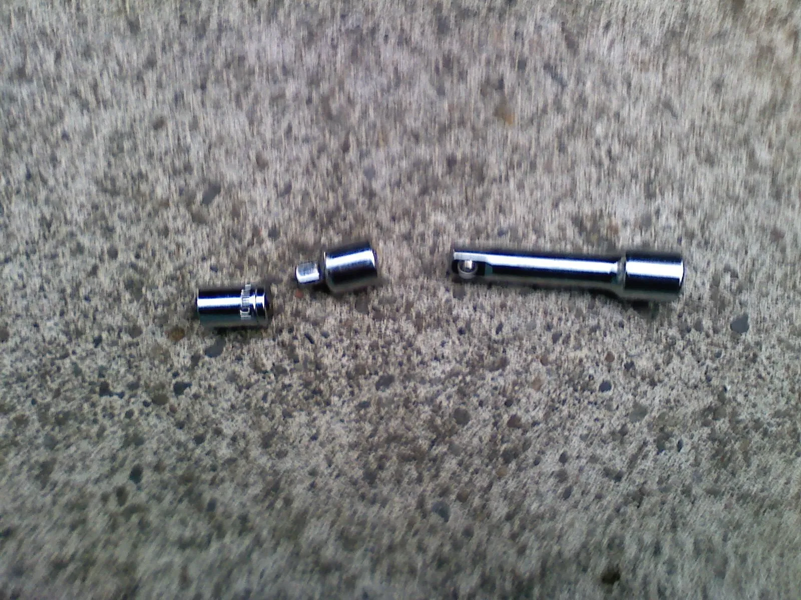

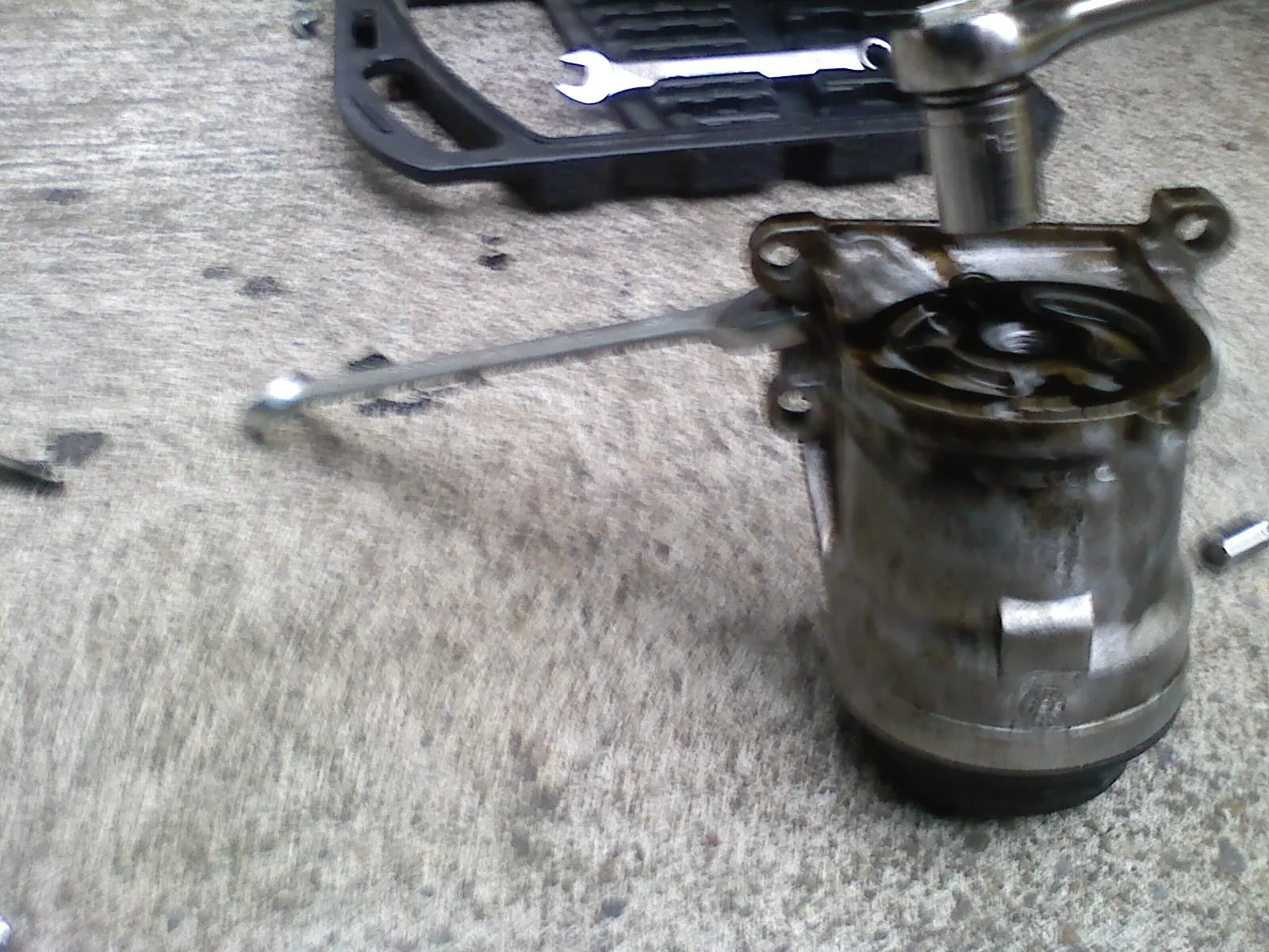

Hey thanks this really helped! I just want to add that i had to use a 16mm socket to get the bolt off the top instead of the 3/4 socket. I did however find a good way to get the 10mm bolts off i used an extension that made it a little longer to give u more leverage works very well. Also you are right about getting the top bolt off it took me an extra 5 mins to find a good way to get it off. After you have all 4 bolts off and its just hanging there use a wrench on the edge where the bottom left bolt use to be to hold it in place while u loosen the top bolt. here are some pics i quickly took with my phone sorry about the bad quality. PS when taken the 10mm bolts off make sure to put the socket on the bolt first then try to attach ur ratchet worked better for me.
