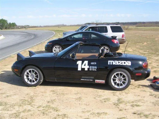

Don't want to burst your bubble, but you may have wanted to pick a more legible font. I'm not sure how easy it will be for the timing trailer and corner workers to make out your 5s from a distance. They might be OK, though.
Like I said, no problem to change, as I bought extra schwag. It should be okay though, once I paint them with a high contrast color (dark blue)
I don't think there will be a problem once they're painted. It's a bit funky, but they look meaty enough to be visible.
EDIT: Then again, I had numbers you could see from space...

Try the 50-50 rule on them. Can somebody from 50 feet away read them at 50 MPH?
Make sure they meet all the requirements from the rulebook. I am not sure if they meet the stroke width requirement at the top of those 5's.
E.Numbers must be a minimum of 8" high with a 1.25" stroke. Class letters must be a minimum of 4" high with a 0.75" stroke. In all cases, the height of the class letters must be between 25% and 75% of the height of the numbers. Stroke width must be at least 10% of the height. (See Appendix F.)

^^yep...AC Moore or Michael's will have sheets for cheap. i made my numbers out of adhesive vinyl (available at said arts/crafts store), and stuck on the sheet. i found that over time, my old cutout magnetic numbers got brittle/torn/curly, but that the sheet stays intact longer. plus, no problem with contrast using black vinyl numbers on a white magnetic sheet.
<--- edit: kind of visible in this pic.
