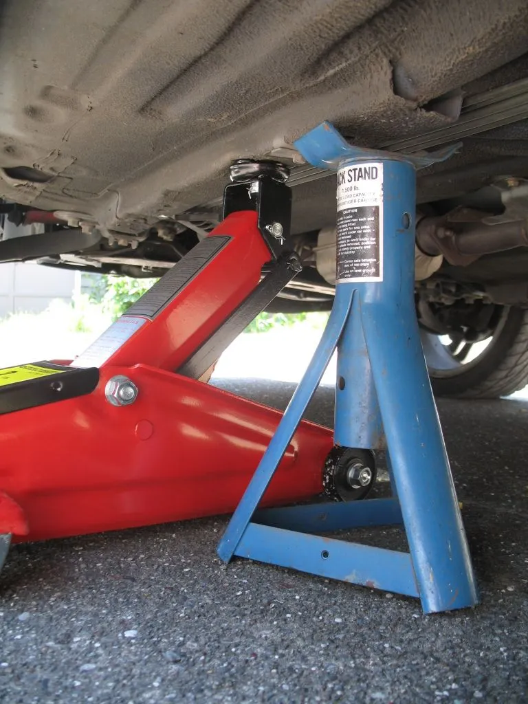

Raise your car with the jack at a point along the frame, raise it high enough to allow a jack stand to rest underneath. See picture IMG_1660.webp

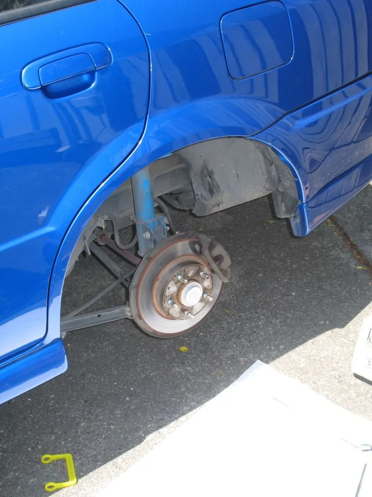

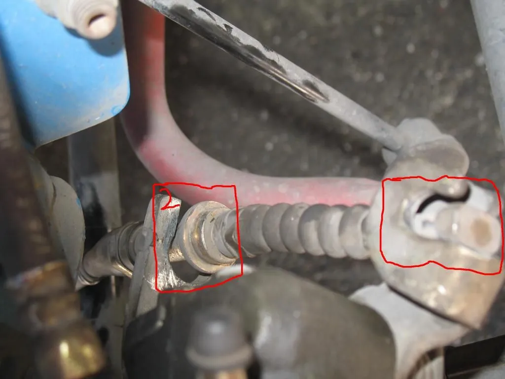

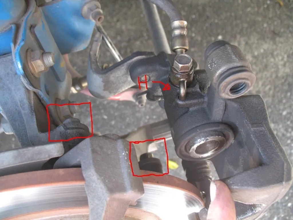

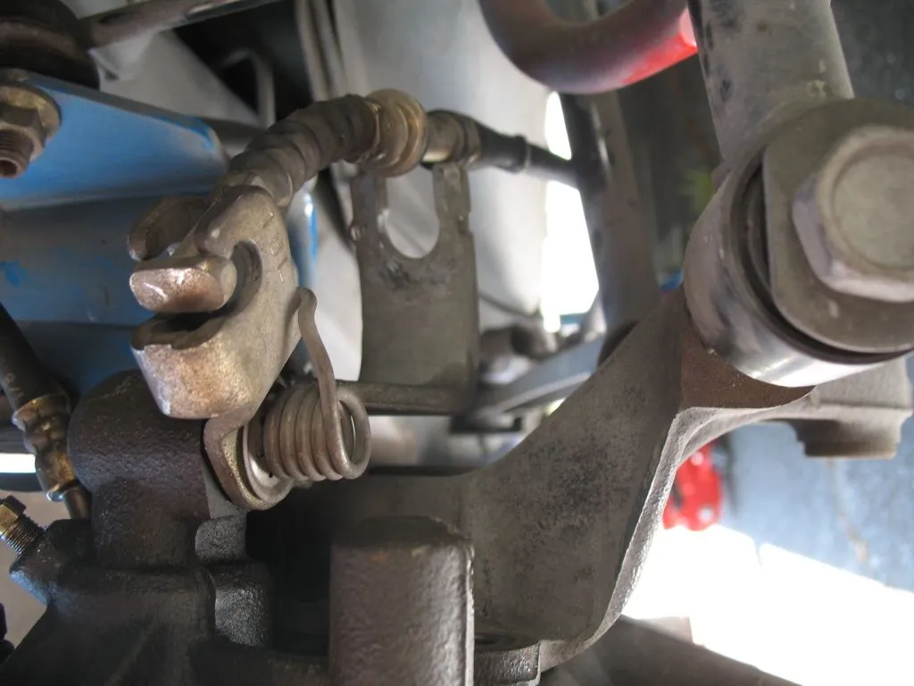

You'll probably need to get down on the ground, get your head into the wheel well and towards the rear of the car. Locate the parking brake line. There will be a clip holding the brake line in place. This can be removed just by applying some reasonable pressure and pushing it towards the center of the vehicle. Once the clip is removed the brake line will easily be removed. I've accentuated the area you need to locate in red. See the attached picture.IMG_1664.webp Afterwards it will look like:IMG_1668.webp

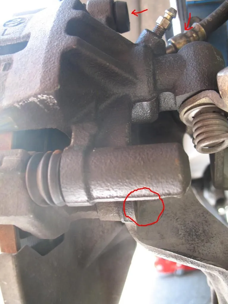

Remove the plastic cover on the top of the caliper. With a 12mm socket, begin undoing the bolt, and then slide the bolt out of the caliper. This will allow the brake pads to be accessed and the caliper to pivot on the floating pin. In this picture, the top arrow, is the bolt that will allow you to pivot the caliper.IMG_1667.webp

Push the caliper away from the discs. You only have two bolts to undo, both call for a 14mm socket. The bottom bolt is pictured in the previous post as the last picture. It can also be seen in this next thumbnail. The top bolt can be accessed from the top of the disc. IMG_1665.webp

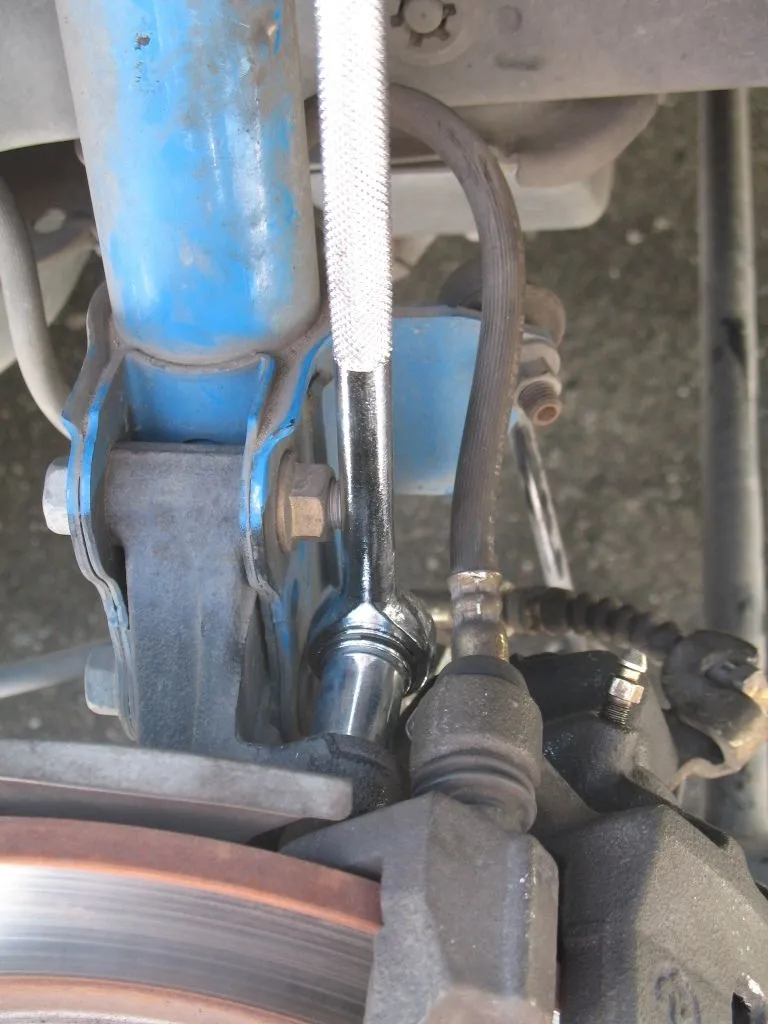

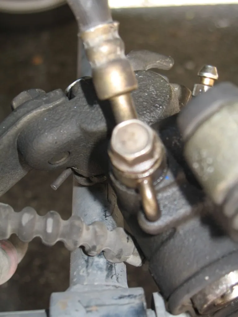

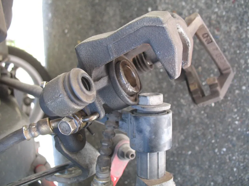

The caliper will only be suspended by the hydraulic brake line, hold the caliper in your hand while you take a 10mm socket to the nut holding in the brake line.IMG_1669.webpIMG_1670.webp
Step 8:
You'll have a lot of brake fluid starting to spill out, try and hold the line as vertical as possible and take a paper towel to the tip to prevent particles from getting into the brake fluid.
