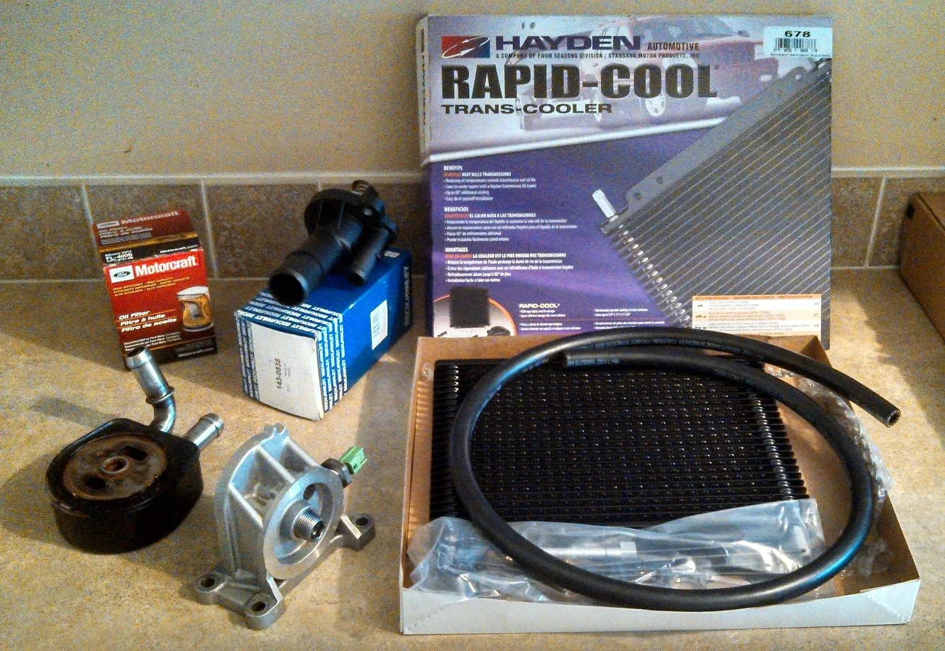

Since I was removing the oil cooler for sanding/painting because it exhibited more rust than I was comfortable with, I also decided to do the spin-on oil filter conversion. And since removing the oil cooler required draining the antifreeze/coolant, I decided to replace the thermostat. Therefore this project kinda snowballed, but here I will focus on the ATF cooler.
First thing you need to do is choose a cooler to satisfy your needs, for me it was the https://www.amazon.com (commissions earned). Since we plan on purchasing a camper of some sort this year, I wanted a larger cooler. This cooler comes with about 4' of 11/32" hose, you will need another 4' from your local auto parts store. I chose to use fuel line hose clamps too, because I don't like worm gear type, about $2.50 from AutoZone.

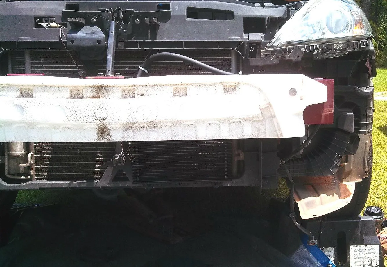

First remove the front bumper cover, I followed this guy's very helpful guide. 10 minutes tops to get it off.

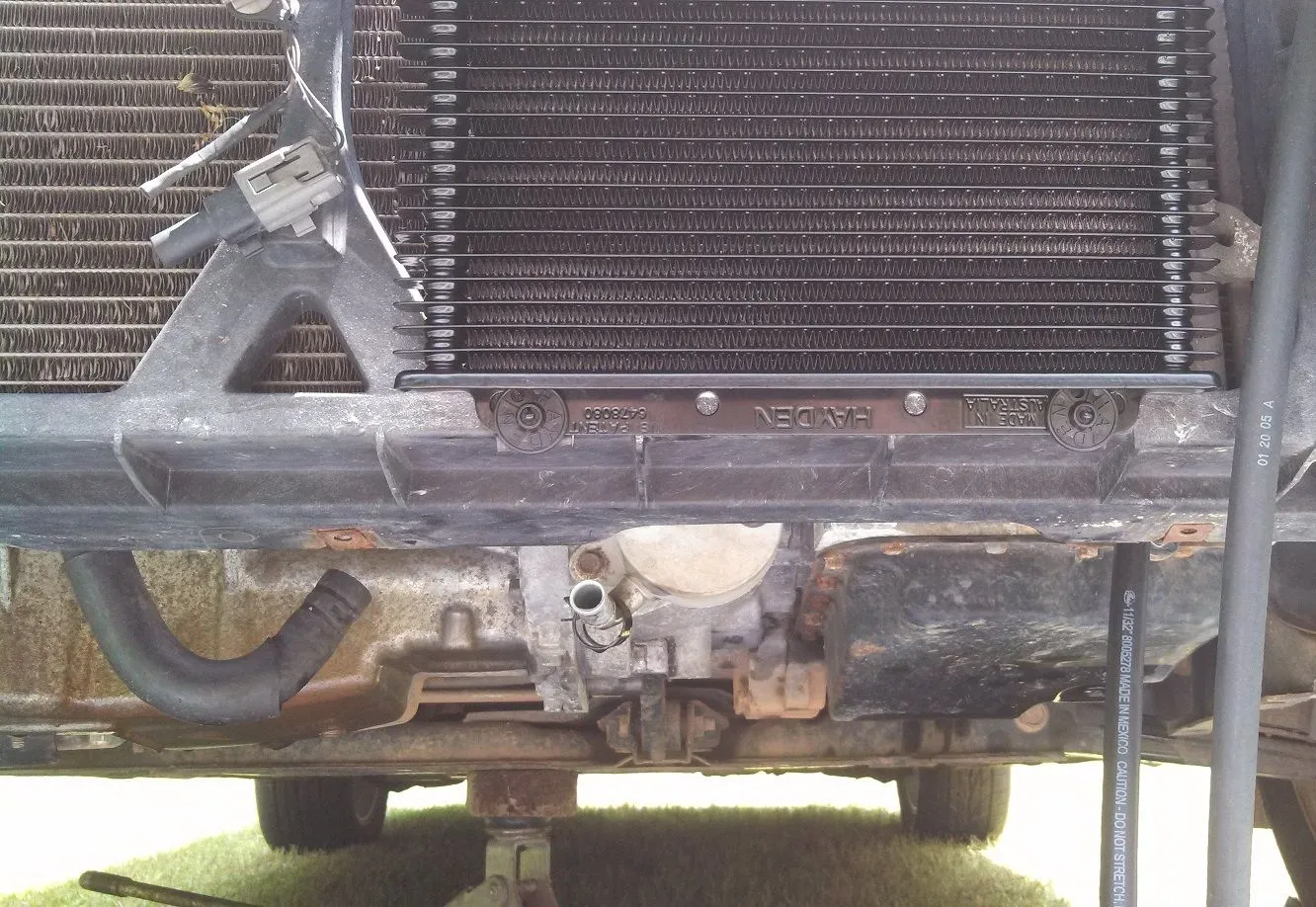

I had also purchased some aluminum bar angle and stainless steel hardware because I anticipated mounting it securely to the radiator core support, but since this structure is fiberglass composite and irregularly shaped, this didn't work. The solution I came up with was to drill 2 small holes (1/8") in the lower support, pop up the radiator and condenser and insert 2 of the zip-ties that come with the cooler through the holes from the back. This supports only the bottom of the cooler, but the hoses zip-tied in place secure the top adequately.

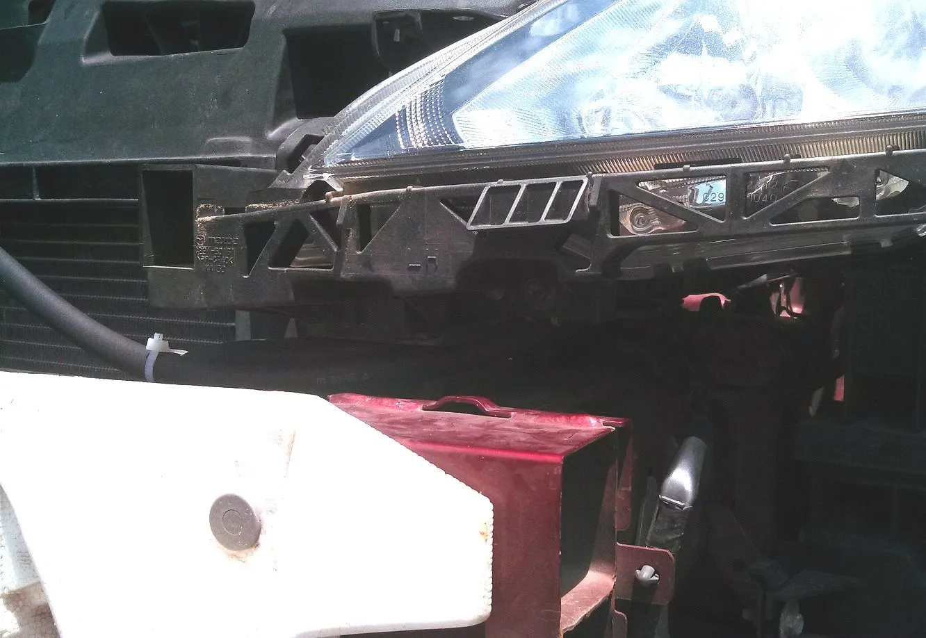

*The best route for the hoses is under the driver's headlight.

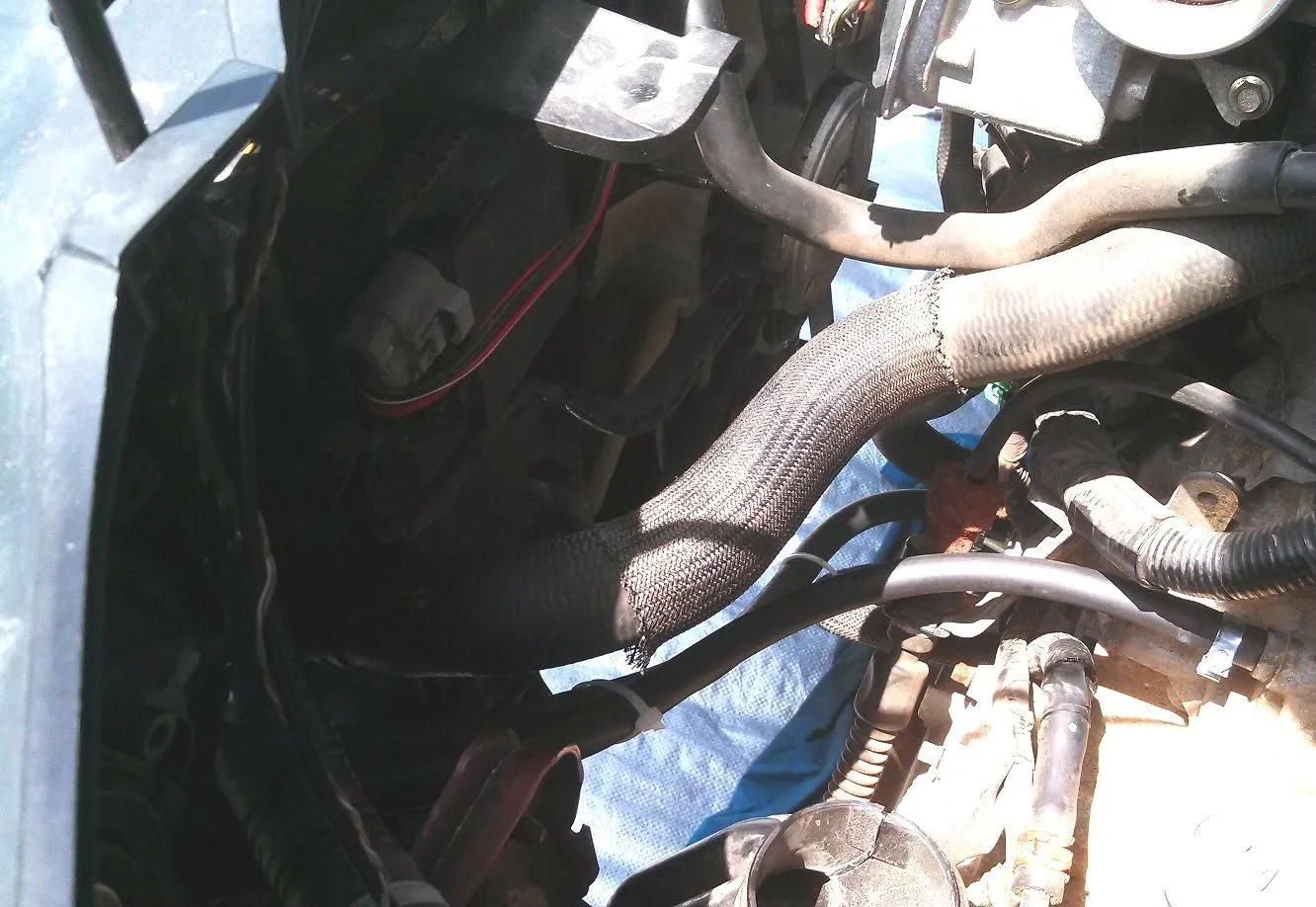

*You also have to remove the airbox to get to the transmission for connecting. My choice was to have the AFT outlet line feed the new cooler first, then to the stock heat exchanger, both in series. This should help to not over-cool the fluid in cold weather.

I hear what you're saying about the brackets because I tried to do this with the aluminum angle and there just wasn't anything for 2 cross bar supports to attach to. For me just drilling two holes in the bottom radiator support for a couple of zip ties was adequate. In this attachment, the 1 zip tie holding the supply hose to the upper Y arm was enough up top.
If you decide to use a shorter cooler, then you could probably have some support brackets below the crash bar, but with the 678 being so tall, I would have had to remove the thing to get holes drilled. And that was NOT going to happen.

I'm sorry I didn't take more pictures. I just had so much to do that day that I didn't even set out to do a "How-To" of this (as you can tell). Hopefully the larger photos will help.
It really was not hard at all once I determined that the aluminum support bar wouldn't work. My other vehicle has just regular zip ties holding it to some existing holes similarly. The push-through type that come with most coolers I would NOT recommend installing as described by the manufacturer if you intend on keeping the vehicle. They tell you to push them through the condenser/radiator and attach the cooler to the front with some foam pads. The foam pads wear out. After a few years my other car's condenser had some nice holes rubbed through on it that took some work to fix, twice. Both of my vehicles now have auxiliary coolers installed in front and independent of the condenser/radiator.
