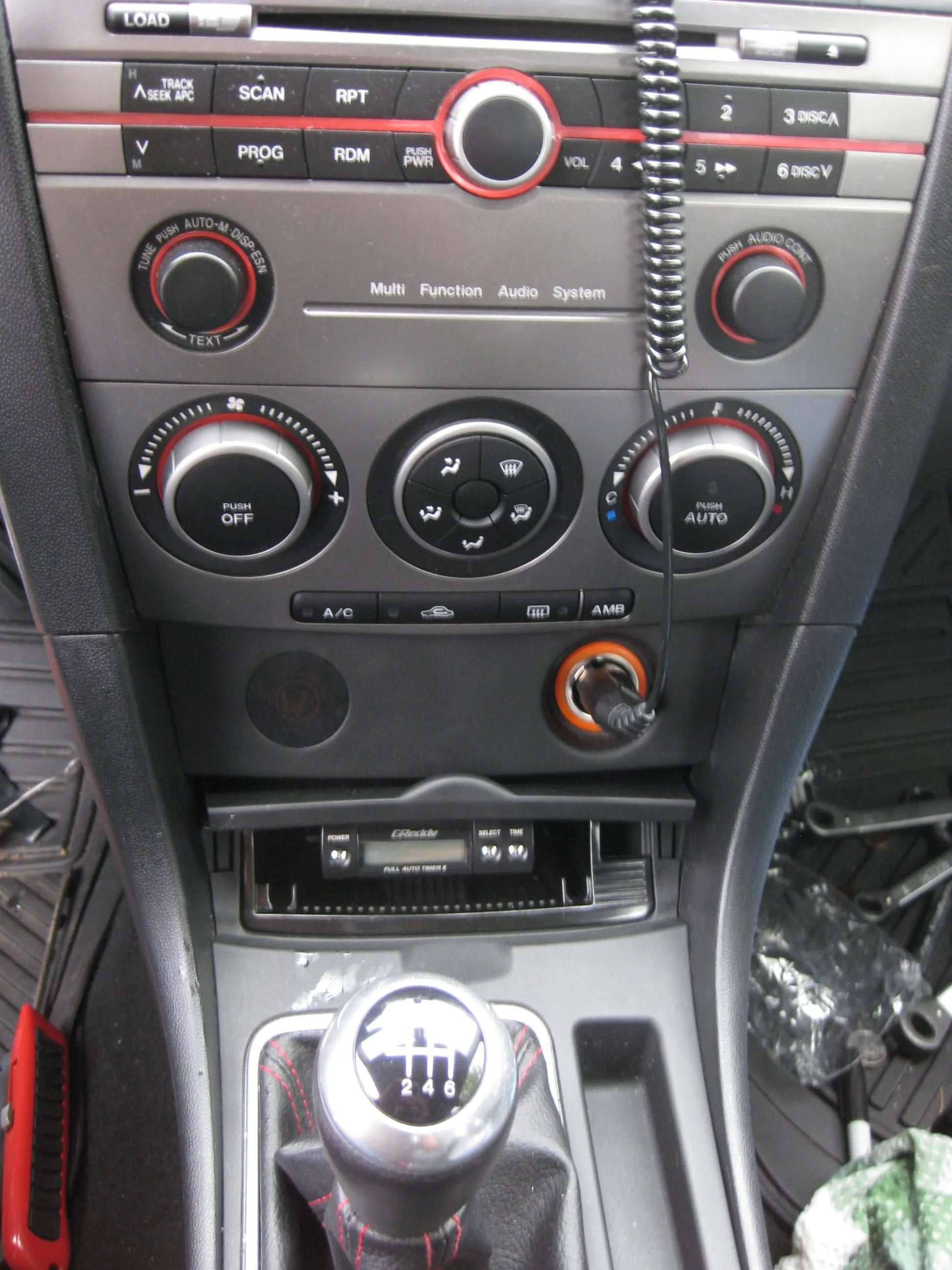

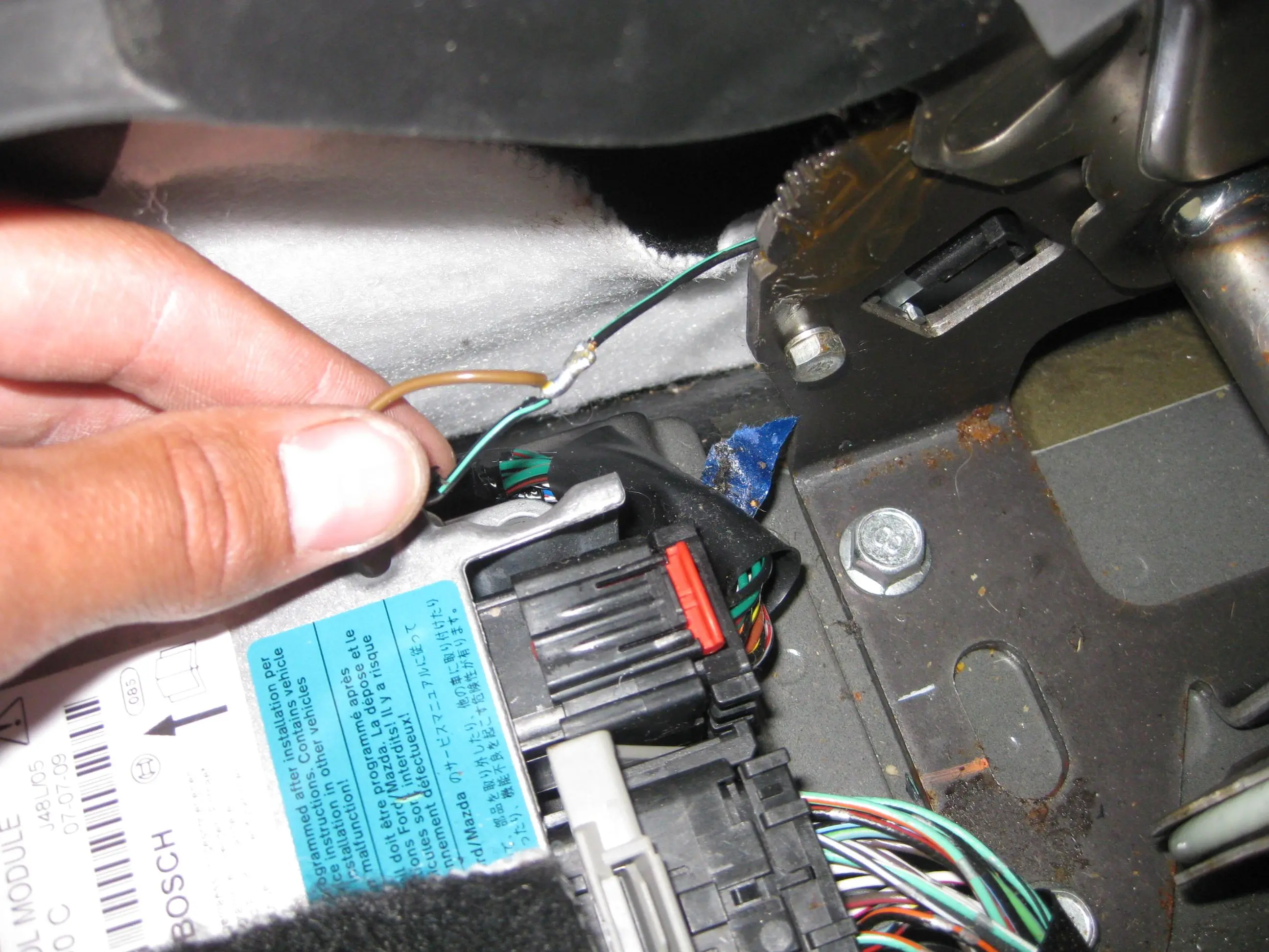

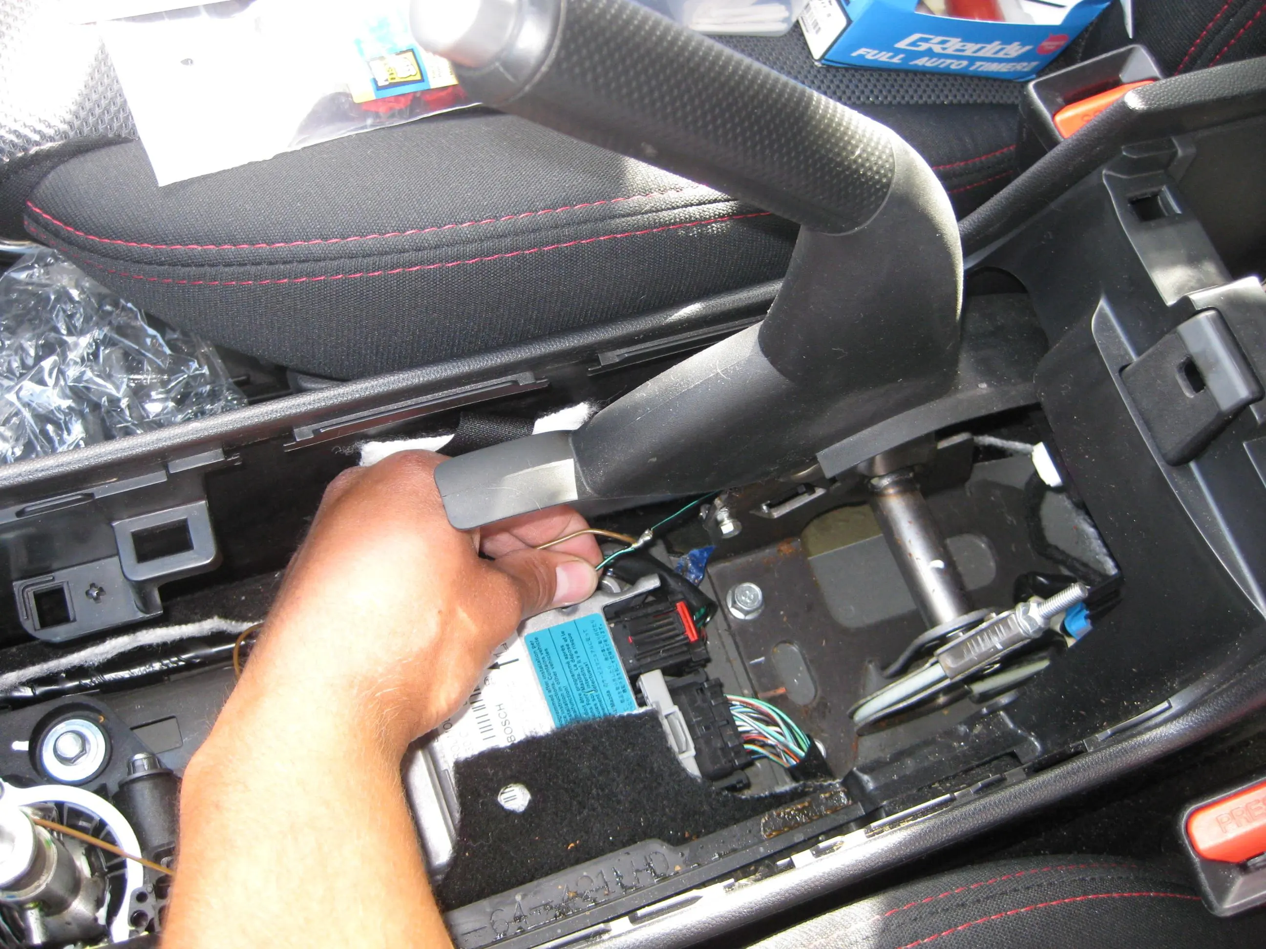

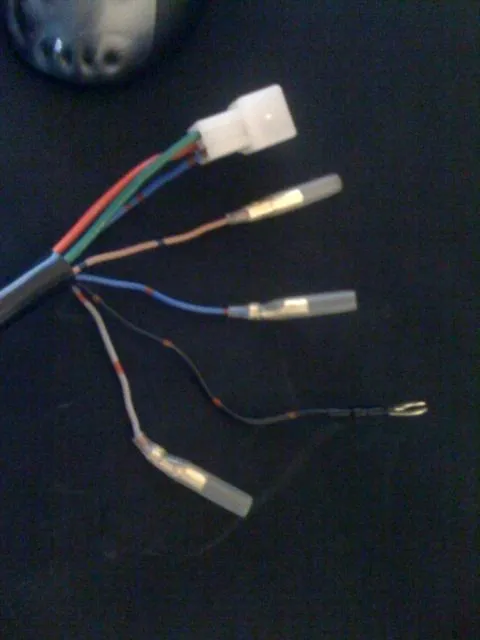

Thanks a lot for the write up I found it very useful. Here are a few pictures I took that I thought some people might appreciate or find useful. (Hopefully they upload properly I am new to using forums)
I think they uploaded just wondering if anyone can tell me how to make the pictures appear within your text like in the write up
