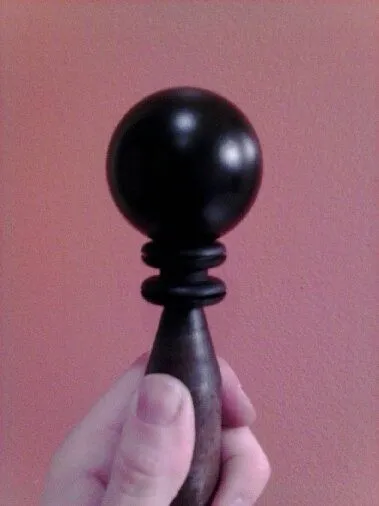

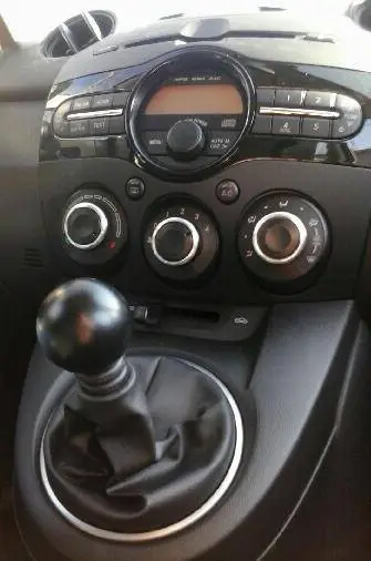

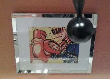

STEP ONE: Soak rusty Miata shifter in mineral spirits. Scrub away rust with steel wool. Do not drink mineral spirits.

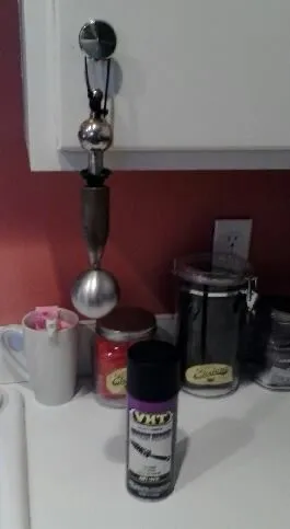

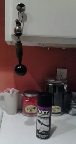

STEP TWO: Fabricate Rube Goldberg zip tie mechanism to hang shifter from kitchen hardware. Attach 1 lb steel ball (countersunk and threaded to fit Mazda2) to the Miata shifter.
STEP THREE: Using Miata shifter as handle, prep steel ball and coat with VHT satin black epoxy paint. Six light coats work well. If possible, do not paint the shift knob in the kitchen. http://www.vhtpaint.com/products/epoxypaint/
STEP FOUR: Use robot to punch shift knob until it has fully dried.

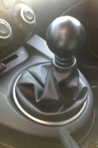

STEP FIVE: Add high pressure fuel hose and rubber grommets as an inexpensive way to cover exposed metal of shift rod.

Miata knobs do fit the 2. Same thread pitch.
Any reason you put the rubber grommets on the top of the boot? I would just put washers under the boot, so it came up and matched the shift knob.
A Miata shifter does NOT fit a Mazda2, but the thread pitch IS the same (as mentioned by zps2004.) I had a couple of spare Miata shifters in the garage, so I used one as a convenient way of carrying around the shift knob when it was wet. As far as the rubber grommets go, I chose them because they are pleasantly rubber-ish to touch and I thought they looked cool in an 80s shifter sort of way.
Thanks for the compliment, inspekt!
Buy a 2" diameter steel ball from an industrial supply shop on the internet.
Give steel ball and measurements to friend with lots of fancy equipment in his shop.
Witchcraft happens, and the steel ball is now threaded for your Mazda2.
