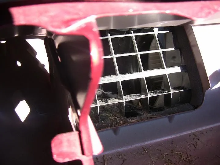

I had some issue yesterday with the blower vibrating badly. The culprit seems to have been a small rodent nesting in the blower housing. Sorry I didn't take pictures of removing the cowl, I was just curious if I could do anything to it without ripping out the dash. The answer - YES you can! The cowl comes off by removing the wipers, 4 plastic screws/plugs and 4 (I think) push plugs that hold the weatherstripping to the car (passenger side only). Here's some pictures of what I did...

What I couldn't fish out with a coat hanger bent with a hook on the end, I did the following with a short section of spare waterhose...

Haha. It wasn't home. I'm thinking that it made a run for it once it's nest started getting sucked away, piece by piece. If this happens again, I'll be installing some screening over the grid opening. I started to, but I was running out of daylight and I still had to wash the thing.
thanks for the tip, wife's 5 is making a noise when the fan is turned up past 3/4, so maybe we have uninvited guests as well.
I don't recall a sponge filter, just the grid you see from above.
There are drain holes over the struts that I assume are simply for water, but they are definitely large enough for a rodent to enter. Therefore, this wasn't debris collecting over time from washing down through the cowl, something carried this stuff in there.
Edit: actually you can see the hole on the left side of this picture, and I don't think this was the only one. I suspect a mouse.
