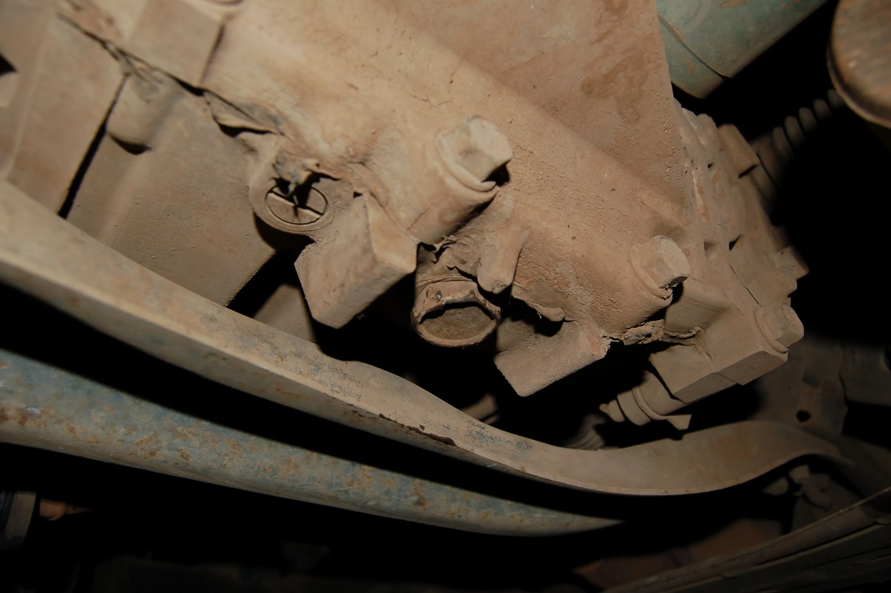

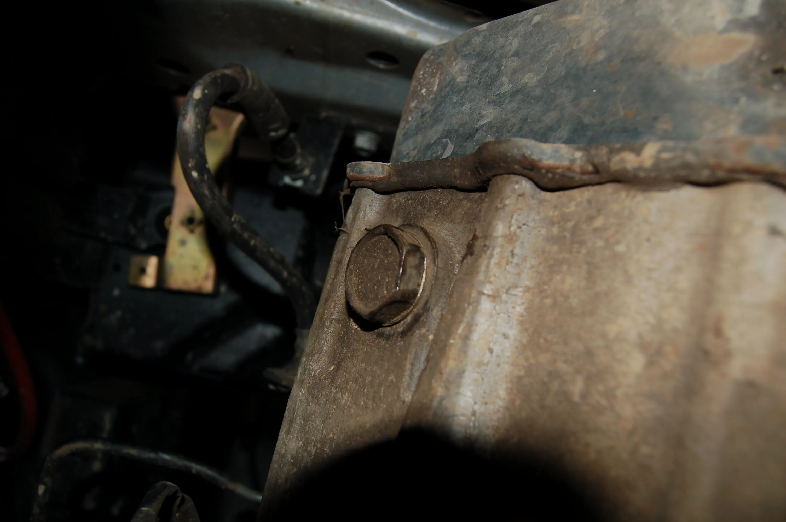

I have a manual transmission. I'm going to replace the fluid myself with GM/Pennzoil Synchromesh (if I can find it around here...ha). I had a few questions. First. I have not done this yet, but I saw on protege5.ugly.net that there are washers under the bolts I need to replace when I do a change?...Is that necessary, and if so, where do I get them? Is it just a generic, universal part? Secondly, I was wondering if I'm looking at the correct the drain and fill plugs. That is why I've included the pictures. haha If so, what size are they? Thanks :)

those look like the right plugs. usually you change the gaskets on the plugs as a precaution, but most people get away with reusing it.
