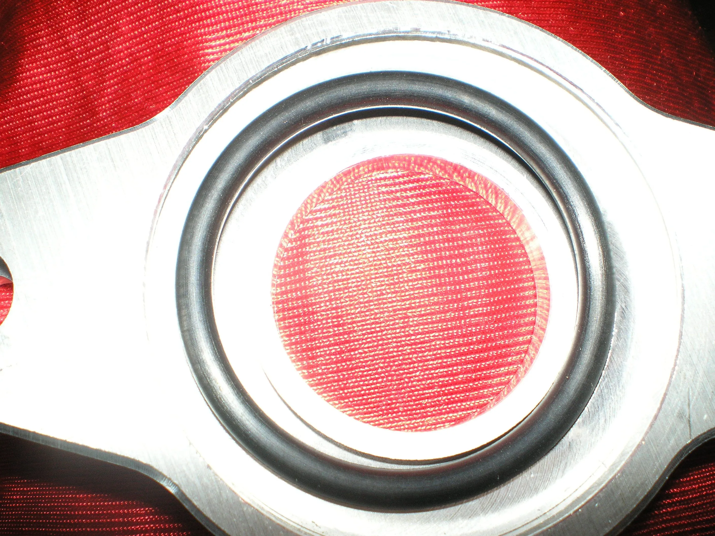

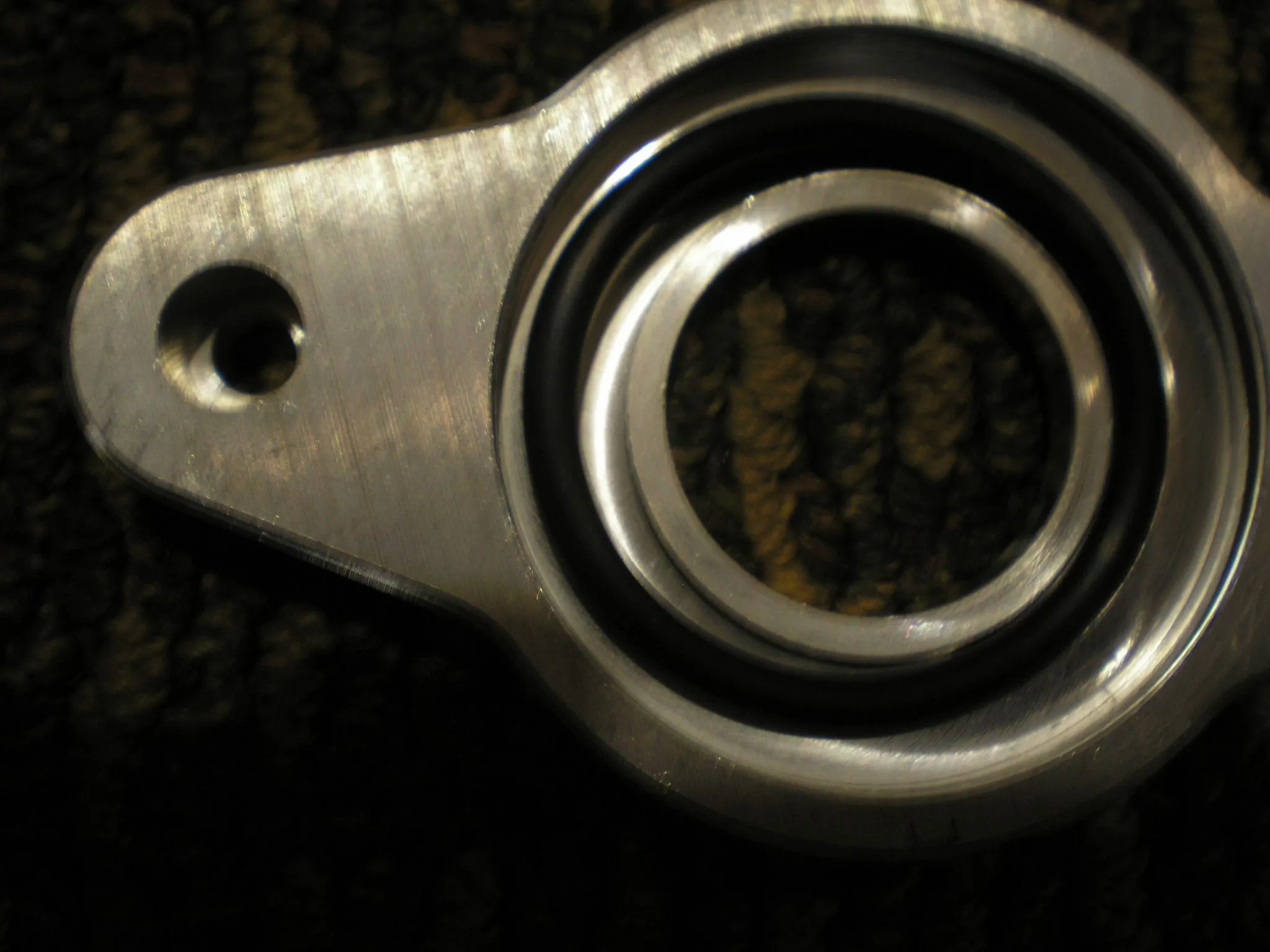

thx for all you guys's help and i mean it! i havn't have enough time to really work on it yet but i am stuck already. lol in the picture below, is the black ring suppose to go into that little circle in the flange? i tried but the black ring is too big... is there a special way to put it in there or it's not even suppose to go in there? god never thought a bov would gimme so much trouble!!! (rant)

you need a 90*/45* snap ring plier to compress the ring and slide it in.
