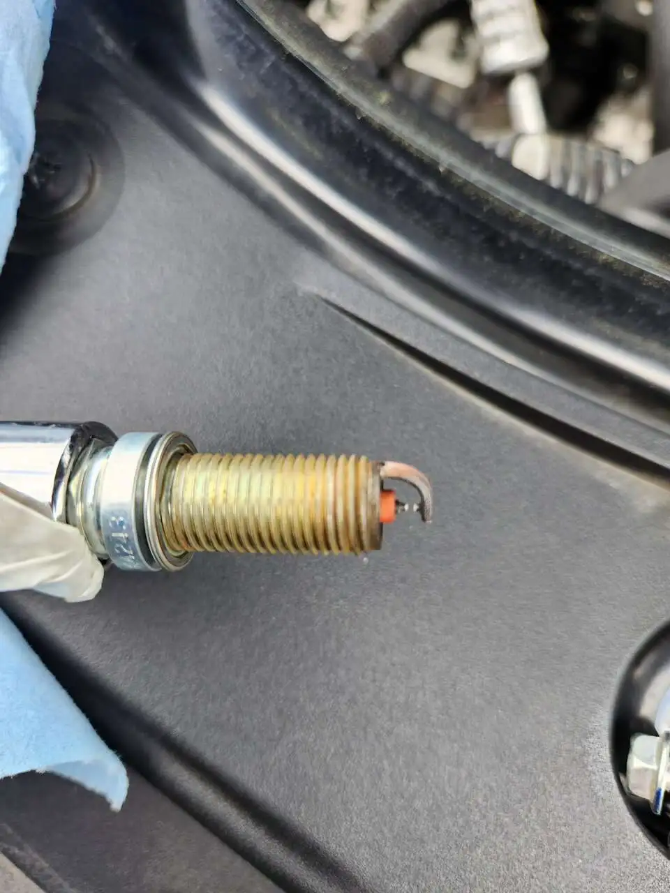

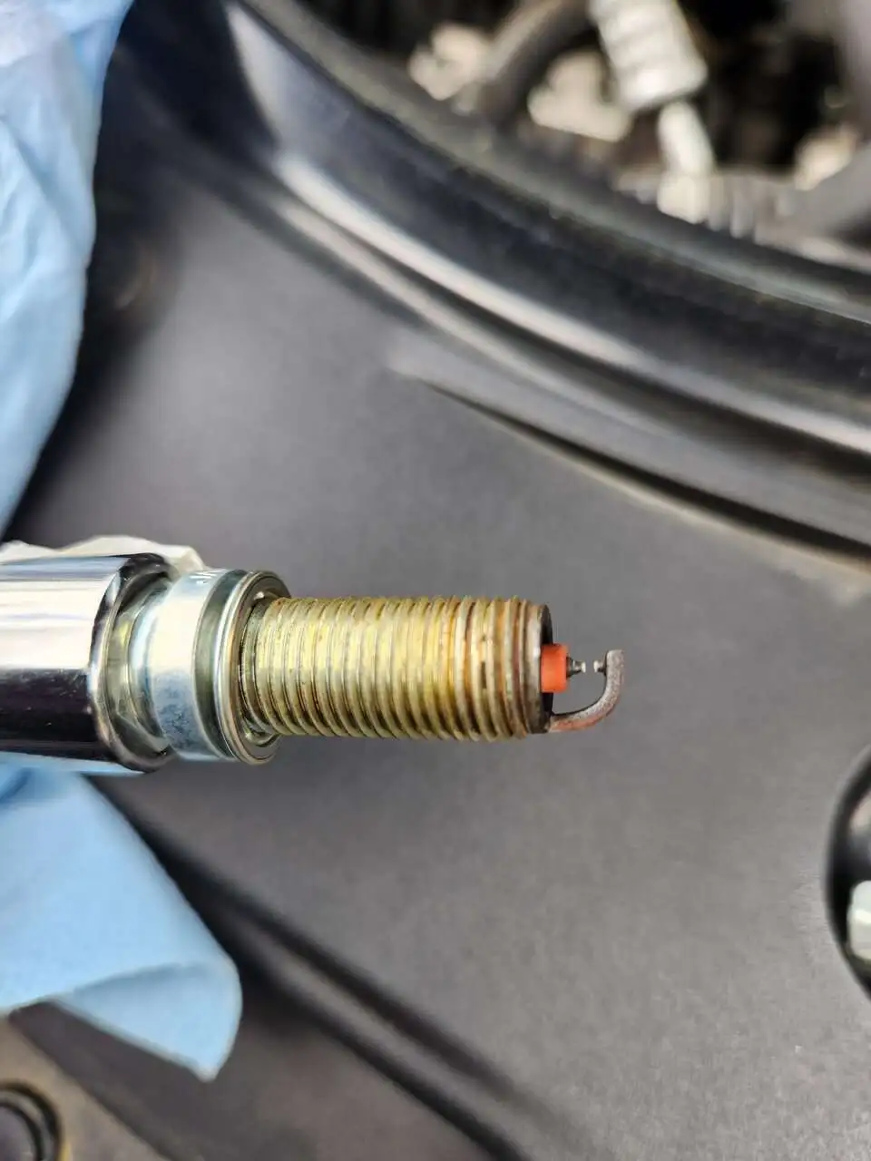

I was curious how the spark plugs looked on my 2020 CX-9 GT with a little under 24K miles because the engine seemed to have a bit of a vibration along with a couple misfires in a couple cylinders according to my topscan scanner. So, I pulled them to get a look see. Took me 20 minutes total to remove all and put back after inspection.
What do you think? Was thinking about replacing them anyway because that's just how I am lol.
Opinions?

Those two look perfectly normal for the mileage. Gap is nice and consistent and no signs of any carbon or oil etc... accumulating on them. If there are misfires perhaps it's fuel related. Run a good injector cleaner and use a few tanks of top tier fuel and see how it goes.
