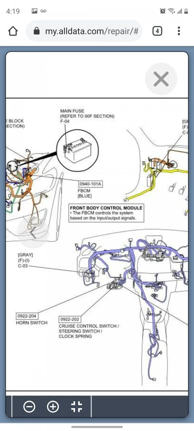

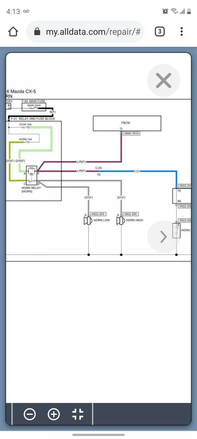

Oops I didn't read the diagram clearly. if the horn works with remote then the problem does not lie with the relay or the fuse.
Since bcm can command the horn to turn on, in your situation the horn was turned on by vehicle locking.
Maybe the problem lies with the steering wheel side (horn switch) let me see if i can find another diagram...

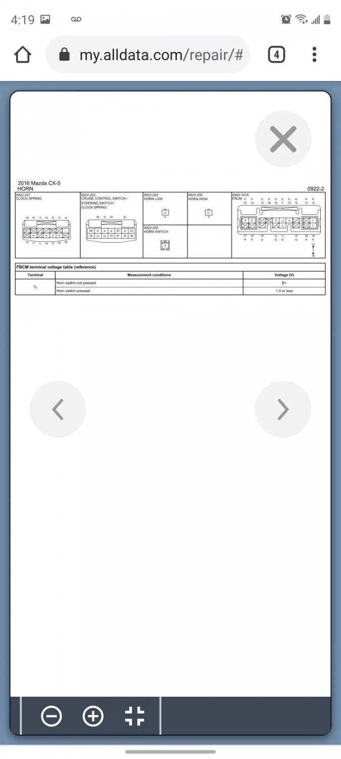

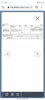

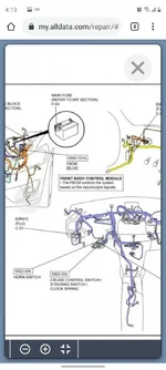

That's pretty helpful, base on that I would say you gotta take a quick look at the wiring/connectors.
Quick test will be able to tell you if the horn switch is working and from that point on it is just chasing what's shorted or disconnected.
