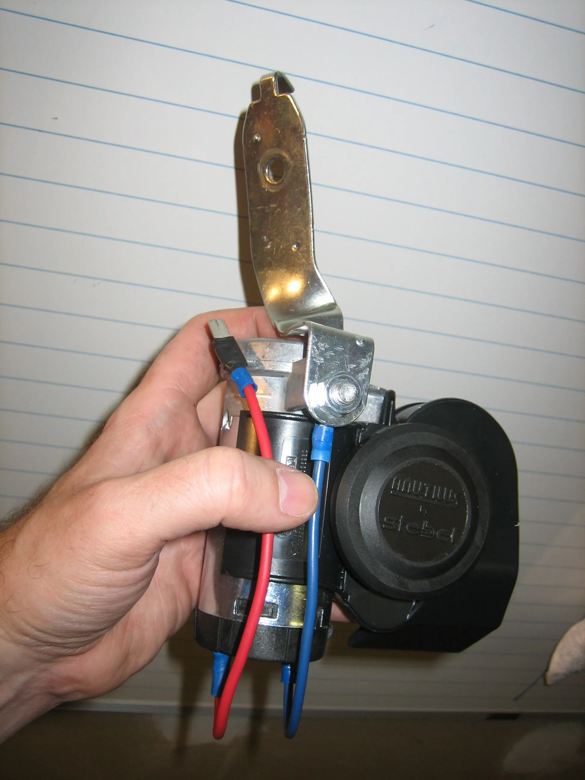

I installed the Stebel Nautilus last night, took about two hours at my pace. I had to drill out the stock bracket hole and bend it, but the bracket is really soft and it was easy. I love the sound now, no more anemic goose!
The sound is worth it, isn't it ! I used a smaller 10mm bolt and nut on the horn to avoid the bracket hole enlargement problem. I guarantee if you hit the horn button at a pedestrian crosswalk, some people will be ready to string you up for making them jump from fright.

I did not use the relay, if that is what you mean. I just added six inches to the stock harness, made a jumper for the ground, and twisted and re-bent the bracket. I can stand on the horn and the specified 18Amp draw will not blow the 15Amp fuse.
See pic for bracket mod. This points the outlet toward the grill.
-enganear
