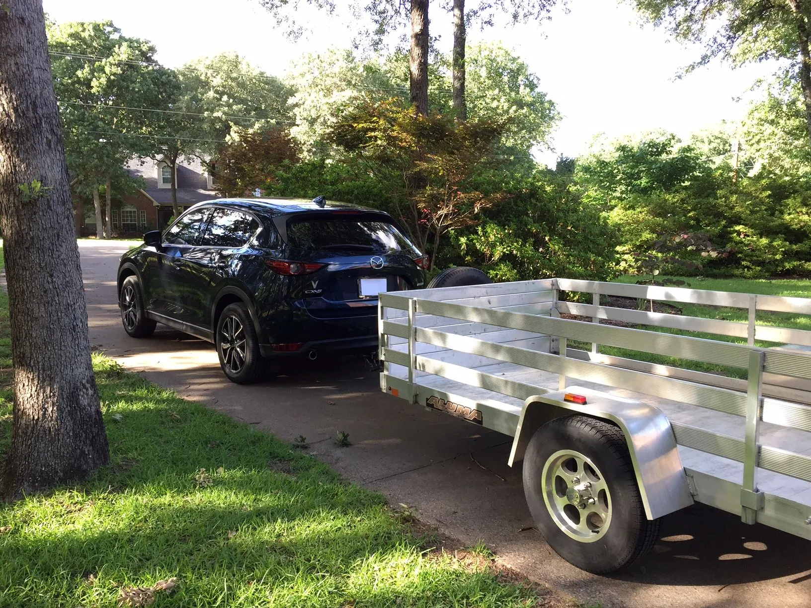

In other parts of the world, the CX5 is rated to tow 4400 lbs braked. But I can understand how they would want to cover their ass by listing trailer brakes as required equipment when towing over 1000 lbs in the US because I see how people drive here everyday. I tow 2000 lbs often and far (trailer and cargo) and 3000 lbs rarely (like a pallet of concrete from Lowes 10 miles or so) and have never felt uncomfortable, but I keep the speed and distances reasonable. But after reading your post I may look into adding some brakes and see how I like it. The trailer is only 475 lbs and so it has always seemed ridiculous to add brakes. Honestly, when I'm towing 1500 lbs or less, it's easy to forget it's back there.
