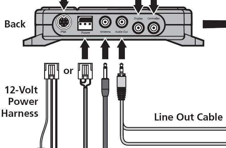

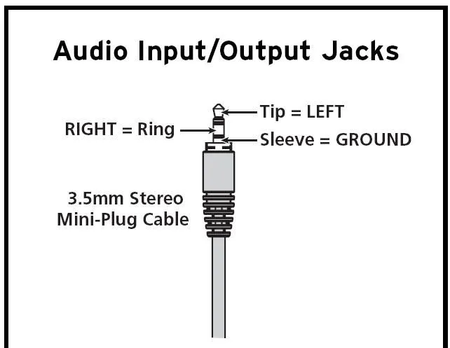

Harman Kardon Wiring Diagram for Audio Out
Attached are a couple pictures of the HK wiring diagram.
It seems that the Audio Out from HK can be directly connected to Aux-In on the CX-9 center console with a simple stereo cable, right?

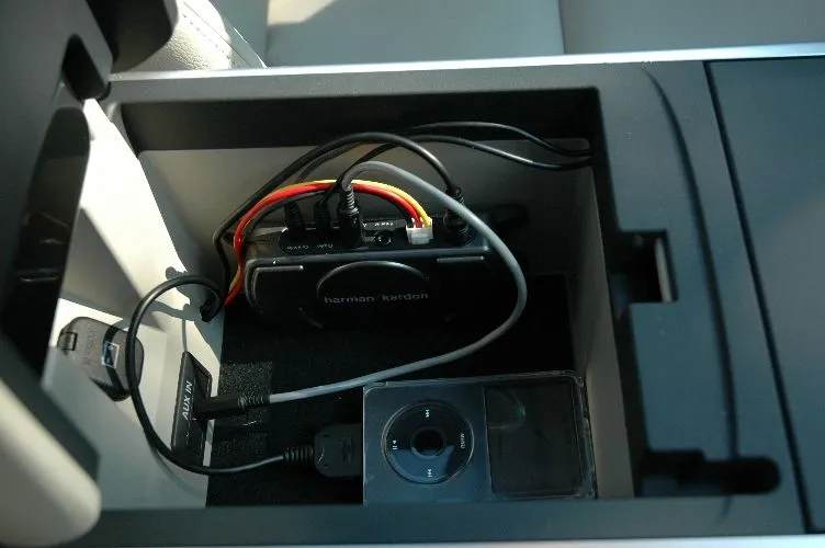

Yes, I have this exact setup!
If you go directly from the HK output to the Aux-In, you will get the ground loop hum. I got the Crutchfield ground loop isolator (1/8" jack to 1/8" plug) that connects from the HK output to the Aux-In. One problem. There seems to be an impedence mismatch, so you lose a lot of bass. I think the H/K output is a line level output and the GLI is meant for a headphone level output. So my solution was to use the H/K for controlling the iPod, but connect the GLI from the iPod to the Aux-In. (HK Drive+Play --> iPod --> GLI --> Aux-In --> Head-Unit)
Works great and sounds amazing!!!
Some time, I may get ambitious and try a line level GLI and all the required adapter cables to see if I could connect the H/K output to the Aux-In with the same audio quality. So far, I haven't bothered.

Thanks for the pics. Does the drive and play require its own power? If so, how did you power it?
It requires both switched and unswitched power. The power socket in the dash is switched and the one in the console is unswitched.

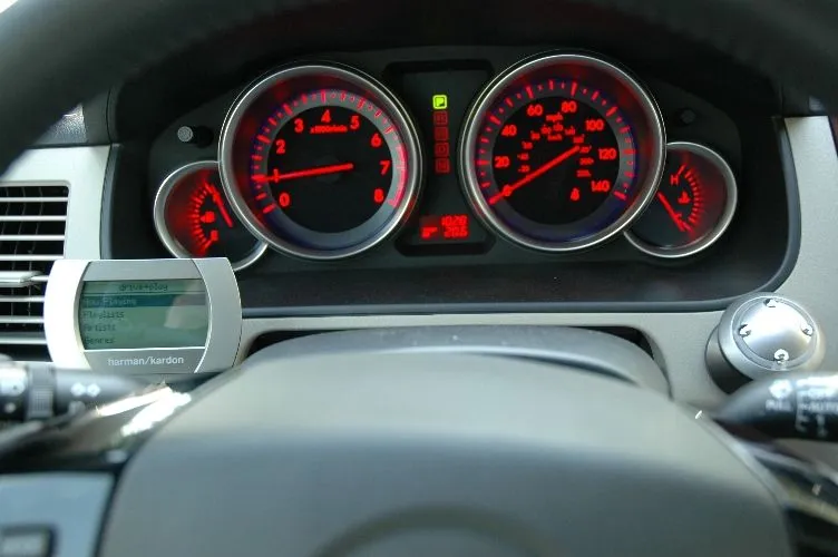

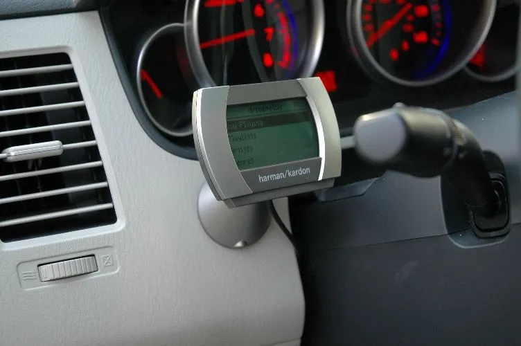

DashingMax, l-miwa, and other HK Drive + Play users:
Can any of you tell me what the dimensions are of the D+P display unit? Both in terms of screen size and for the overall unit?
I don't have a CX-9, but you can see what I'm trying to accomplish in my post here.
Thanks!
Thanks, l-miwa -- looks like the display is a bit too large to fit where I had hoped I could put it. Too bad.
