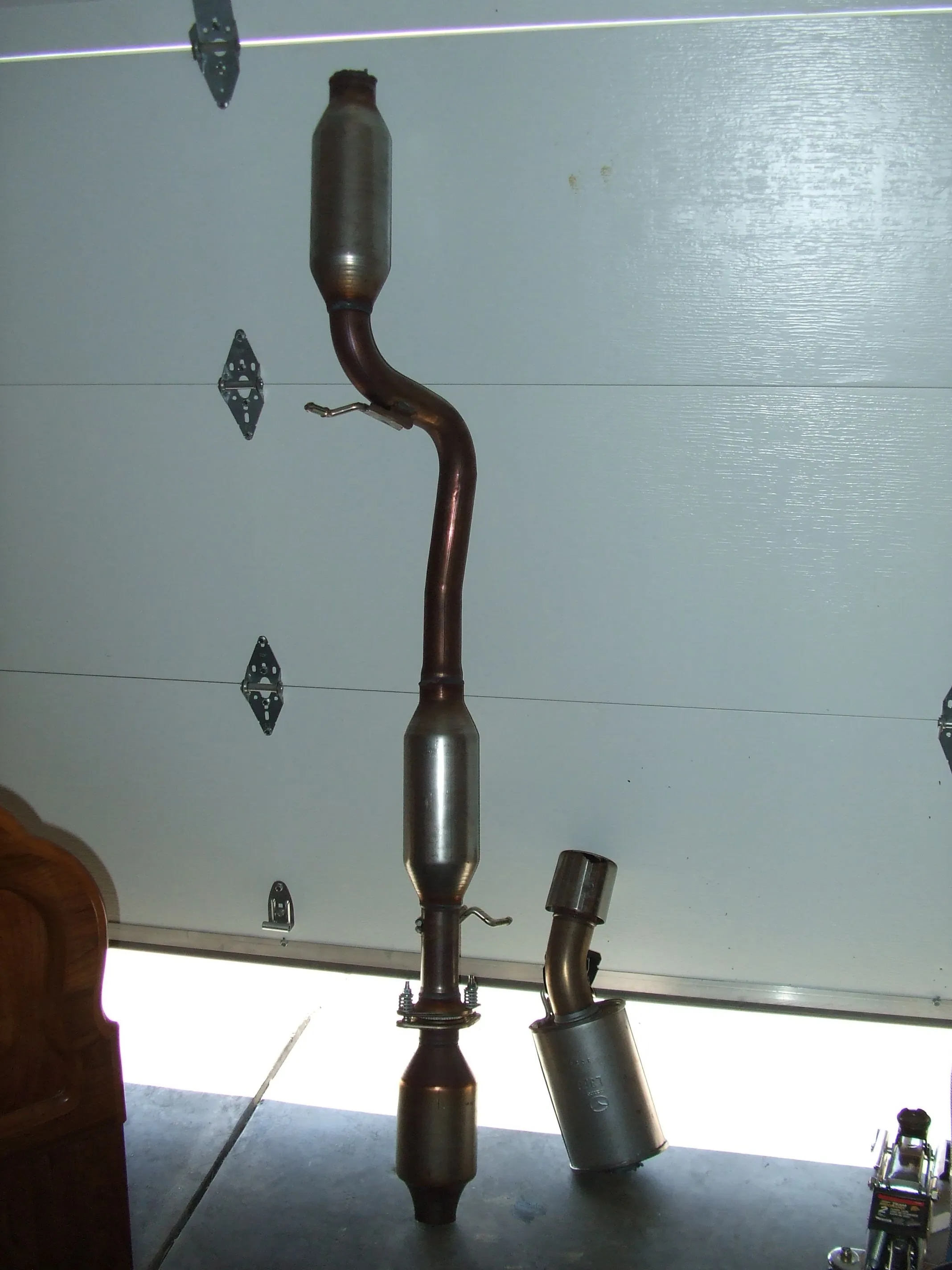

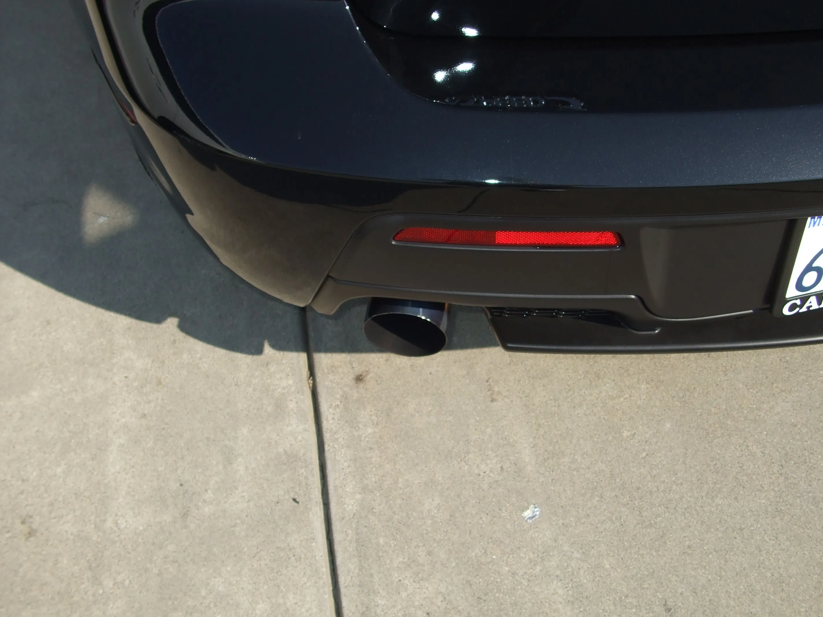

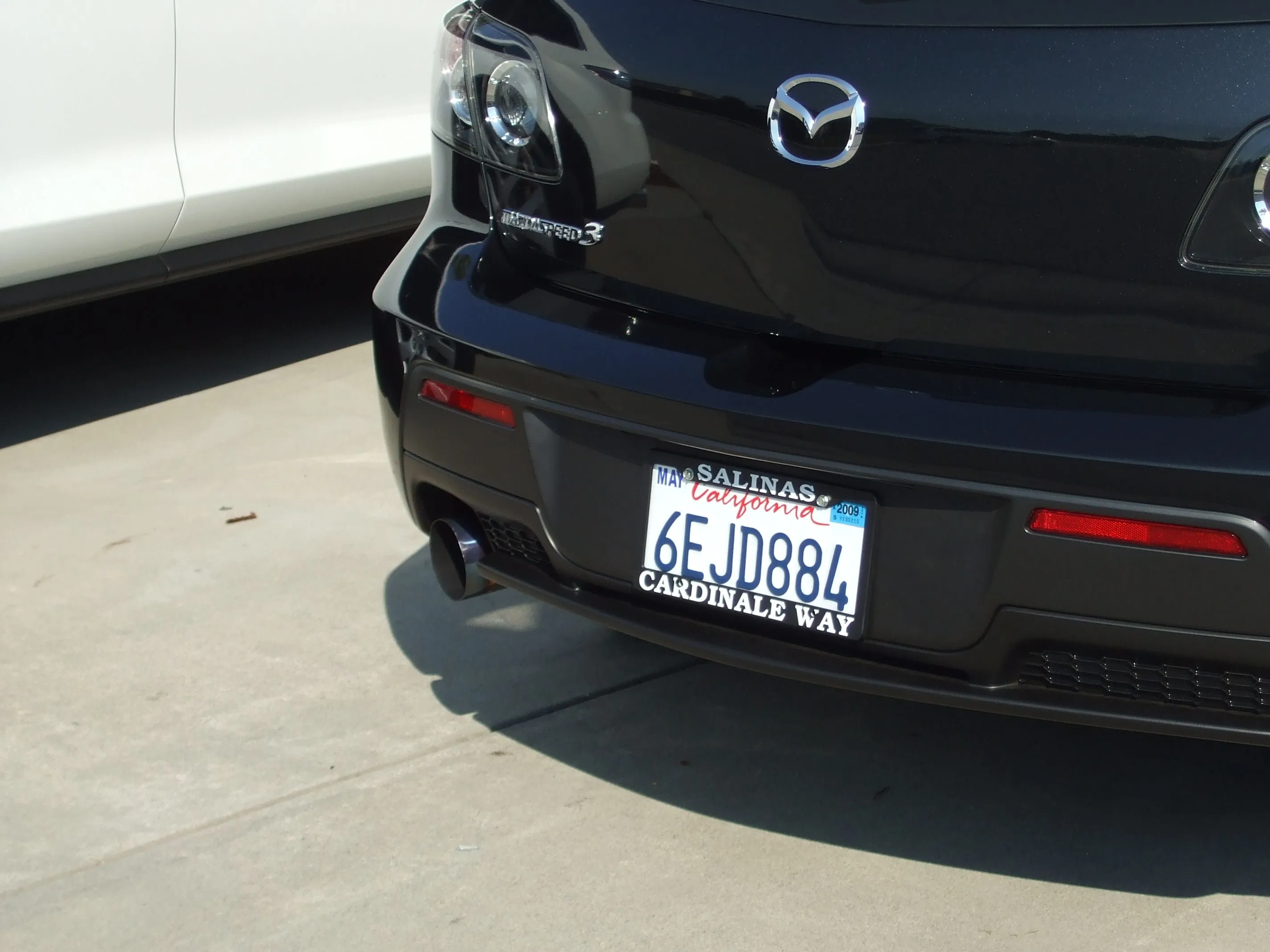

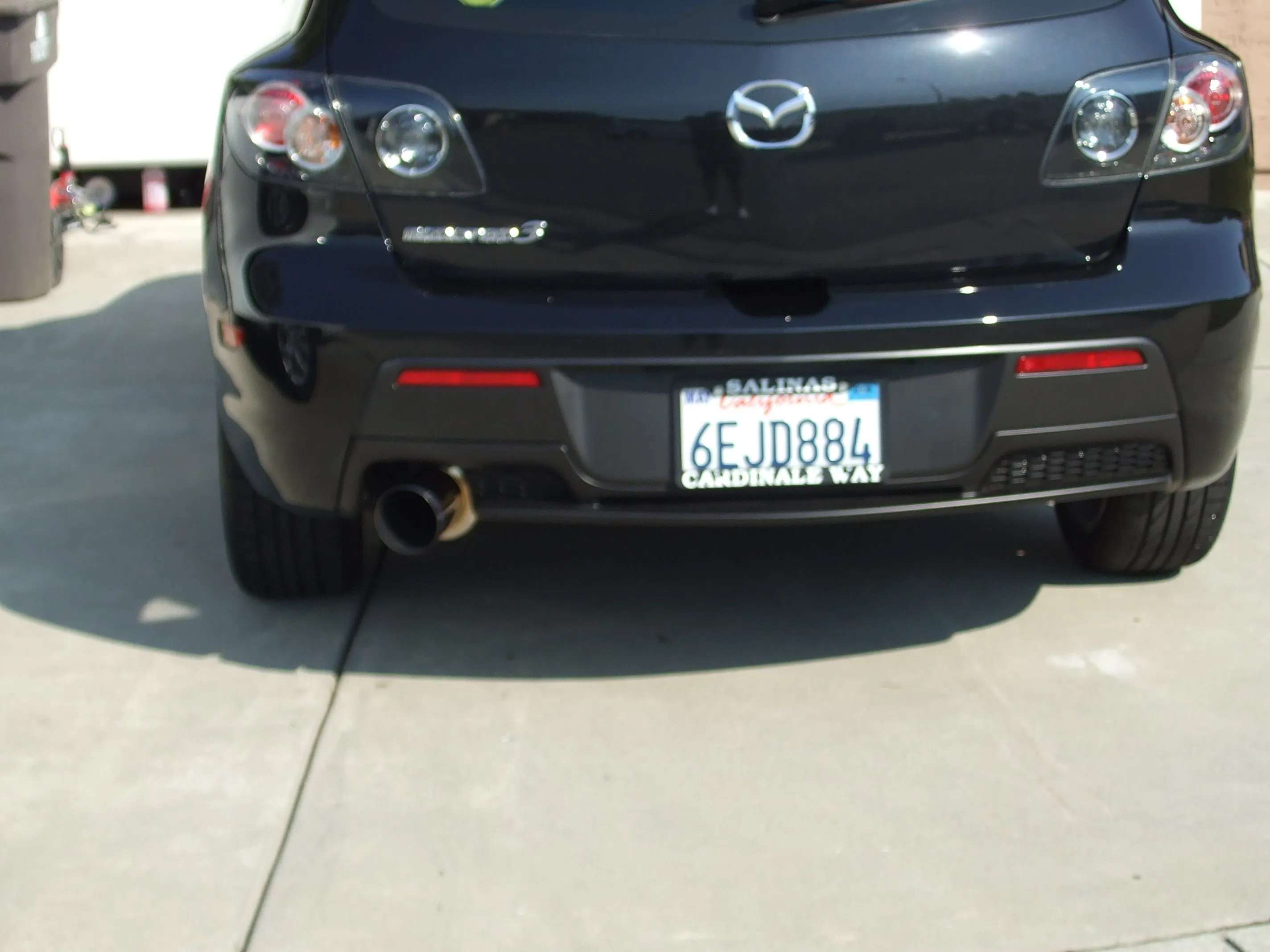

i had every thing removed except for the first cat, so it just free flow to the exhaust muffler that i had put on. my question is he used the stock size pipe and did crush bends is that really going to effect my power

Does he not have a mandrel bender? To get the most out of the exhaust, you want the fewest bends and lowest degree of bends as possible. And you want them mandrel'd.

I have the 2 resonators and muffler removed. You mentioned you put an aftermarket muffler on the end right? any pics at all? I have not received my testpipe in the mail yet but with the 3 things rmeoved its already pretty grumbly... sounds very loud on first startup and drive in the morning when the car is cold.

You should of told the shop to just weld in a straight pipe where the resonators and muffler was instead of replacing the whole thing.That is what I did so I could keep the stock mandrel bends in place.If you have bends in the pipe that are around 90 degrees its going to effect your flow because using crush bends on corners makes a 2.5" pipe less then 2" in the bends..
