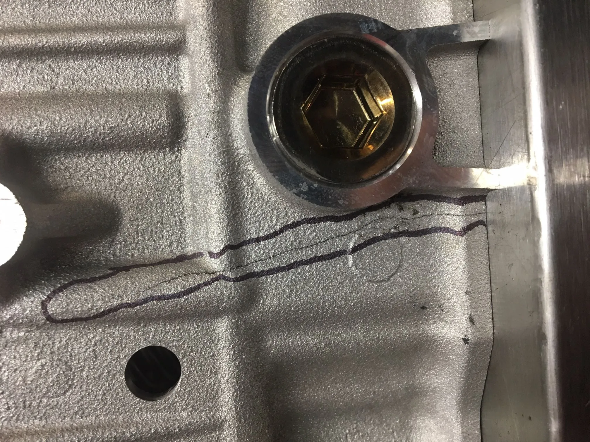

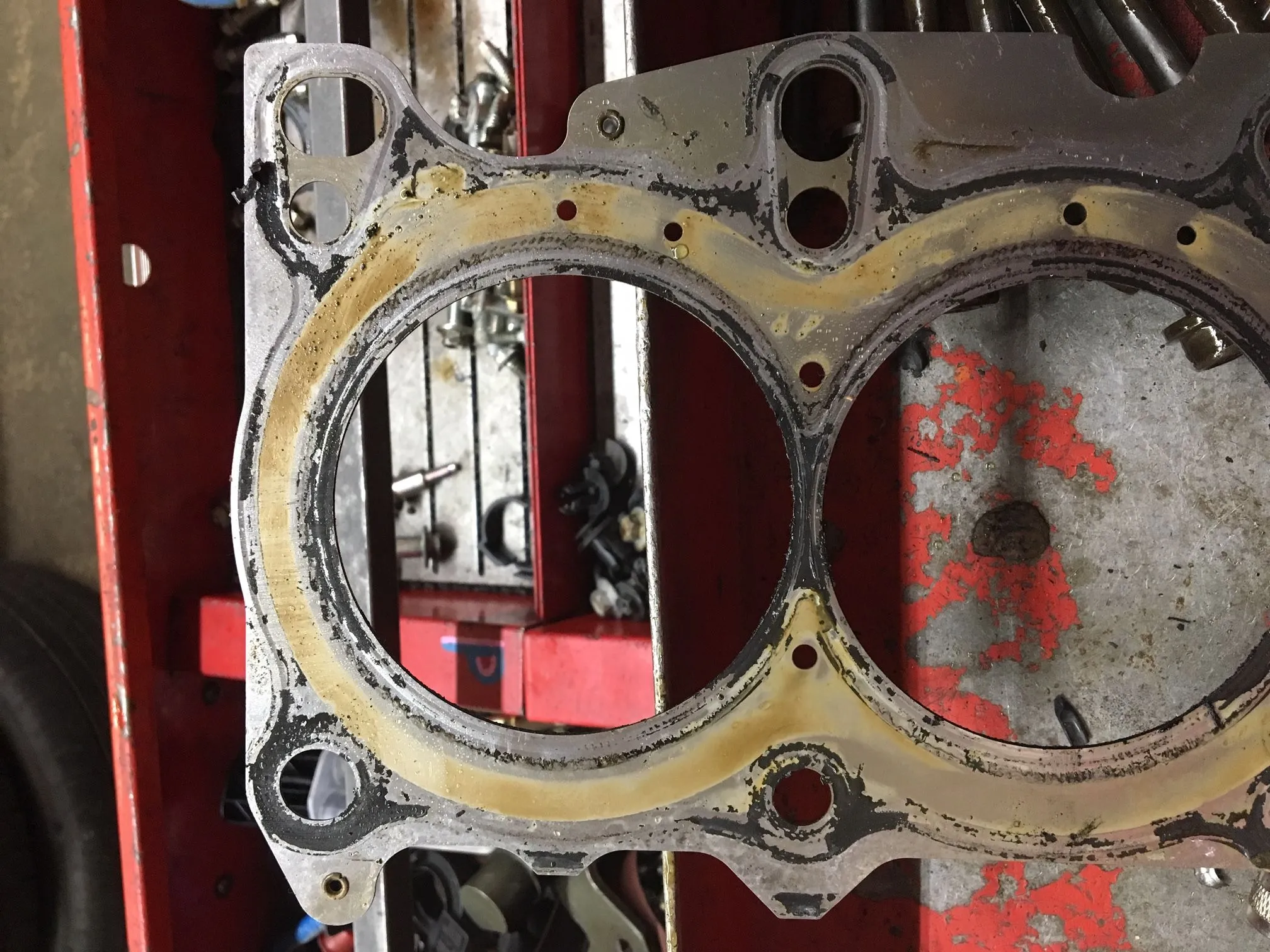

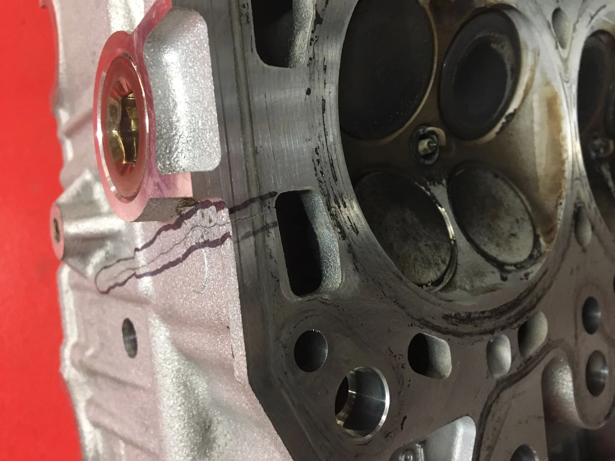

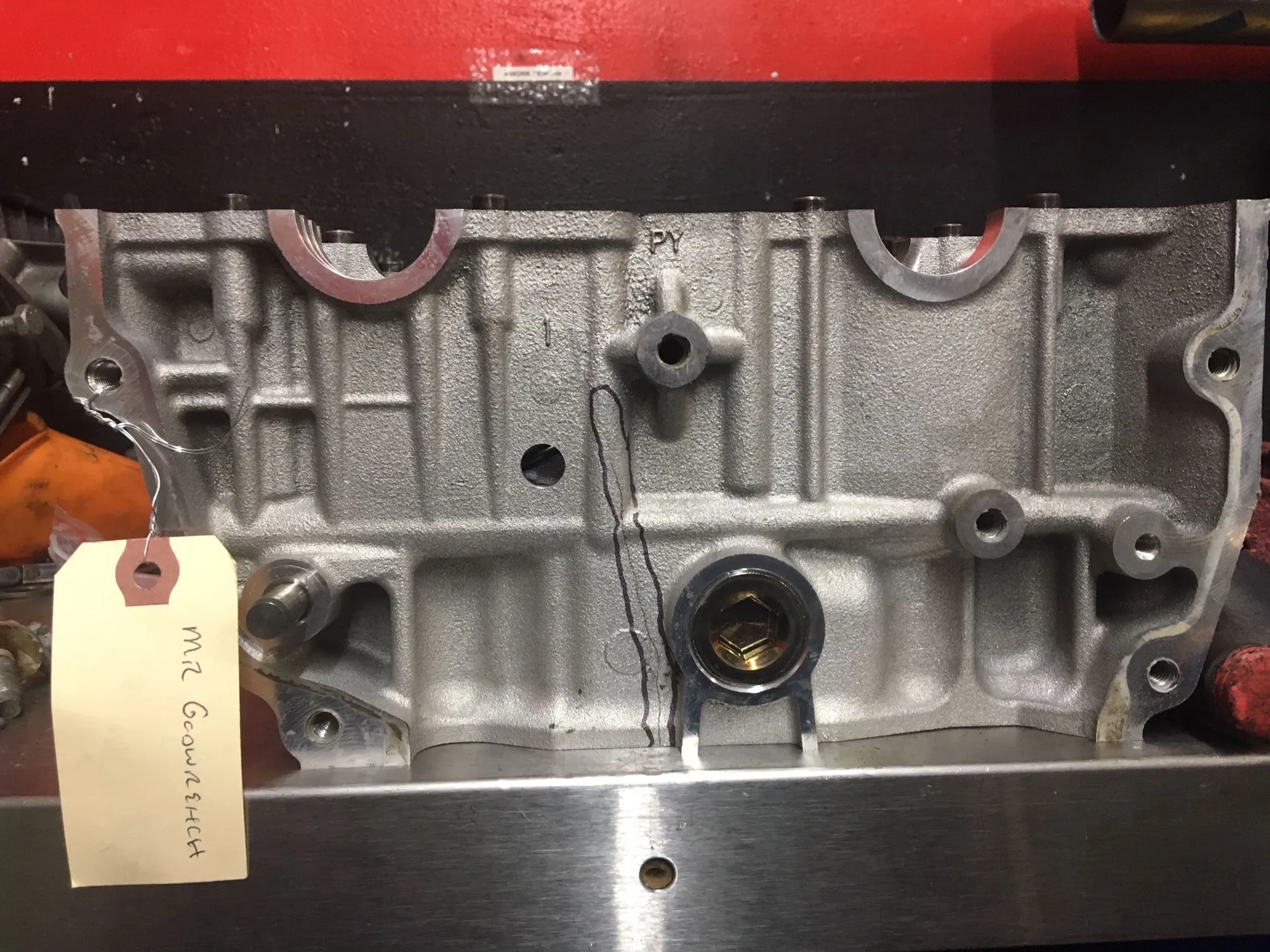

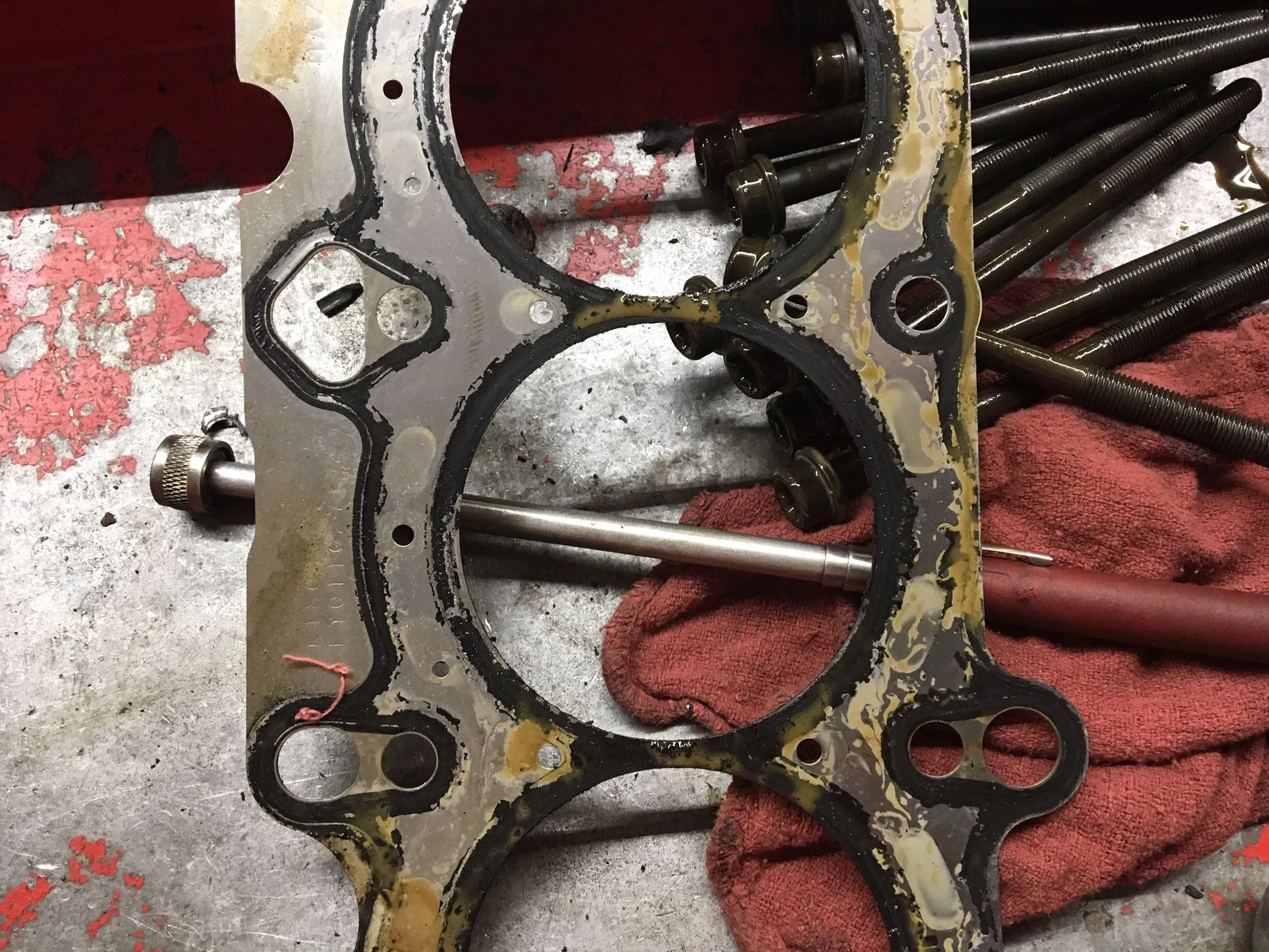

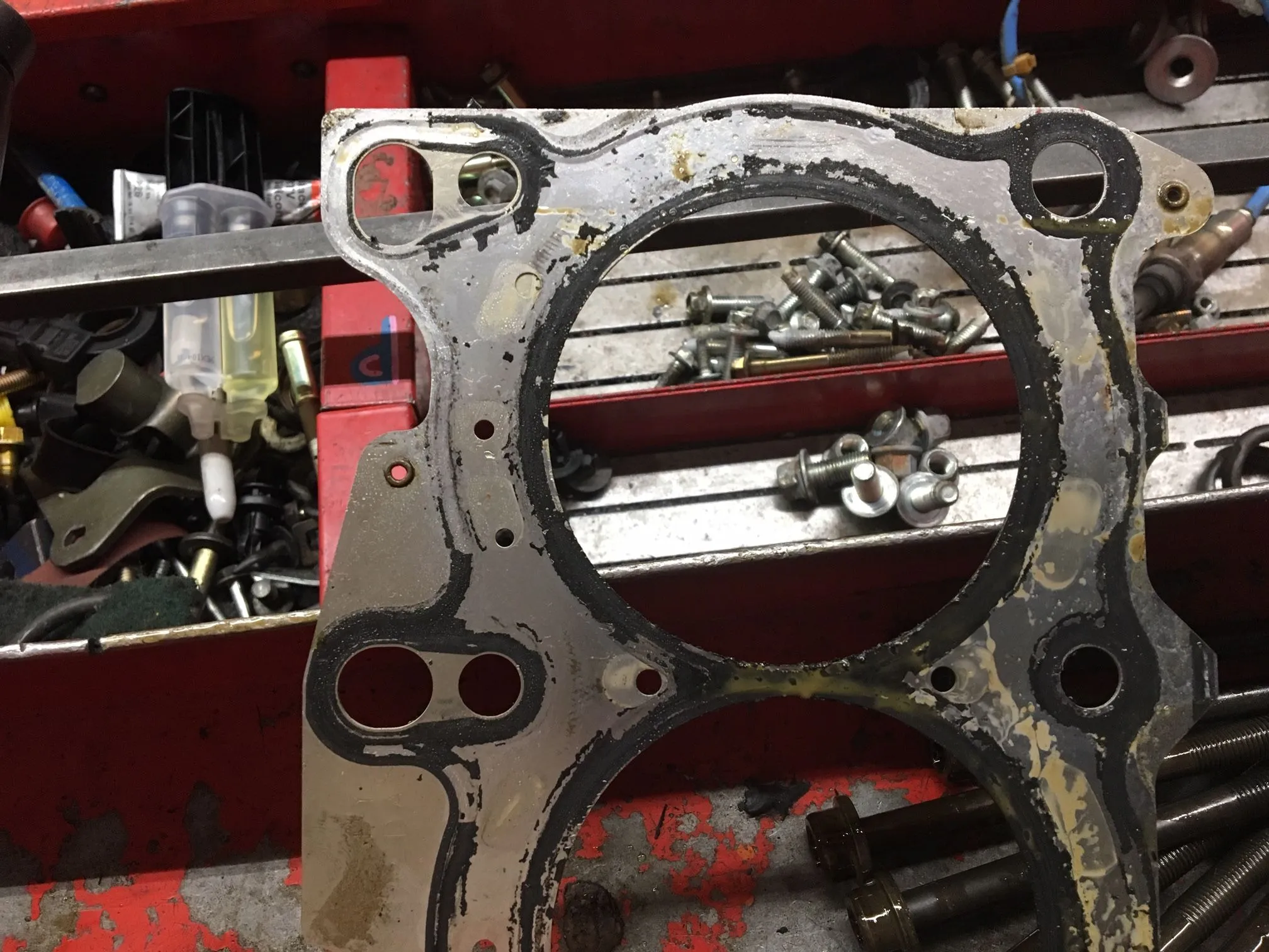

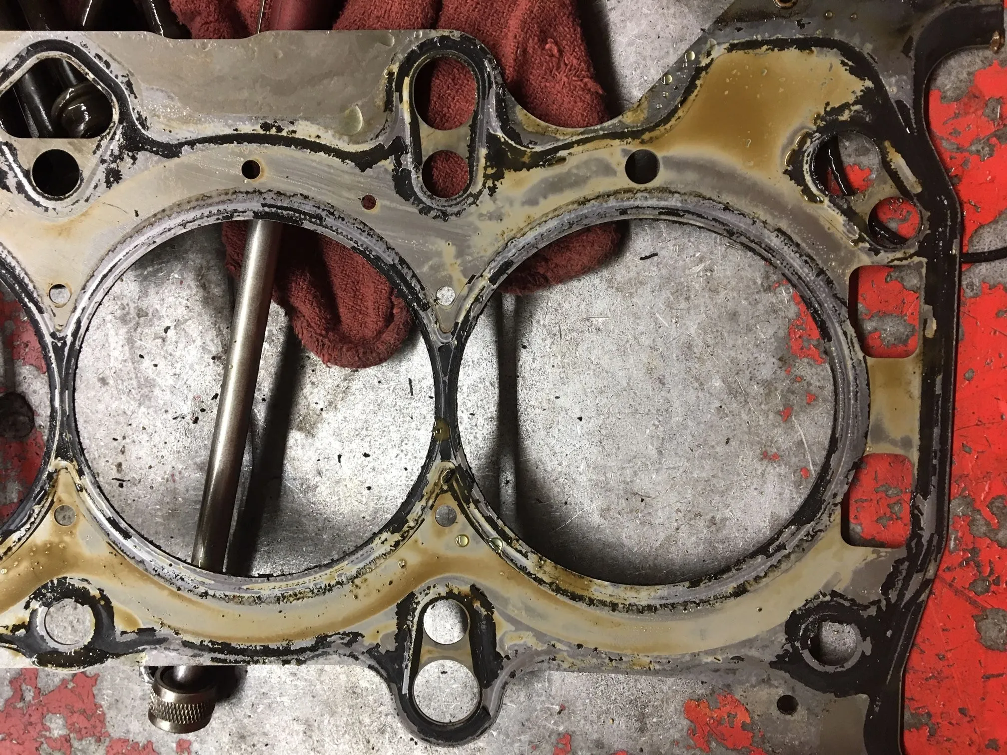

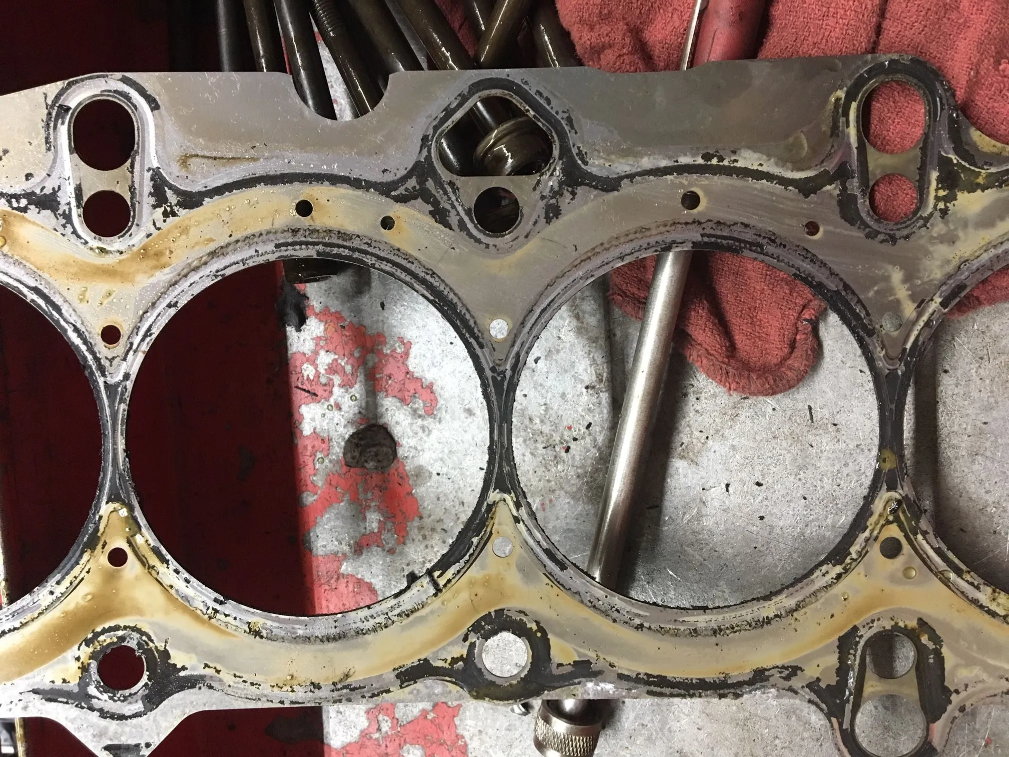

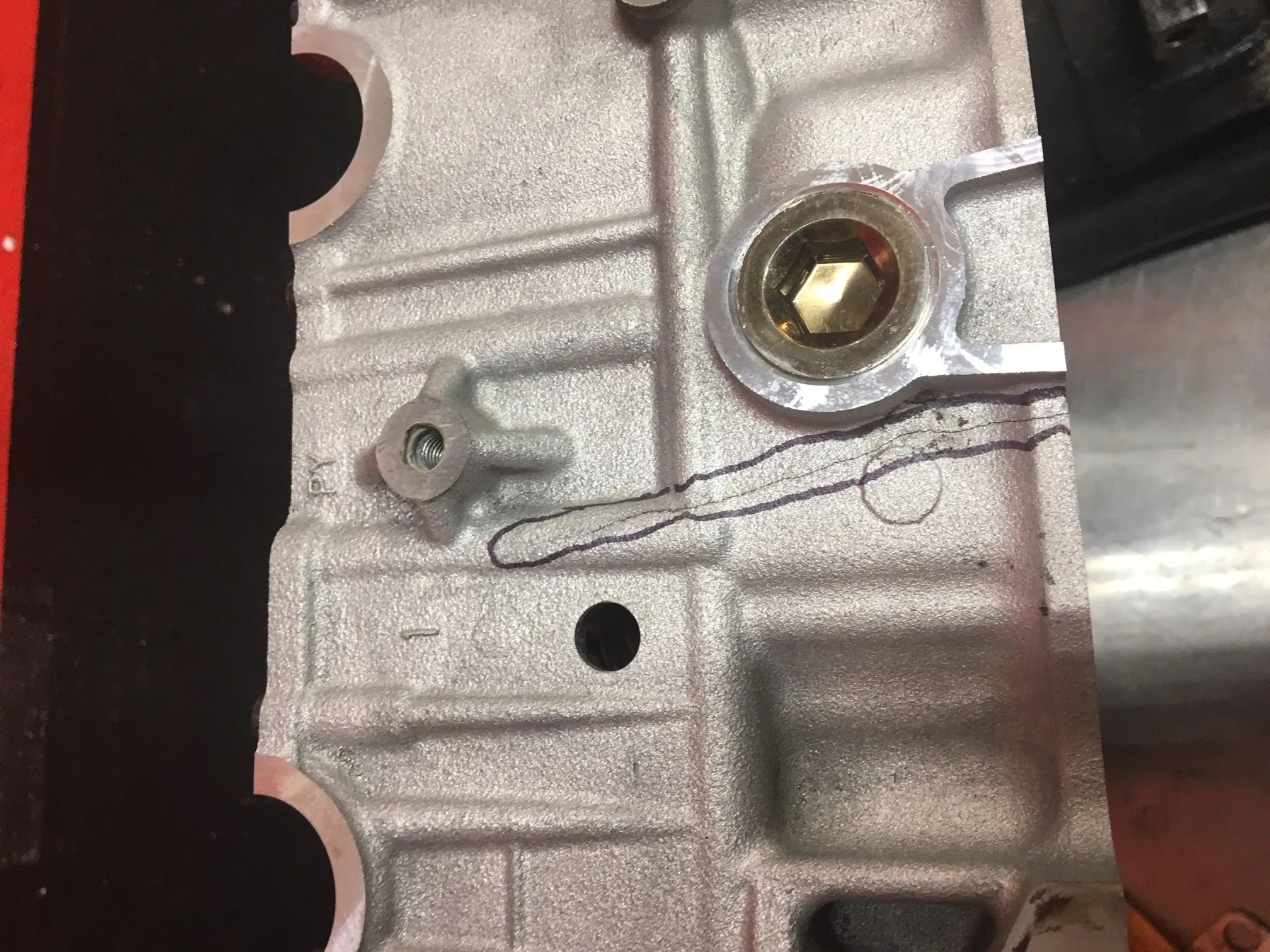

I got a quick update to share. My mechanic removed the head gasket (see attached photos below) and sent the cylinder head to his machine shop. What they found is a nice long crack on the external surface of the cylinder head (see attached photos). My mechanic also said that there were no overheating signs in the engine and that this may be a material defect failure. Does anyone have any experience with a similar situation? Could I just put in a remanufactured (not rebuilt) cylinder head and solve the problem? Or do you think there may be cracks on the cylinder block as well, and I am better off with a used engine (whose maintenance story will be unknown)? Once fixed I hope to sell the car (within the next 2 months), and I do not want to keep spending a ton of money on this. All input is welcome.

Since you’ve found the real issue, and plan to sell the car shortly, the best choice for you is to spend the least money putting the engine back. Used engine, rebuild head, whatever.
Have you figured out if it’s cheaper simply to get a used engine at the first place without trying to take the engine apart and find the culprit?

Typically, it is less expensive to do an engine replacement, than going the route I went. However, I was able to do that since my mechanic was nice enough to deduct the hours spent so far from the total hours to do a full engine replacement.
I am interest to hear views around what gives the car more of a useful life. Is it just putting a cylinder head or an entire engine from another car? Also, any recommendations on what other parts need to be replaced while we are at it (I am asking this to get educated, not that I want to spend a lot more than I need to).

Given that the initial problem was a blown head gasket, I would think the best solution (and cheapest) is to put in a new/used head back in. I would further suggest you follow your mechanic's recommendation. He should be able to see if the block is OK.

Either way has benefits and drawbacks. It also depends on the skill of the mechanic. Nowadays an engine swap has less chance to screw things up, so it becomes a preferred way to handle the blown head gasket issue. Of course getting a brand new engine ( actually it’s always a rebuild) is expensive, a used engine has too many unknowns.
I don’t think there’re too many things need to be replaced at the same time in both situations. Engine oil、coolant、spark plugs、air filter、and any other maintenance parts. For a used engine, you can replace parts which is showing signs of oil leak, such as front and rear crankshaft main seals、front timing chain cover seals、oil pan seal、valve cover gasket、etc.
