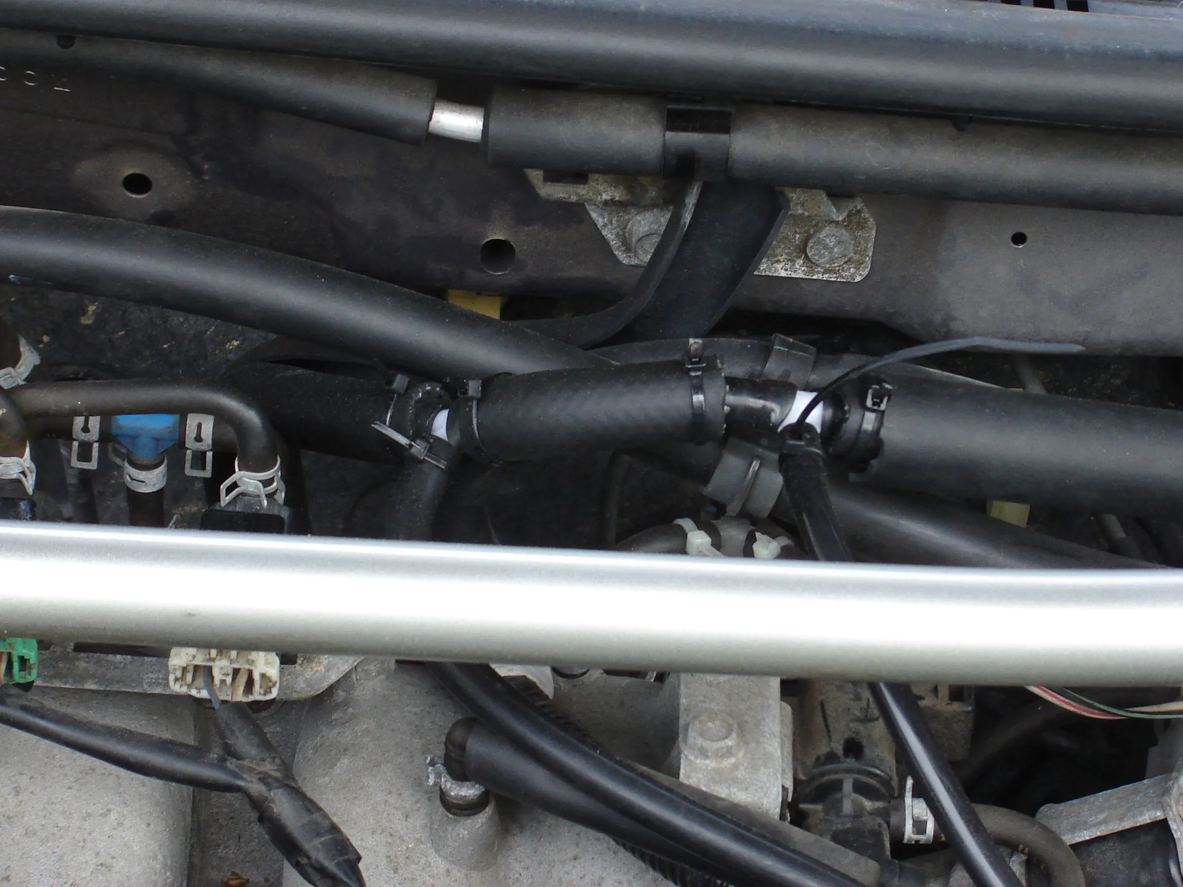

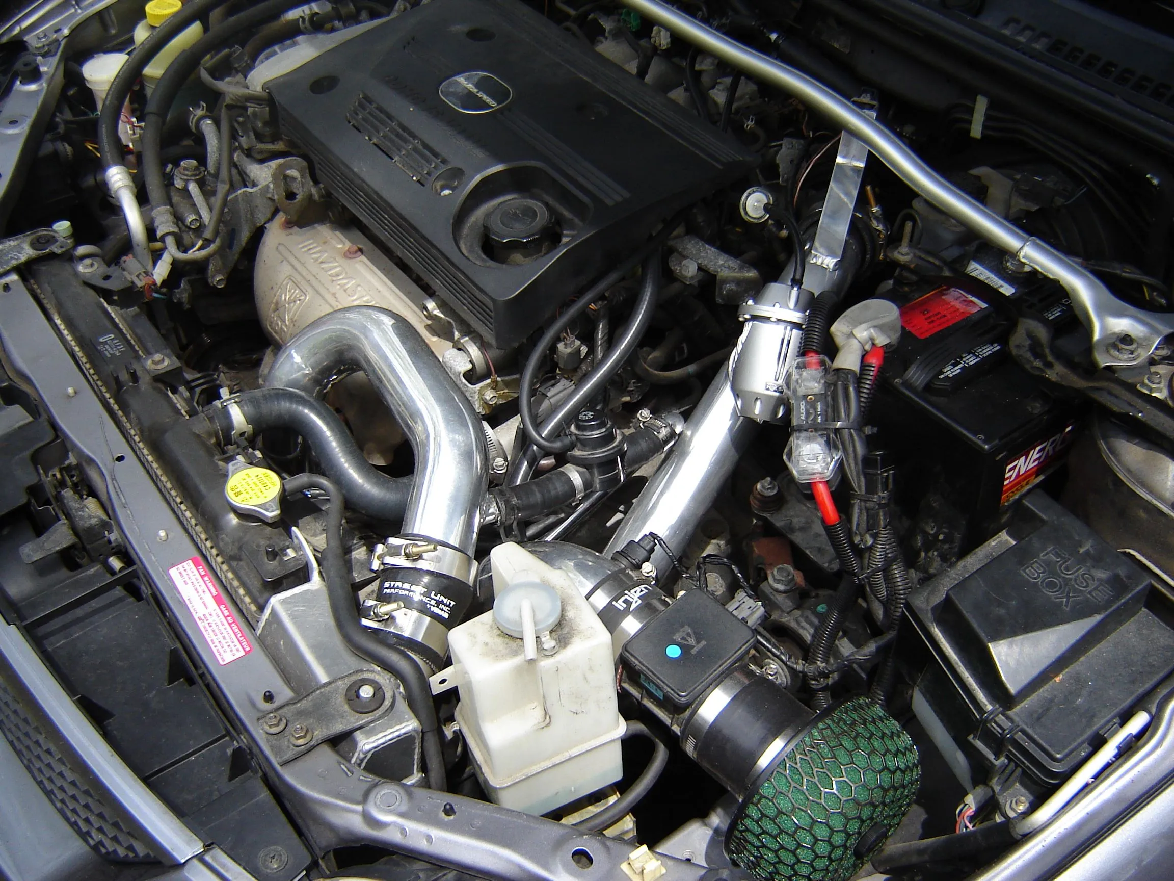

the compressor surge is a debate that has been going on here for a long time. anyway, I have the dual set up on my msp with the hks bov and i have no turkey at all! I did tap into the brake booster, but i did it twice one tee for the bov and one for the bpv. the cut must be made on the pass side of the check valve. you can feel it. make two separate vac sources for bpv and bov. also, make sure that the vac lines to them are as short as possible. hope this helps.
here are the photos of my set up hope this helps!
