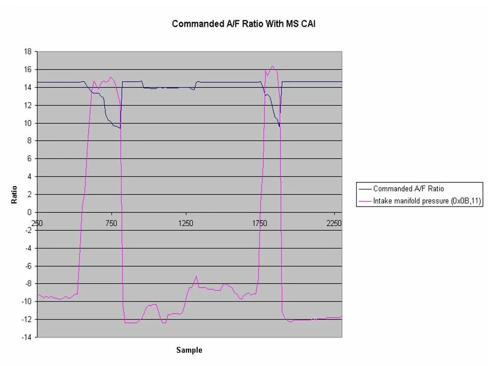

Nice. I calculated my full load A/F ratio change from 12.2 stock to 11.5 with the Mazdaspeed CAI. Your measured A/F lines up pretty close to my calculated (based on OBDII parameters). Does anyone know if this is a safe level? It is still rich considering that anything below the stoichiometric value of 14.7 is considered rich, but how does 11.3-11.5 compare to other cars? Is it still a safe value? How lean can it go?

Actually, the car looks to be running about 2% leaner despite the richer commanded A/F ratio with the MS CAI. The ECU is commanding 11.5 under full load as oposed to 12.2 in the stock configuration. The actual is A/F ratio is not easily deterministic from OBDII data.
Here is my original post on a different thread:
First off, the numbers indicate that the First O2 sensor is measuring the A/F to be about 8% leaner than stock with the MS CAI. The good news is that the ECU is commanding a decrease in the A/F ratio (Richer) by about 6% to compensate. The Commanded A/F ratio under peak load in stock config was about 12.2. The Commanded A/F ratio under full load with the MS CAI was about 11.5. This is the commanded A/F ratio based on compensation learned from feedback while previously driving, so it seems, it is compensating for the MS CAI. I also noticed during the dyno tests that almost the same density of black smoke was coming out of the exhaust in stock vs with MS CAI. So, despite the difference in diameter of the MAF housing (as posted by flyrevs and cp-e) and the increase in air-flow from stock to MS CAI, it seems the MS 3 ECU is adjusting the A/F ratio to keep the car from running too lean. Initial results look like it is about 2% leaner.

Here's some OBDII data on the "Commanded A/F Ratio" with the MS CAI. From my calculations, the car is actually running 2% leaner than this.
