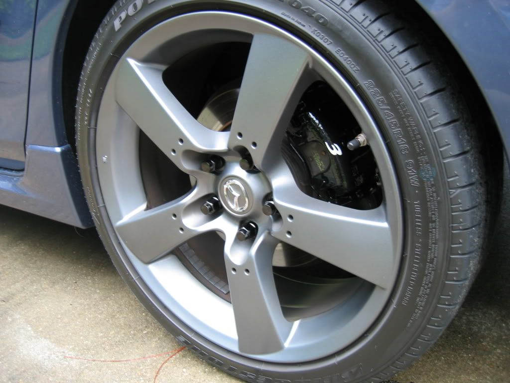

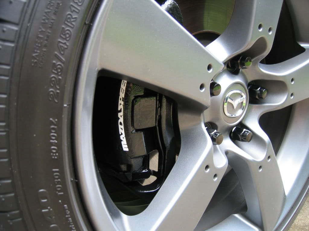

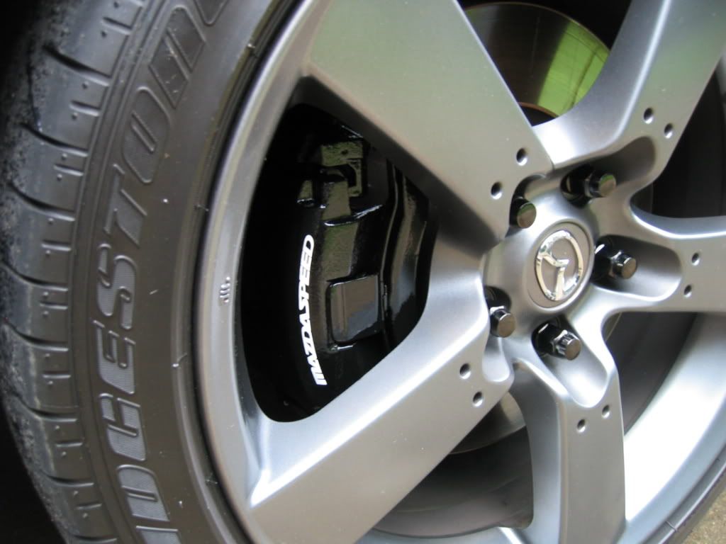

You can prep and paint all at the same time, so you don't have to do it in shifts. This is how I did mine, jacked all for corners with stands. The cleaner dries almost immediately after use. Remember to clean multiple times with the cleaner and toothbrush. Two coats is plenty with the G2. Painted everything in place including all clips, etc. Here's a tip: Instead of the POS brush that comes with the kit, get a one inch "fitch" sold at any paint store. Make sure it's china bristle, then you can taper the brisltes with scissors to give more accuracy. Finished product:

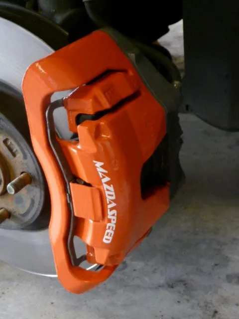

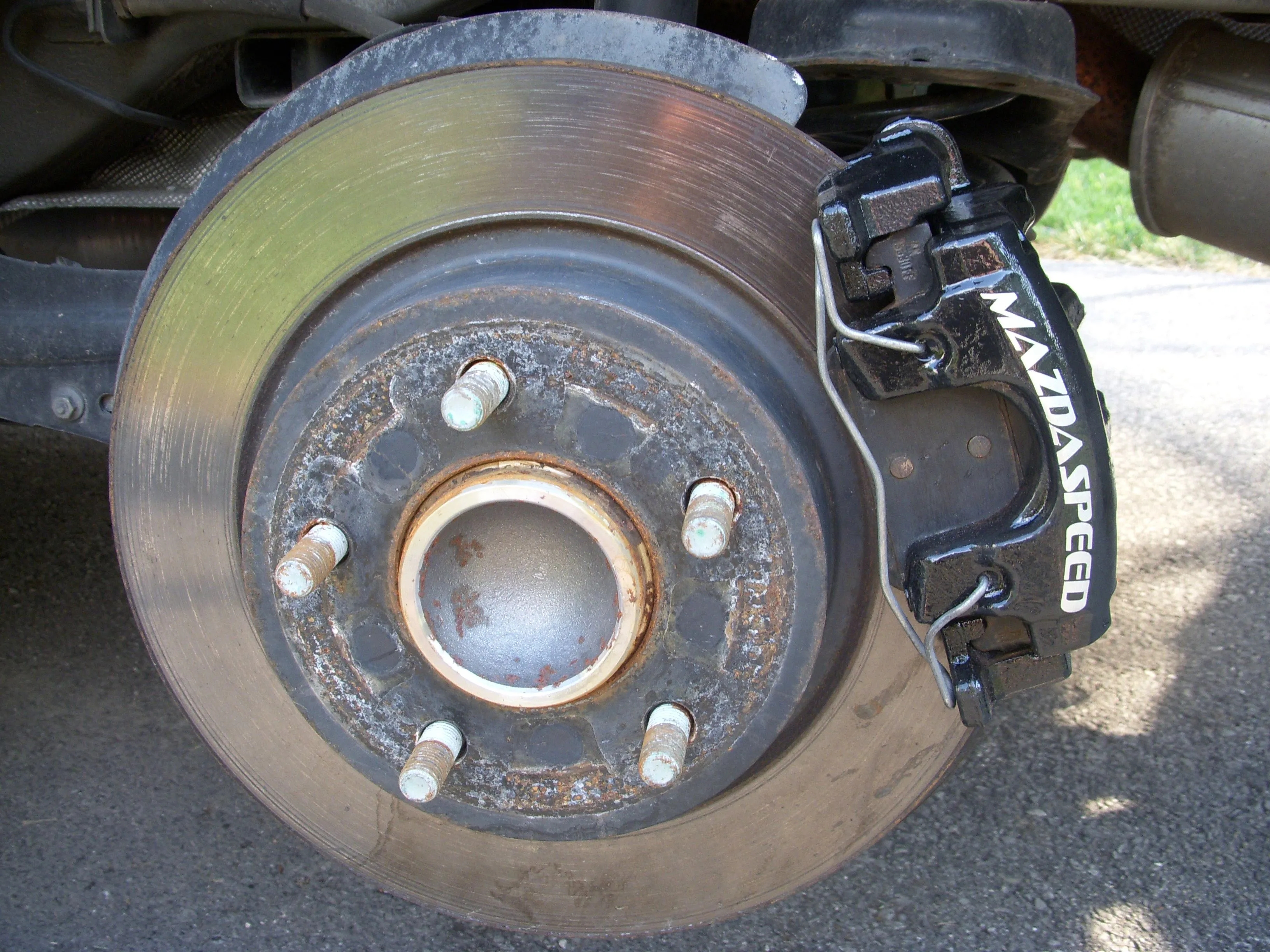

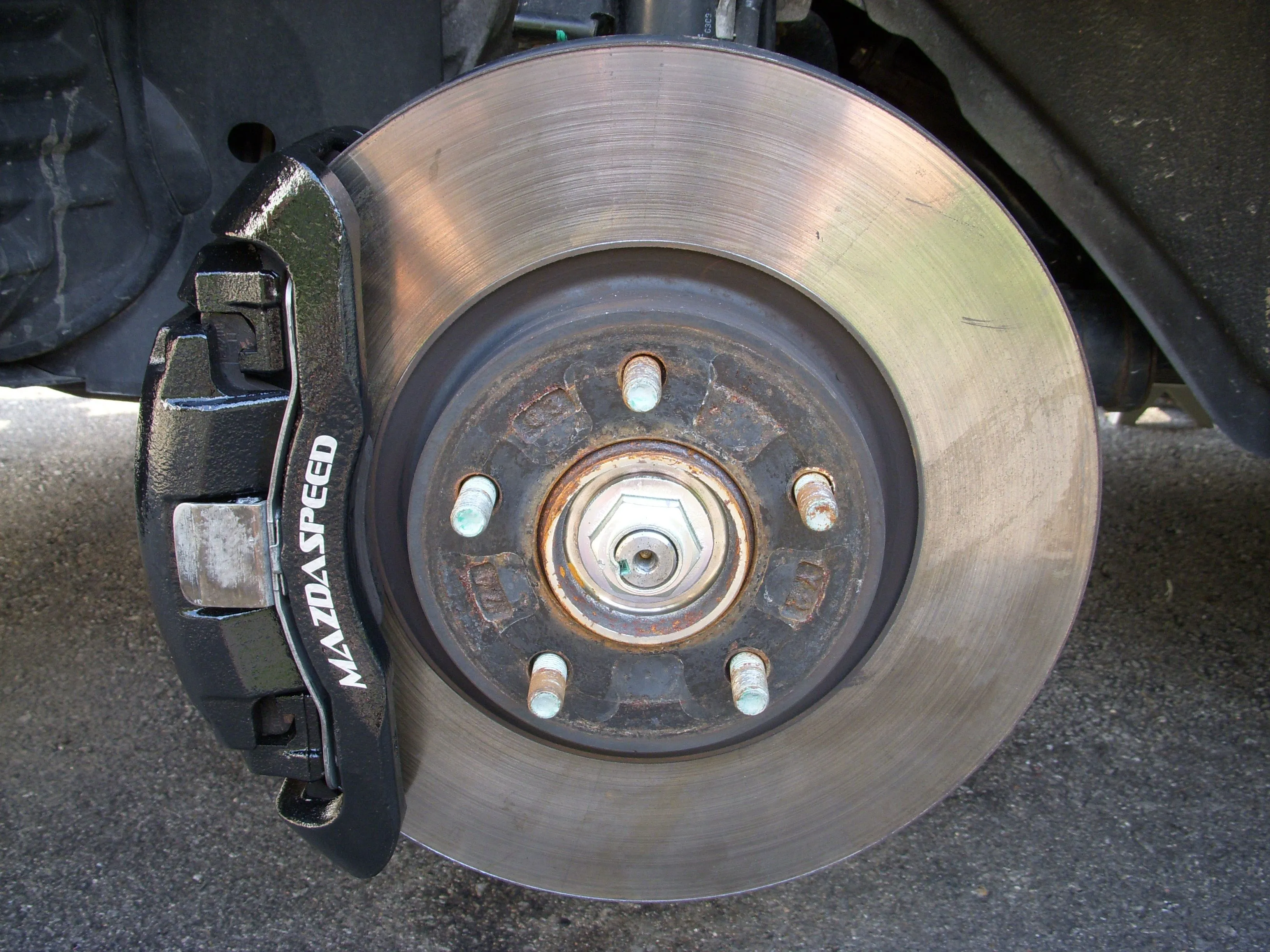

I wish I would have purchased a different brush before painting. The one that came with the G2 kit was trashed before the first coat was done. I removed the clips and outside pads just for contrast in color and ease of painting. As for the clear coat, the Vinz Decals folks say they are good for 6 years, and the metallic colors last 10. I have a Sunlight Silver MS3 and went with the black G2 kit with metallic silver 'MAZDASPEED' decals from Vinz.

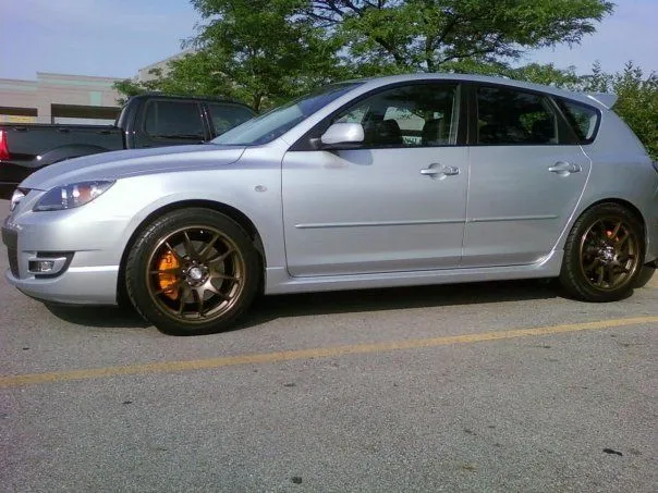

What was the temperature? Did you have any issues with the paint working time?
Temp was probaly high 70s to low 80s. The paint cured pretty quickly once applied, but the paint in the can started getting hard in about 2 1/2 hours. So I think it was curing faster than what it said in the instructions. I couldn't wait a couple more months - LOL

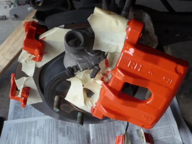

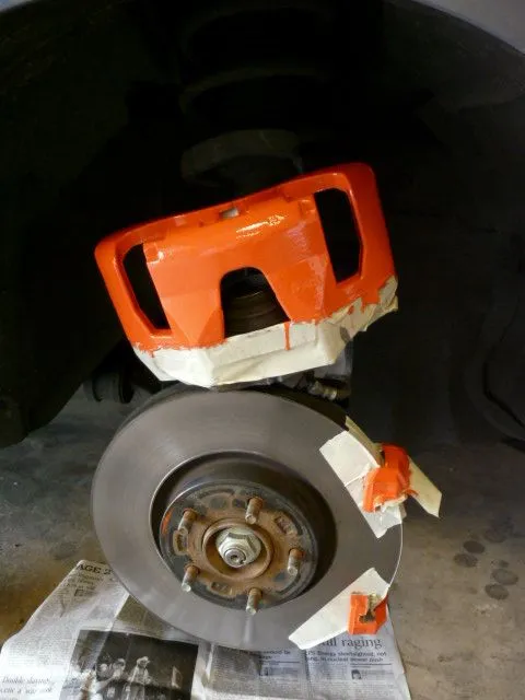

Finished painting about an hour ago. You're right, this stuff doesn't like high temps. I started painting at 7AM, so it was close to 70, but quickly got warmer. I managed to get 3 coats on by 9:30. I don't think I could have gotten a 4th - the paint would have been too thick. I'll post all pics when I'm finished, but one thing I will say... ORANGE FTW!!!

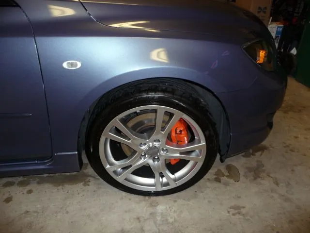

I decided to be anal and pulled the calipers. Spent about 4 hours prepping yesterday. A wire brush is a definite MUST HAVE. I have no rust, but it got the calipers much cleaner than with just the cleaner and towels. Taped and masked everything, then let is sit until the cool morning. I then proceeded to do some OBDII software stuff for a couple hours. I had my back to the front of the car, and never noticed that my headlights were on Auto. Battery is stone dead. I have no 2nd car to jump from, and my Coleman portable battery jumper won't hold a charge anymore. Hopefully I can get a neighbor to jump me.

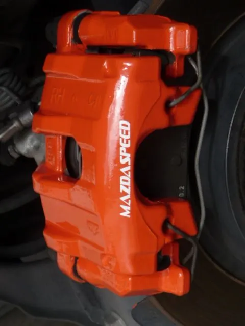

Cosmic Blue with Orange G2 Caliper Paint

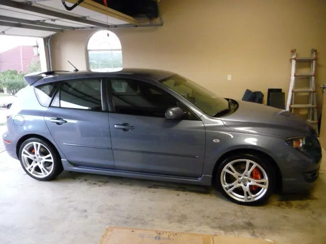

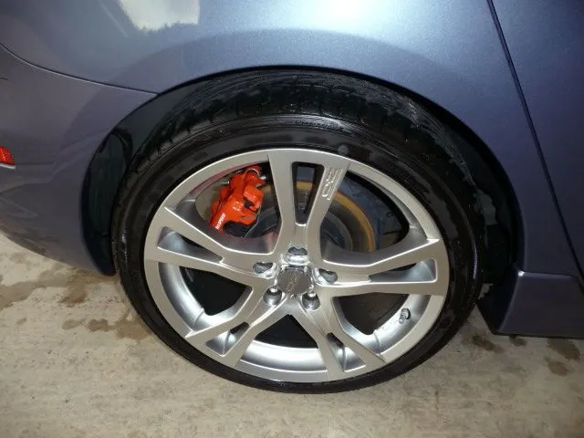

Finally Done. I did have a screw-up and masked off something I shouldn't have, but fortunately you have to look closely to see it ;) I'm pretty pleased with my color choice and how it turned out. Everyone I've talked to who hasn't seen it thinks orange is a weird color, but I like it - maybe because I'm color-blind :D
A few more...
And...
Great job! I had my dad paint one of the rears and he didn't spread the paint out as much as I would've liked so it looks oversaturated. So mine wasn't perfect either. There are a couple of other imperfections, but like you said, the average person won't notice :)
