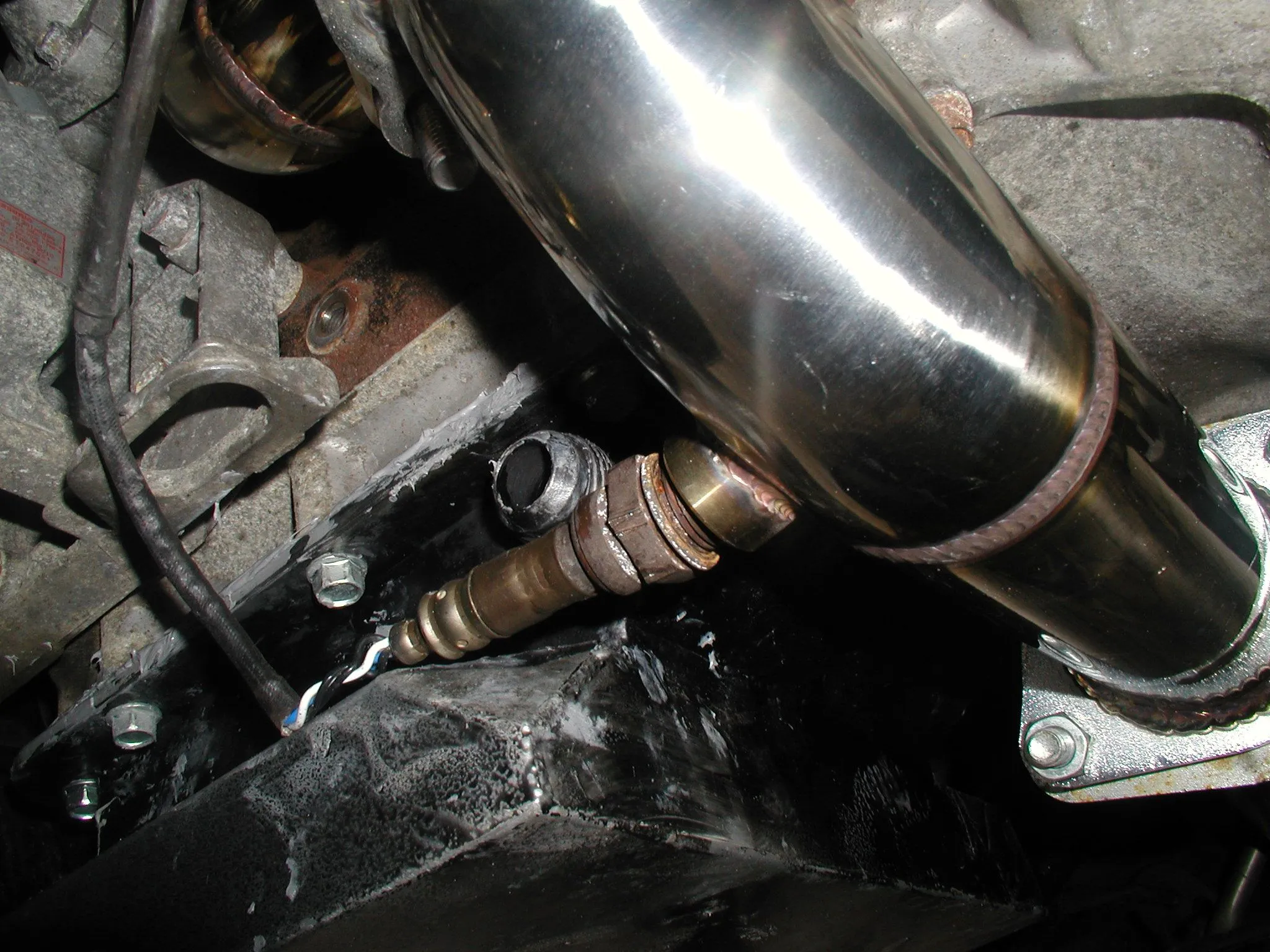

Well after trying to wrap up the install of my MSP turbo setup, the CS Downpipe and AWR pan don't fit to well....
Its not that the J pipe doesn't clear, its just that the bottom O2 sensor hits the pan.
I ordered a new O2 bung and plug to plug the old hole up and weld up a new one so the car runs right.

Well after trying to wrap up the install of my MSP turbo setup, the CS Downpipe and AWR pan don't fit.
Its not that the DP doesn't clear, its just that the bottom O2 sensor hits the pan.
Hmm... my GHL downpipe fits fine but I'm not sure about the O2 sensors. I'll have to check on that.
Would it work if you had the O2 downstream a bit further, it sounds like your using the bung on the J pipe. I think it would work if you had the O2 on the cat pipe.
Yeah, the J pipe fits, but is close. The bung for the O2 is right there though and wont clear the pan. I am going to mount the bung on the bend at the J pipe with the non fouler trick.
I am really not too happy with the CS DP for fitment issues. I can barely tighten the bottom nut on the hot side housing of the turbo because the inner pipe has to be on top of the stud. This freaking thing better not have an exhaust leak....

Dont mind the crappy paint job on the AWR pan. For some reason when my friend welding the bung, he decided to paint the pan black..
I'm in the process of taking the paint off LOL
