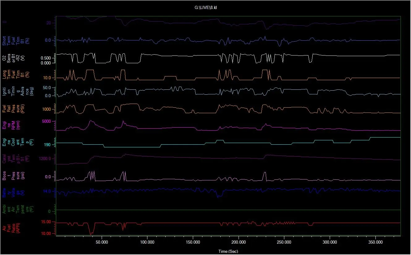

My 2008.5 speed 3 recently started throwing a P2187 check engine code, so I checked for leaks on my cobb sri intake, after finding nothing wrong I proceeded to clean my MAF sensor with appropriate spray cleaner I found that the light kept going back on after clearing it, I then took it into my local dealer for service. They found nothing wrong and returned the car to me. The next morning the light went off again and I returned it to the dealer. Then they said it was the high pressure fuel pump and proceeded to replace it. when these codes were thrown, I noticed my stft was running 25% and sometimes higher at idle. After the fuel pump replacement my STFT are now better but sometimes still return to 25% on idle. The LTFT is much better now, it was 22% and has since dropped to 12.5 and sometimes 11.3%. Here is the live data recorded from my drive home at the end where I let it idle some, take a look and give feedback

whoa...you need to post a better graph..such as an attachment instead of in the thread..can't read or line things up..
here is a pic of the log file
It's now back at the dealership. threw another P2187 code this morning. I saw them letting it idle in the shop and logging it on a laptop. He had removed the intercooler shroud, appears to be looking for any vacuum leaks and checking the purge valve for issues.

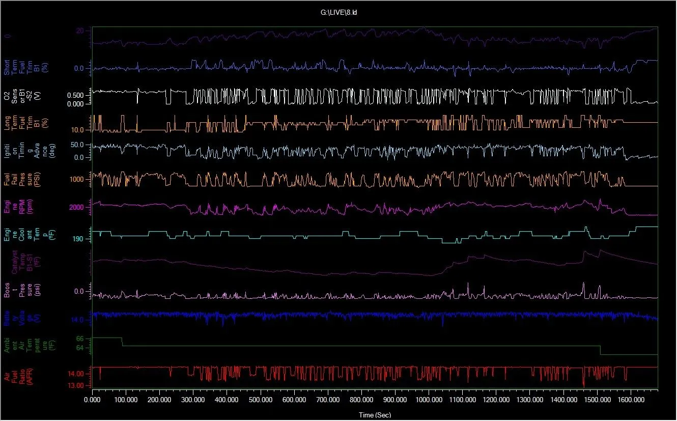

Fixed right this time!
They appear to have it fixed correctly this time. considering they shot gunned it with parts......
Fuel trim at idle now hovers closely around 0%
