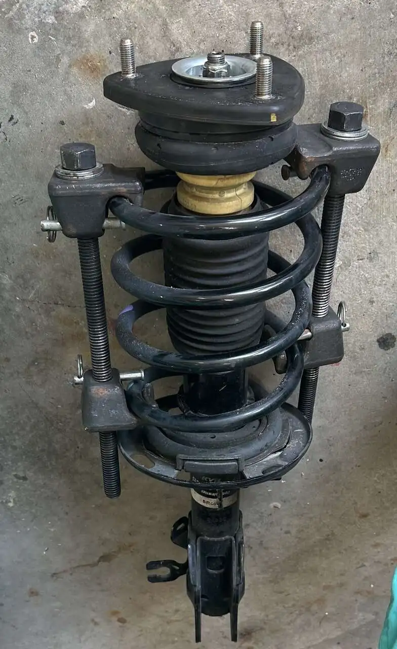

After 130k miles on the original OEM struts, I replaced all of them with KYB Exel-G units.
1yr later the upper strut mount on the driver side is making lots of noise and I decide to install a replacement mount.
I removed the strut and compressed the spring. To remove the nut on the upper mount, there is a hex key in the shaft to prevent it from turning while removing the nut. I used a hex drive socket and an offset box wrench to try and remove the nut. I had to apply so much torque that the hex key stripped completely. The nut did not budge. Easily over 100lbs of torque.
I then tried holding the upper portion of the shaft with locking pliers and used an impact gun. I was able to unthread about halfway, but that was all I could manage. There was no way to keep the shaft from spinning. A pipe wrench couldn't grab it either.
I noticed the nut was a nylon locknut. Not sure if the OEM mount nuts have nylon. The workshop manual only lists 47 ft/lbs of torque for these. The KYBs were torqued way beyond that. Really poor design.
