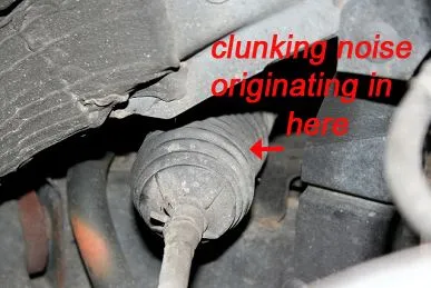

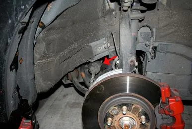

I found the where my front end clunk is coming from. Please have a look at these pictures and give me opinions of what the problem is.

From your pictures it looks to be your U-joint. If dirt got in the boot then it can cause damage. They aren't that expensive but get it fixed or you could have a disaster if it breaks.
Before i sold my Ms6, i did had that problem. It came from the driver inner tie rod. I took it to Mazda and it was under the TSB. They lubed the inner tie rod and it fixed the clunking noise.
