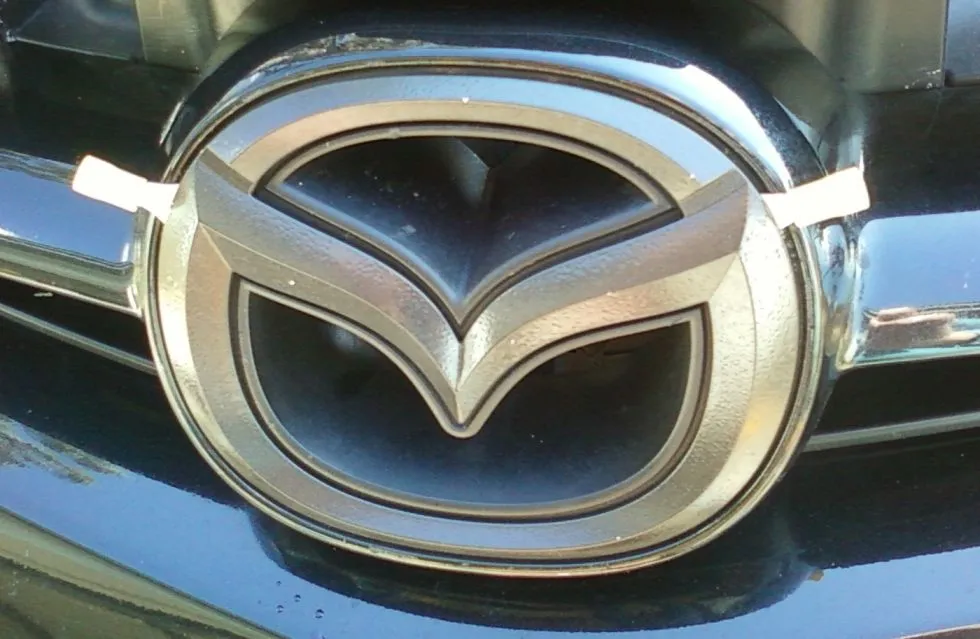

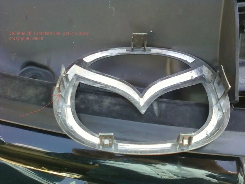

Front badge removal tip
06 LS MS6
07 BM GT (shell has been struck from the roll)
Be patient, be nice to the clips, they are incredibally delicate.
free one clip at a time, and keep it from reengaging with little helpers, ring terminals work well for this
pick a color you like the first time, so you don;t get good at removal, like me
