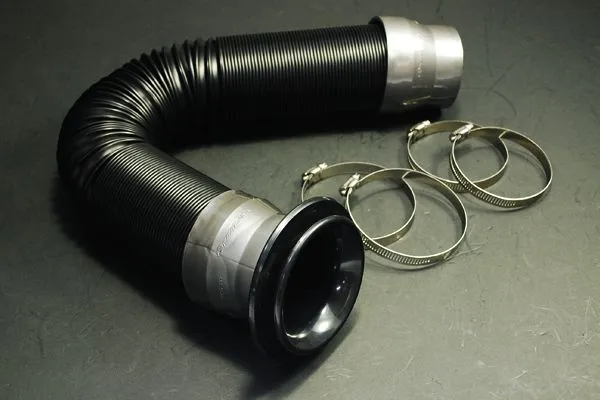

something like the one in the second pic. I just used some drier hosing, that i got at the harware store and a mesh screen over the opening and some hose clamps.
With this setup, i felt that they was more torque and anyother intake setup i've had. But its your car do it up how ever you want to.

I can get one of the expandable hoses from pepboys/autozone but weapon-r sells this one at 42 bucks (including shipping) .. what should i do???
the one from weapon r actually looks better and comes with brackets and silicone conector :D
hardware store, way cheaper. Silicon connector, you can get them off ebay, or a local performance shop.
