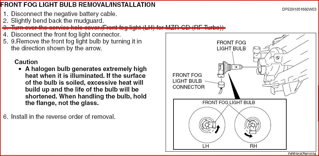

Maybe it is already in the unlocked position.
Just got back from trying "brute force" and got only about a degree or so improvement in unscrewing the socket. I have a relatively firm grip, but my hands are completely skinned now despite wrapping a cloth around the socket and using thick gloves to gain leverage. I have no idea how you did it. There's got to be a better way.
I don't think it's in the unlocked position because I can see where the tabs need to be aligned to pull the socket out. I tried rocking it backwards anyway but it didn't work.

By the way, is that photo from your owner's manual? Mine looks a bit different. It's not as illustrative.
