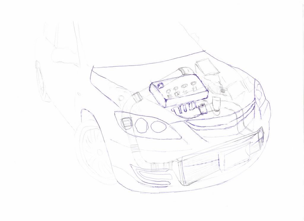

I was poking around and I think it would be pretty easy to make a Custom front mount, from our good friends that produced our upgraded TMIC, they make a good core for $300, and the piping on ebay would be around $120 shipped, which Im sure you could get all you need for under 500-600, depending if you want samco silicone or not. I was talkin with my buddy with his Audi w/ Ko4 that the best thing for our turbo so you dont get bad pressure drop is to get 2.25 piping. I got it all mapped out how I would run it depending on the final entrance to the throttle body. I still didnt see a post on the price for the kit, but for our cars it would be better for a front mount, the top mount does its job, and the upgraded tmic does an even better one. IF the stock one feels cool to the touch on top of the engine, imagine how it would feel to the touch on the front of the car. Its all a matter of taste and how much you want to do to your car...
I was thinking about having an intercooler like the one posted. I found a couple paths/holes and completely based the piping on that. There are 2 different ways you could go to the TB from the IC but this is just my really rough sketch. I mainly wanted to get it on paper and go from that. Im really curious to see how they ran it!
Yes I scanned this into my computer from a peice of paper (ghey)

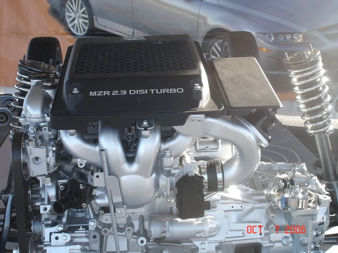

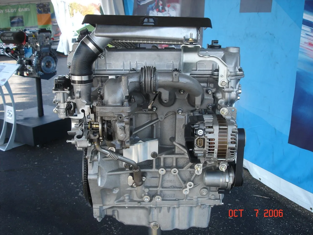

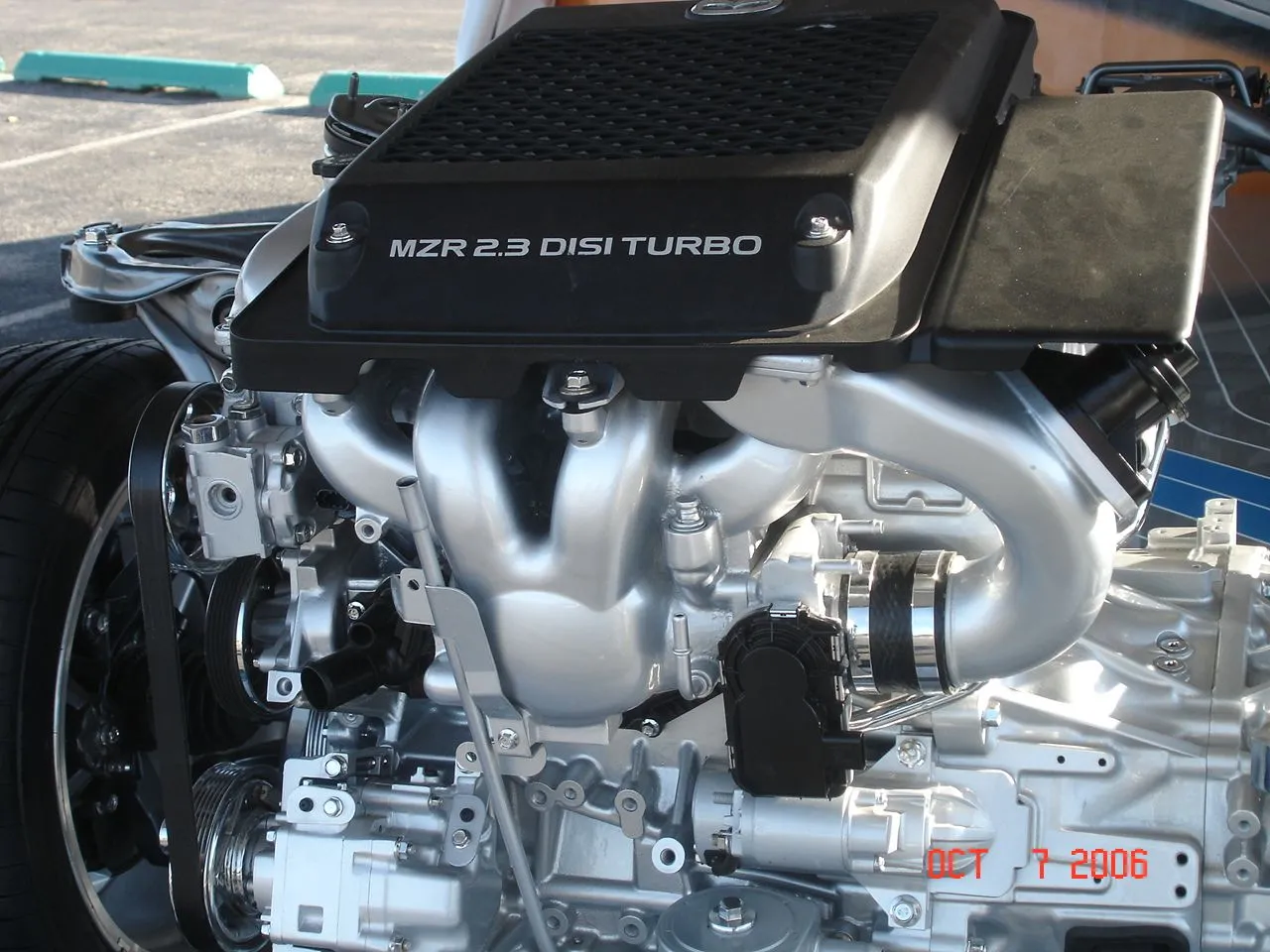

not to be a buzz kill but according to the pictures i have the turbo/exhaust manifold is in the rear of the engine bay. But the idea is still good if the holes already exist.

LOL his pictures right. That manifold in the picture looks like he was trying to draw an intake manifold.
Lol oh really.... Yeh I think I know that buddy , I guess my intake manifold looks like headers? You see its 4 runs going in, theres a box for the TB and then the oval thing is a BOV, all you have to do is look at your "pictures" and follow my piping route, because really all you have to do is make your mind go the other way, because the piping connects to both intake and exhaust manifolds, whether through the turbo or throttlebody. You honestly couldnt get that looking at the picture? I know its rough but imagine a little bit. Maybe you should try looking at the real engine instead of pictures.. (lick)
Thanks JEPH! lol people.... Im sorry I wasnt testing my artistic ability on the intake manifold becuase everyone that owns the car SHOULD know where it is...
I guess I should take it as a compliment because the holes are already there! lol Im not trying to be a jerk to the Nocoastganster, but take a little more time before you try to kill someones buzz! lol And thanks those pics, might come in handy if I cant see something in my engine. (breakn)
I was trying to compliment your drawing with some actual pictures so people could see. no hard feelings meant or taken. If you need some more pictures let me know. I cna post them up in here.
Tim
LoL its not a problem, I got a kick out of it more than anything! Would you happen to have a direct shot of above the engine bay, and a direct shot of below the engine bay? THat would be peachy!
