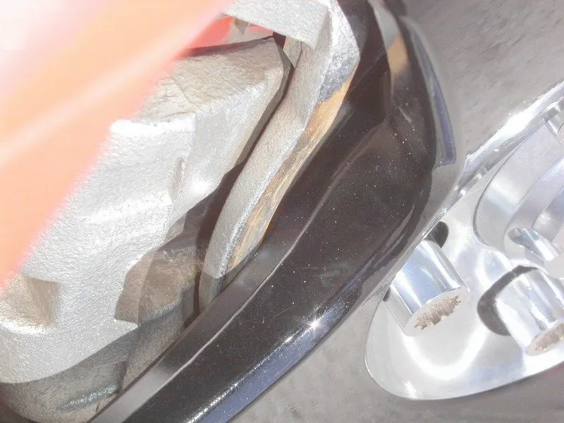

I'm posting only because the ASA JH8 wheels are sold and "recommended" for the MSP by Tire Rack and I'm sure peeps have bought a few sets because of it. I just bought a pre-owned set last week from Run for Cover, and they were an essentially unused set he bought from another forum member, who bought them from Tire Rack. Run for Cover told me that they didn't clear his upgraded front calipers. Well, they don't clear the stock calipers either, and they seem to rub exactly where his big brakes did...interesting coincidence. Either way, a word of warning to anyone wanting to run these wheels. I had to break out the Dremel and work the outermost part of the caliper bracket down .020-.030 to clear the wheels.

I took some pics of it so you can see what you think, and another that shows just how close the caliper is to the wheel spokes. Yes, I know I'll have to repaint my calipers, lol.

Those look great! (2thumbs) Word of warning ... any extended "spirited" braking and the calipers *may* expand enough to rub. I'd throw a spacer on ...
Thanks! They're really growing on me. I also get less rubbing with the 7.5's +50 offset than I did with the stock setup.
I'm going to clearance the caliper just a bit more, but this time with a die grinder so it shouldn't take nearly as long.

Just finished my clearance work with a die grinder. Definitely the way to go. Yeah, PM me when you know you'll be coming down. I go up to Bristol every spring for the NHRA race.
