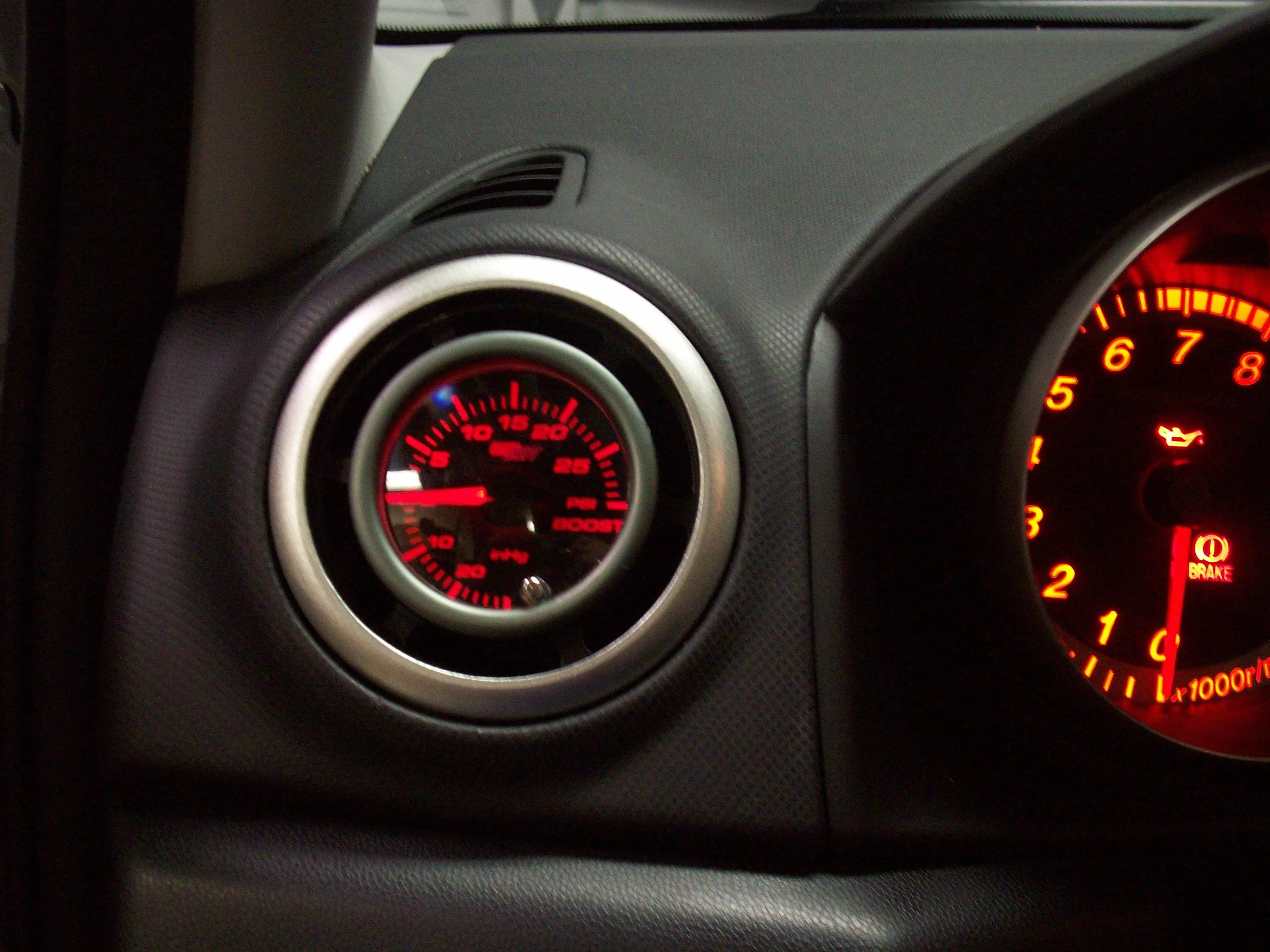

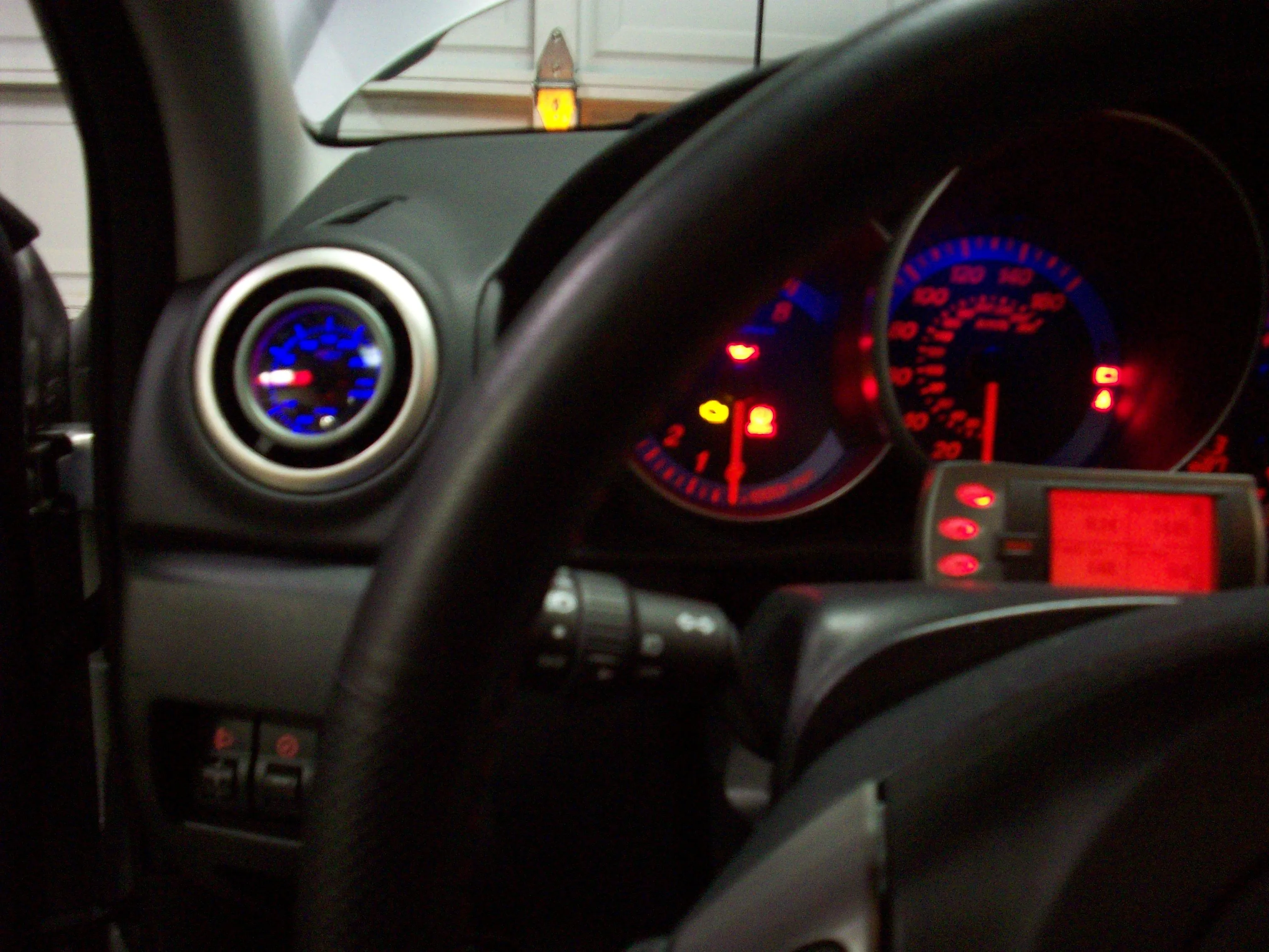

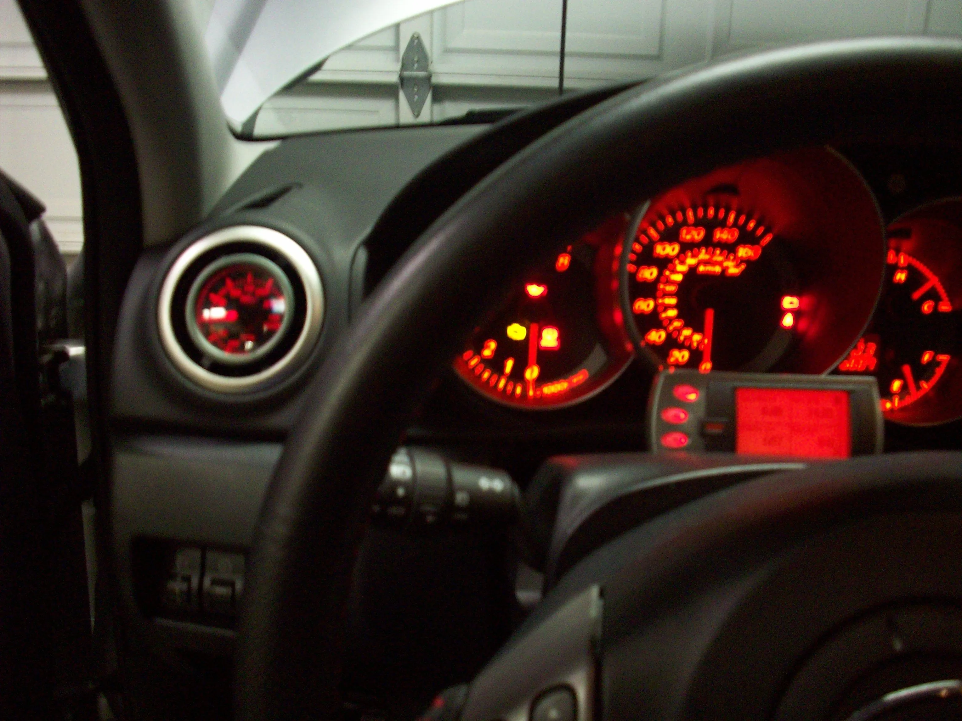

final results...

that looks like my same set up! :) looking good!
