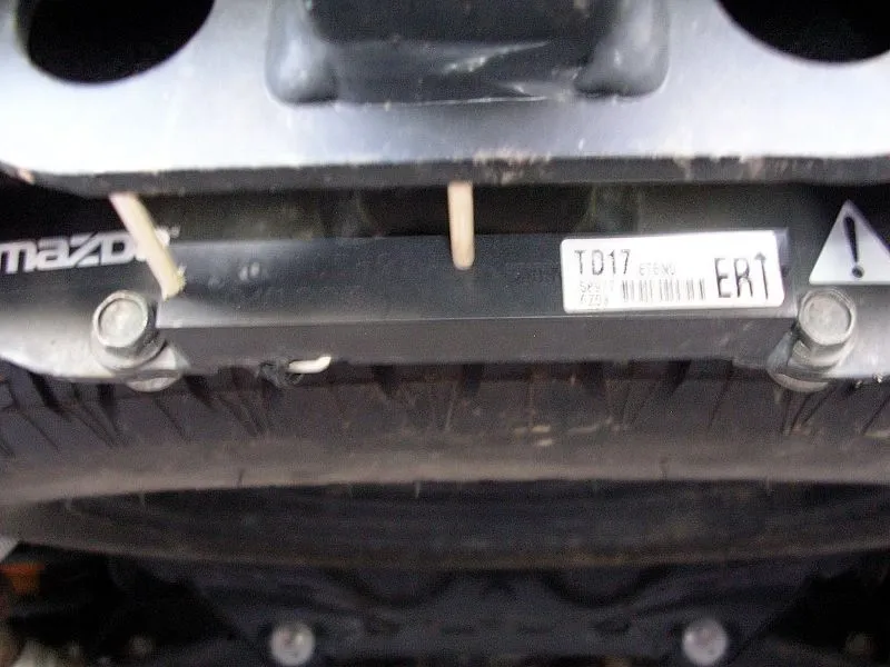

Hope all had a Great 4th (usa). Mine was great except for bottoming out my 9 and taking a large divet out of a lawn. Seams everything but my trailer hitch cleared.
Good news: I pulled the intact pie plate sized chunk of grass out and replaced it with a good stomp.
Bad news: An electrical module about 5 inches long by 1 inch tall snapped off from under the factory hitch. Why the hell would Mazda manufacture a bolt-on electronic module to hang lower than the hitch itself?
I looked at the two wires connecting it and they seem intact, as well as the coupler connection. I was able to use epoxy and re-mount it where it was, with the little arrow up on the sticker attached. My thoughts are that this has something to do with sensing a trailer connection or some sort.
Bet I am the only dumb A** that has done this so far. (hand)
Sorry for the picture, but it was late out when I took it. I snapped off the TD17 ER module. I have the 07' GT w/ factory installed hitch. The white sticks are what I used to hold it in place while the epoxy cured. Haven't bothered to take them out.
If you look toward the left side there are a couple of wires protruding. One white and one black. These lead to a connector harness that seems to be tied in with the trailer wiring input.
I asked ceric to come have a look. I'm also curious what that is and why it's placed there, since I wasn't aware of it even with the towing packaged CX9s.

That thing is the RKE (remote keyless entry, i.e. SmartKey) exterior sensor.
It is interesting that mine (w/o Tow package) is located slightly different from yours.
The sensor is meant to detect the presence of a fob near hatch so that it allows your access from hatch. There are many sensors like that in CX9 if you have the RKE system.
- 1 in each front door (X2)
- 1 near gear shifter
- 1 inside glove compartment
- 1 near air vents for 2nd row passengers
- 1 at floor behind 3rd row seat.
- 1 inside bumper near spare tire. (*** this one ***)
Working together, they provide inputs to ECU so that it can detect where the fob is and make decisions.
Hope that yours is not damaged. Try to use the fob at the hatch to see if it still detects the fob properly.
The torque for the bolts is listed as 78-112 in-lb ~ 6-9 ft-lb.
Let me know if you need more from WorkShop pages.

Sweet, thanx for the clarification. I have tried to keyless entry from the tailgate and it worx fine. Normally I would have worried about torque specs on the bolts, but epoxied it back as it had snapped off at the bolt tabs.
