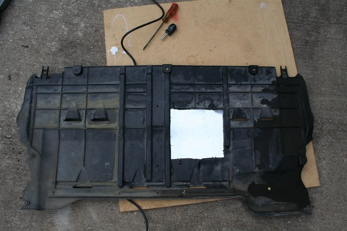

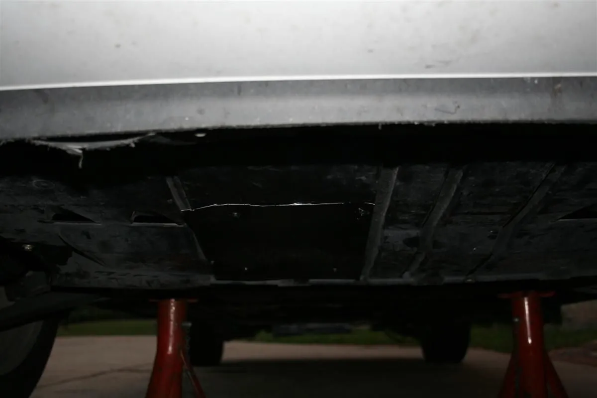

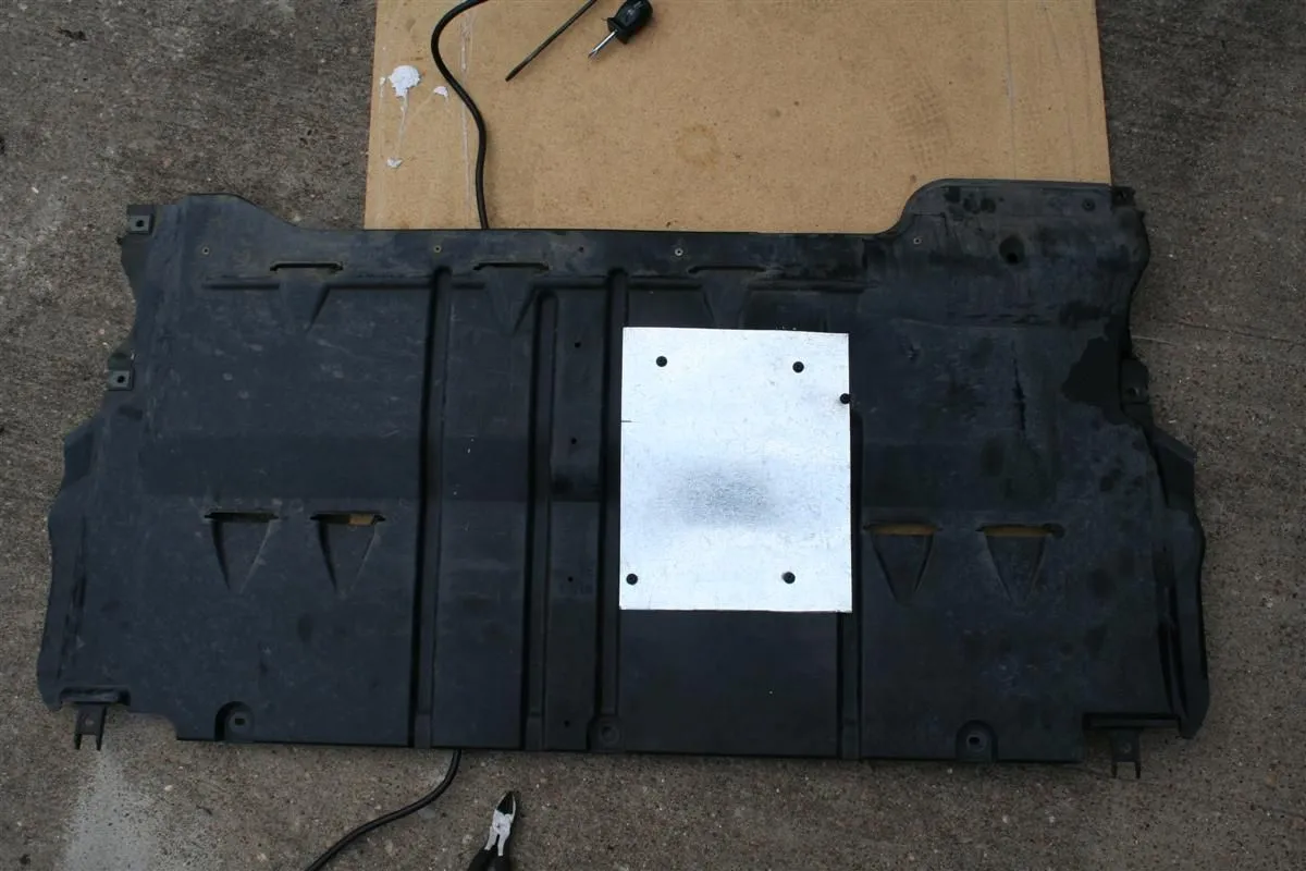

engine shield mod for oil filter access
I cut 3 sides of a "door" under the filter approx 6" square, and left the front edge as a virtual hinge. I also made the cuts slant towards the center of the door at the top side (instead of completely vertical), so the flap holds itself in place when your done, but it does need to be "flexed" to pop it back in place. You have to hold or prop it open while you're working, but not having to use any fasteners to R/R it makes it worth it for me.

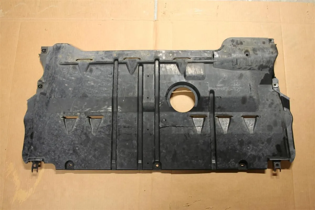

Rough guestimate where the center is (this is not 100% center but close enough).

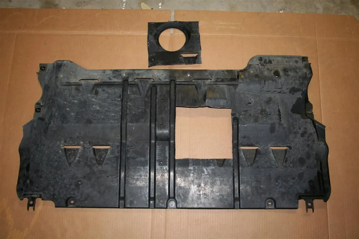

Start with a cutting with my tool to get within 1/4" of circumference I marked. Here's a pleasant surprise. The plastic is a very tough but pliable, not hard in the sense that it may crack. Because of its compound, I find that the easiest tool to use is a simple dollar store box cutter! Takes a few mins and you have to cut away slowly but you have a lot more control. Also, b/c some sections are thicker, using the power tool free hand may cause it to 'jump' when you unexpected catch the thicker sections (don't think I'm explaining this properly :p).
Finish product. Use the box cutter and cut at 45 degree angle to round out the edges -done. Easily done by anyone during your routine oil change. Notice the dollar store box cutter's end broke off :( but I've gotten my money's worth from using it all these years and it's prob time for a new one. Automatic upgrade!
