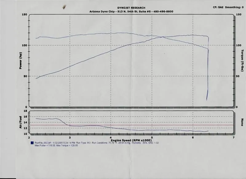

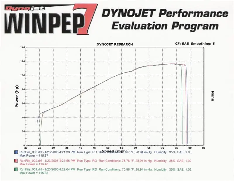

I have an actual MP3 ECU and the power band is so nice and smooth.
I have gotten used to buying premium fuel. But I really like being at 116+/- whp instead of the stock 95 whp. I dyno tomorrow to see if my new flywheel netted em any gains. There will be a new thread for that.
So all in all if you have the chance to get your MTX P5's flashed to MP3 specs then go for it.
