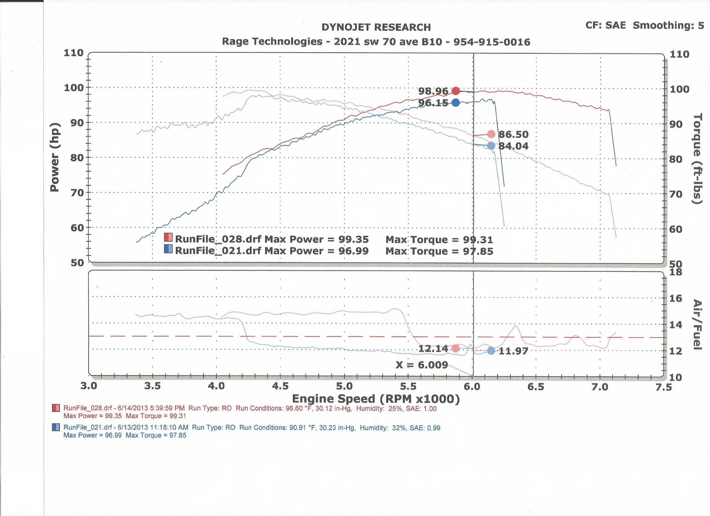

I have been gathering data about the Reflash to make sure that is something safe and reliable for me and everybody in this forum.
The reflash is amazing gives the car a great amount of torque gain in the low end also increases the HP as well. Like Derrick said the higher rpm limiter is awesome. This reflash also over rules the speed limiter and the electronic mechanism that kills the car when you press the gas and brake pedal at the same time is gone. So I can now learn how to left brake ;) . Also changes the throttle response, way earlier than factory.
The people in charge of this product have a great reputation and their costumer service is amazing. The way it works once you contact them, you file up a form with your car information so they know what kind of reflash suits you better; either you drive your car to one of the dealers they have around the country and get it done there like I did (2hrs process) or you mail your ECU to them.
Dyno sheet on June 14th 2013 (same day of the reflash) shows Numbers 1- with some mods (headers exhaust ,intake) before reflash : 96.99 HP and 97.85 Torque
1- after reflash 99.35 HP and 99.31 Torque
What I see very important is the huge increase of torque on the low end almos 7 lbs. of torque at 4000 rpms, ist feels really awesome
Fuel Efficiency : City: Factory 29 MPG after reflash 29.4 MPG average
Highway: Factory 35 MPG after reflash 33.7 MPG to 37 MPG based on driving style

Looks good. Any reason why they started the Dyno pulls so high up? I usually start at 2K. I would love to see the improvement from 2K-4K for daily driving.
The assistant doing the dyno , I was not happy , it was too late to re hook the car. I will do another dyno with the new CAI soon, before the new exhaust coming up ... ;)

I have 2 more questions. 1 How much was it. Doesn't really say anything on their site. 2. Any reason why your car was doing 15:1 A/F up to 5500 after the tune? That kinda scares me.
The cost is shown above on a previous post, I am not very knowledgeable when it comes to tuning, I know though that power gains can be found by leaning the mixture, you should email them with your concerns.

Sounds good man. I'm glad you finally got tuned. I wonder how it compares to the dyotronics tune. I wonder what my A/F mix is at right now. The car has been acting fine, but yea i think the norm would be between 12:1-14:1, so you are just above that. Peaking at 15:1 i think would be ok but the fluctuation should be around 12-14 if i'm not mistaken. I think you'll be ok. Good job on providing info and contact info for everybody to see. Another option for us all.

If you are doing a dyno pull your tune should hold a pretty constant A/F ratio. My miata fluctuates maybe +/- 0.1 when I am doing pulls so it should be consistent which is what it is in Andres dyno plot. But for a NA car 13:1 is about right unless you have some special stuff done to the engine to handle the heat like the 1st gen Honda Insight. 15:1 on full throttle up to 5500 is rather lean. If/when I get my car tunes I am going to have a meter in it so I can monitor the stuff.
I am not claiming to be a tuning expert, but this just seems really off to me.
Here's what's going on...
The two runs have different starting rpms. The AFR changes when the ECU decides to go open loop, which is based on a number of factors, one of which appears to be time at wide open throttle. I played with this a LOT on my car. The reason this is important is that the 2 makes best power close to 13:1, which is richer than the emissions-optimal 14.7:1(or higher) that it runs in closed loop. Closed loop means that it is varying the fueling based on the O2 sensors outputs to achieve that 14.7:1. Open loop means it ignores the O2 sensor and simply calculates the fuel based on what's specified in the ECU maps. This is where the tune has a chance to make more power (plus more aggressive ignition timing and cam timing).
What this means is that to correctly compare two dyno runs, you need to be extra careful in starting them at the same rpm and punching the throttle the same way every time. Two runs in a row should be made in each configuration to verify this. Your AFR plot should have the same basic transition point in each one, or you weren't consistent.
Since the "after tune" run had a higher transition point, you might actually be making more power down lower when compared to the "before" graph which started lower.
