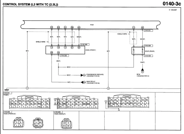

can someone please tell me where the oxygen sensor is on the Speed6 . im installing my turbo timer and cant find that wire . ECU Help please
The MS6 uses 2 oxygen sensors: One right after the turbo, which is a wideband, which I recommend you DO NOT tap into at all. There is a second O2 sensor, located after the first cat, but before the second cat. This is a normal narrow-band O2 sensor, that if you had to tap into, I would recommend this one.

You ould hook it up to the rear O2, but it will always read lean.. You will damage the ion pump in the primary O2 if you try and tap anything too it.
Hope this helps:
