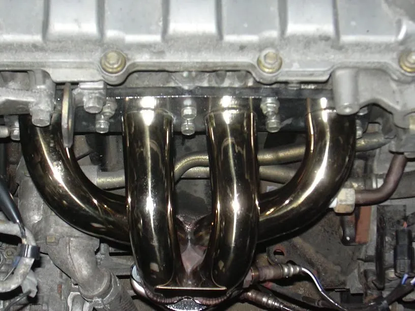

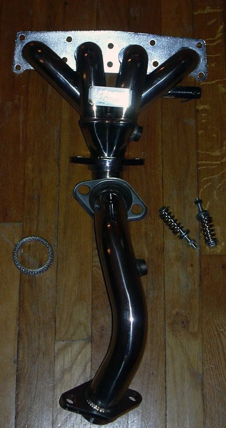

Actually, the Thunder header that I sell (or used to sell...nobody wants to pay $300
for a header any more) was probably the next best thing to the AWR...
Ya, its a nice header, wish you still got them. I woulda got that instead of the OBX. But as you said, its the NEXT best to AWR. The AWR 4-2-1 is still better...
