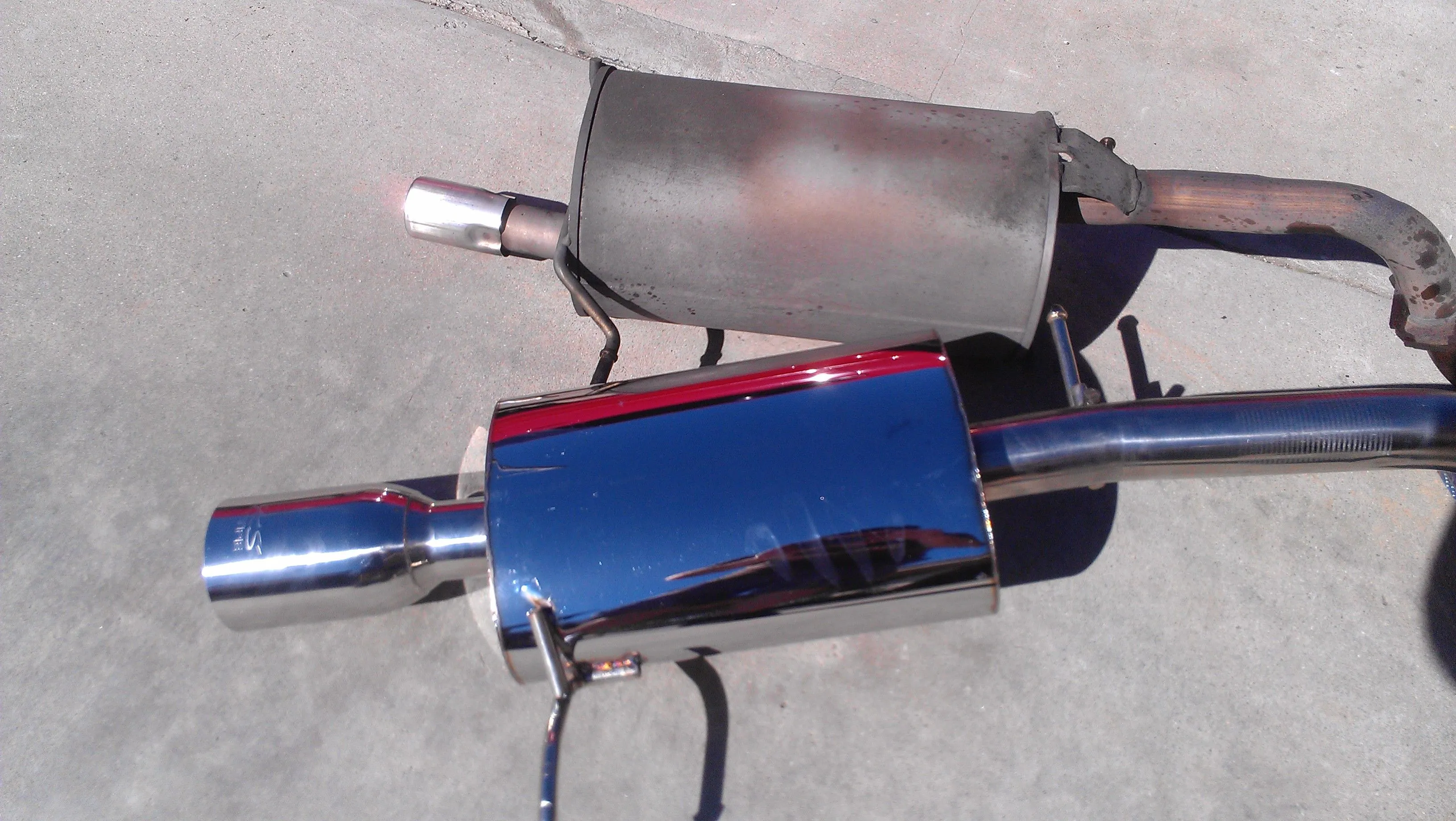

Mine came in today and I got it on. Hardly any problems getting it on, had to take the mid pipe off the car to get the bolts out of the flange but besides that she dropped right in. The welds are not the greatest. Being a tig welder my self I look at every thing with a microscope so I may just being little anal. Little bit of rub on the pipe over the rear cross member, just needs a little adjustment and she'll be golden. The sound is awesome, not much louder then stock, no drone, just nice and deep. I will say when you do this, start the car up with no catback on and hear the that is our engine. Sounds just like a Subaru with equile length headers on it.
All in all I'm very happy with this and would highly recommend it.

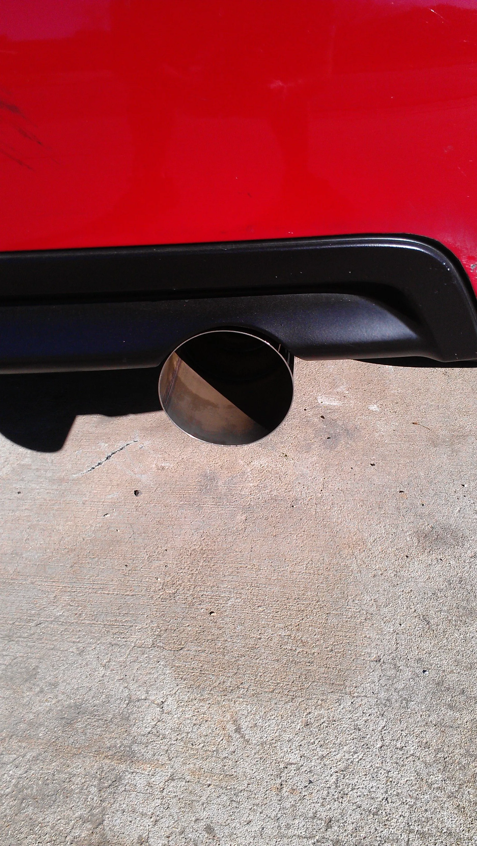

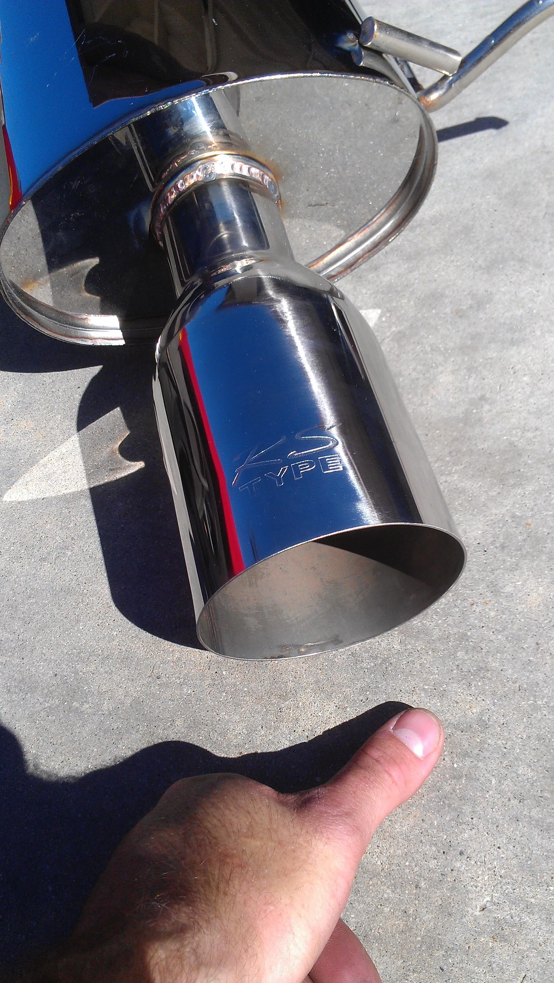

I didnt take many photos but here are some. And as weird as it may sound I kind of like the big 4 inch tip. It fits perfect in the cut out of the rear bumper(photo 3).

Thanks for posting pics. Hopefully zackmac will post pics of the rolled tip version so we can compare.

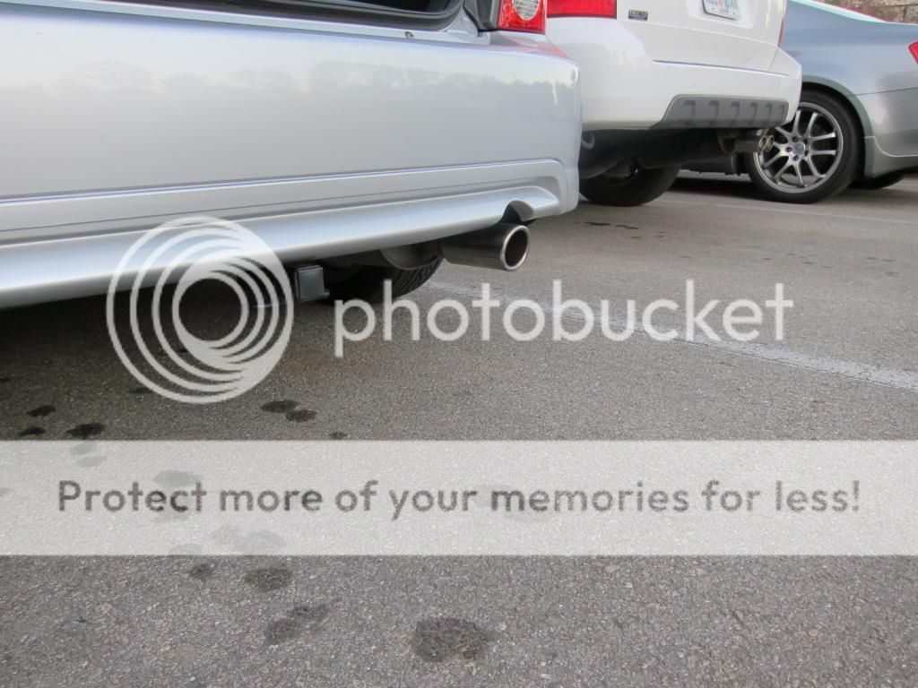

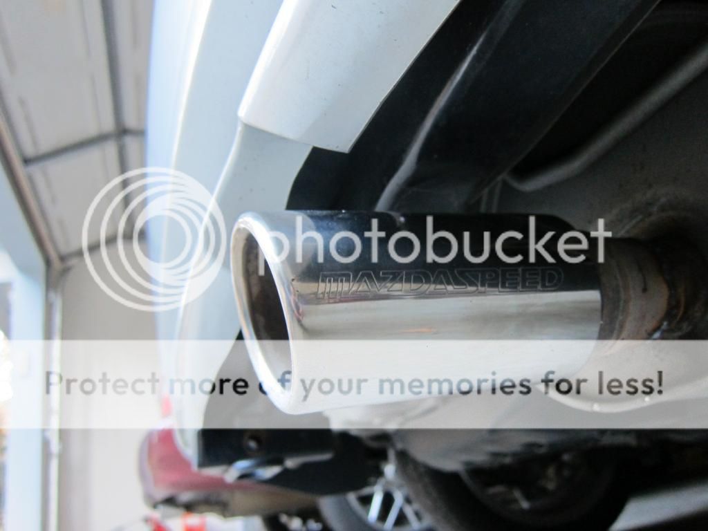

That tip looks good timuhai. I recently had a Mazdaspeed Miata tip welded on to my stock P5 muffler and that little mod made a noticeably good difference IMO. Not too big, and not as small as the stocker :-)
