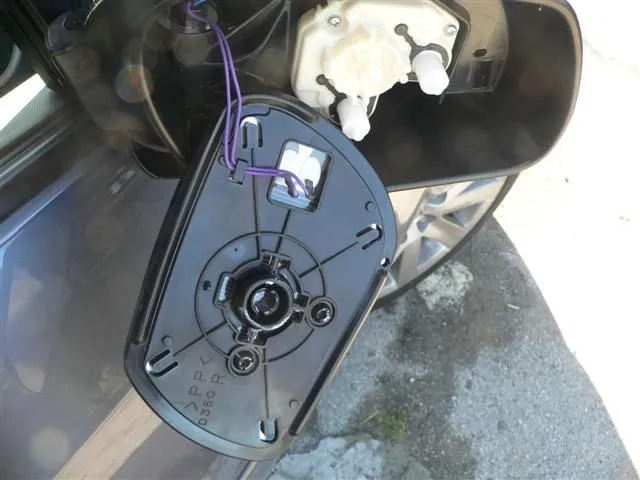

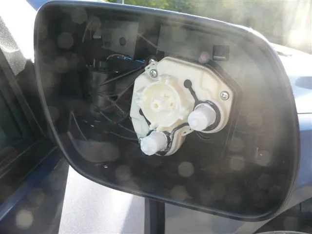

Is it just the glass that shakes or the whole mirror assembly? If it is just the mirror, it is possible the glass is not engaging one of the three plastic balls on the back. Try pushing the glass toward the back of the housing to see if it snaps in. If it is really just vibrating, you could try adding some mass to the mirror itself. It is easy to take the glass out; just rotate it until you can grab an edge, and pull and it will snap out of the balls. You can add some mass with some modling clay or epoxy putty to lower the frequency it vibrates at.
Here's a couple of pictures showing how the glass is attached.

Exactly what I was going to suggest, esp. since the dealer had the glass off the car for replacement.
