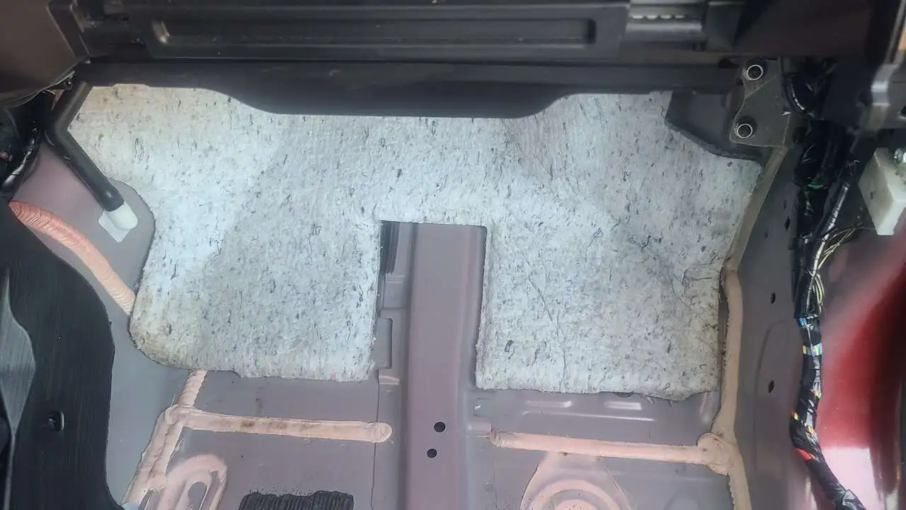

in the 1st picture that insulation is soaked but to remove it I'd have to pull the dash. What's the best way to clean that? Clorox spray, vinegar and water other ideas?

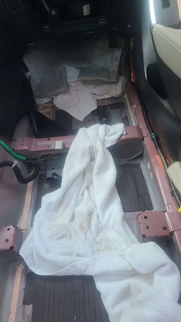

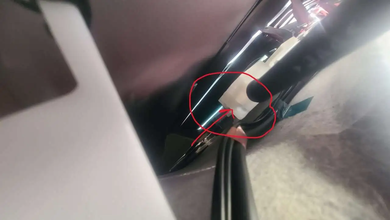

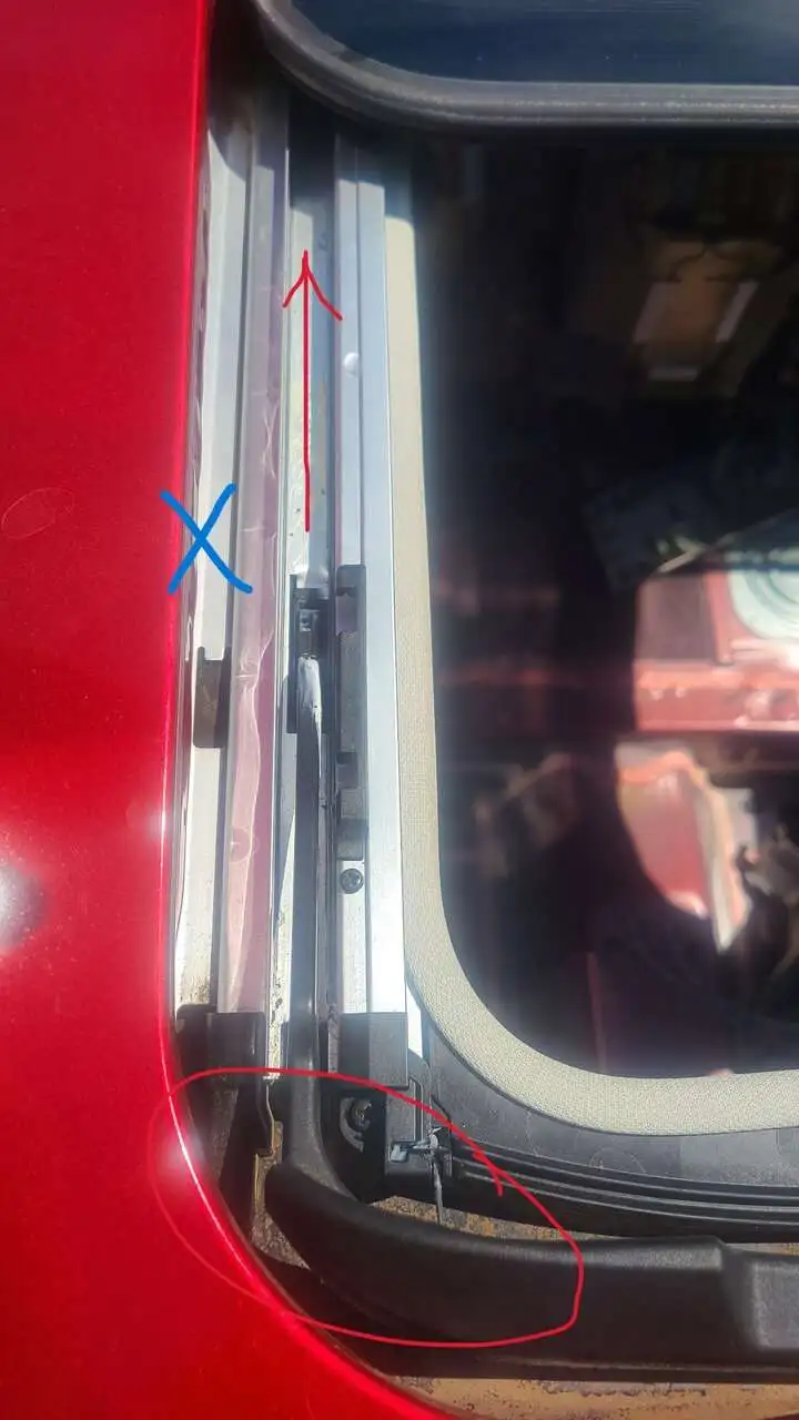

I went back to double check my theory while the carpet dries out. The front drain works fine. I pulled the headliner back a bit and checked the rear drain it is still attached but I also dumped some water towards the back of the sun roof.
Water pours out of the drain under the rear bumper if I dump water on the blue X. However if I dump water on the red arrow water runs out the back of the sunroof frame down the headliner and gets to the floorboard via the B and C pillars. I'm not sure that is the best place to dump water or if I'm pouring water someplace it should never get too, but before I put it all back together I wanted to give it a shot.
Here is the right rear sunroof drain it's attached and not clogged, however as i said above if I pour water into the red arrow water will drain to the other side of the plastic the drain is attached to. It's possible the sunroof is leaking but I had the wife hose down the car Friday night with me in it and zero water came in. It's supposed to rain tomorrow night so we'll see if I have water in the car Tuesday morning.

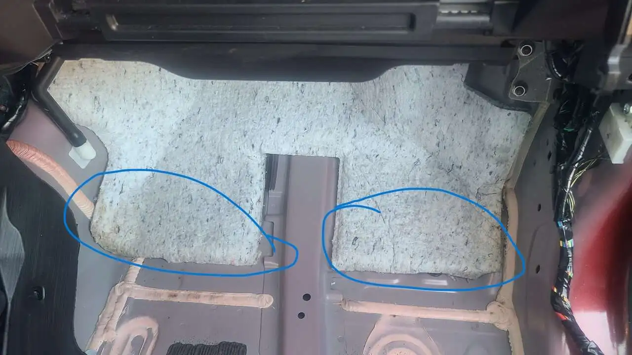

Lastly this white piece in the picture below stinks , it dried out and I hosed it down with bleach and it still smells rotten. I'm considering cutting it about 6-8" from the bottom and using interior tape to replace but I can't seem to find this material online. Does anyone know where it can be found or what exactly to search for? Ive tried firewall noise absorption or interior firewall insulation but I haven't come up with anything close to what this stuff is.
Something to try. Woolite foam carpet cleaer. It has its own scent but after it fades the oder may be gone.
Lastly this white piece in the picture below stinks , it dried out and I hosed it down with bleach and it still smells rotten ... Does anyone know where it can be found or what exactly to search for? Ive tried firewall noise absorption or interior firewall insulation but I haven't come up with anything close to what this stuff is.
Perhaps search for "carpet underlayment" (for homes). Uncertain if it's a similar material, though there is a great range of materials and types for such stuff, including antimicrobial and antifungal types.
All thanks for the help, I ended up drying everything out. The only items replaced was the white padding glued to the bottom of passenger side. I never could get the musty smell out of the white batting looking material.
A fabric shop cautioned me about using standard padding or batting as auto applications are usually treated to be heat resistant. So I ordered some auto carpet padding and doubled up on it since the OEM was 1/2".
The white material shown above under the dash finally dried out and had no smell after spraying with some diluted 30% vinegar.

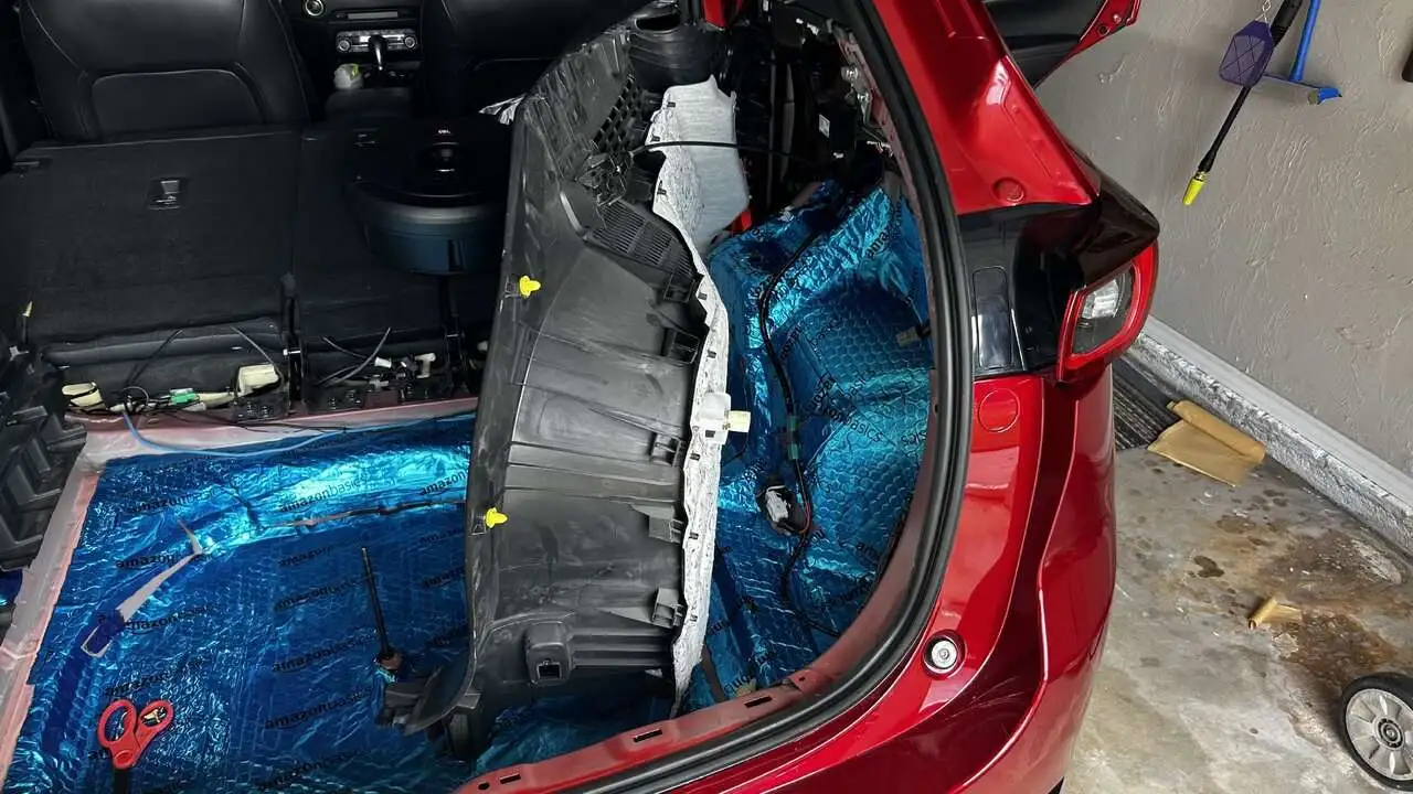

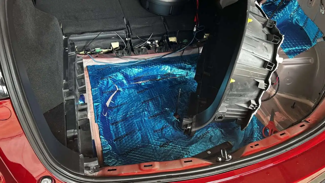

I just installed sound deading material in the cargo area and doors, the amazon basics sound deading is a rubber-based material and works better than the stock stuff, is lighter and won't absorb water.
Since I had the carpet out I went ahead and layered https://www.amazon.com (commissions earned) on the floorboards all the way to the backseats. I'm going to do the cargo area when it cools off as I have a good bit left over.
