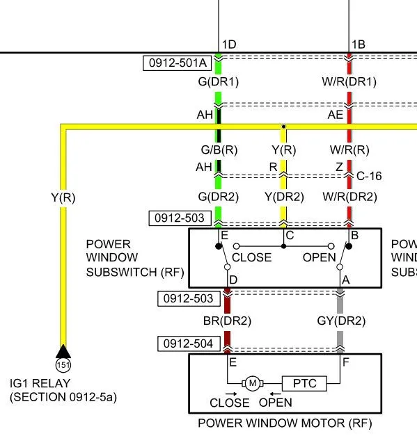

Schematic shows that there's 12V accessory power to the window switch (just like the driver side) - so you should be able to jumper to that.

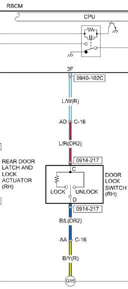

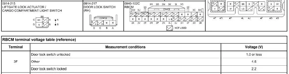

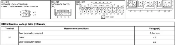

These Mazda schematics seem to be throwing me off everytime. I see a connector 0914-217 for the Door Lock Switch (RH) and only two pins populated. One (L/R) comes from the RBCM position 3F and the other (B/L) goes to GND. The terminal voltage table shows 3F to be 4.5V when the switch is not activated.
Yes, but I said the WINDOW switch connector :) . I assume it's on the same PCB, like the ones on the driver side.
Yellow wire going to conn. 0912-503:

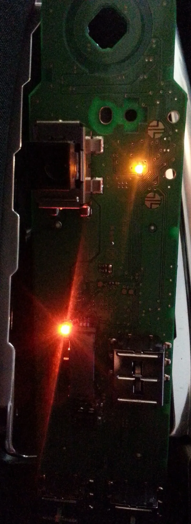

So I have installed the LED and resistor ordered from Digikey and it's not the right one.
It's orange in color and much dimmer then factory.
I would have replaced the factory one, but I don't know the specs of that LED.
I could just assume that they are the same as the ones I have ordered from Digikey?
So 90mcd, it's not bright enough.
Will need to find something brighter.
I'm very surprised it's not bright enough, based on my LED & resistor value comparisons, I would've said 90mcd was too bright! (My LED was 1300mcd at 30ma. When I ran without the filter, using a 5.1K resistor, that should've been ~2ma and thus ~100mcd - and was way too bright).
I told you it would be too yellow though :)
Sorry, missed this yesterday, so I may be too late :(
Yes, 0805 is the size. You'll need a deep orange-red to match the existing color. I'd say something at least 610nm and maybe closer to 620nm wavelength at a guess. (My bare LEDs above, were rated at 601nm and were too light an orange without the red filters.)
I was expecting much more light output from this LED.
I was planning to replace the original LED too, but then I thought about it and realized that I don't know it's specs.

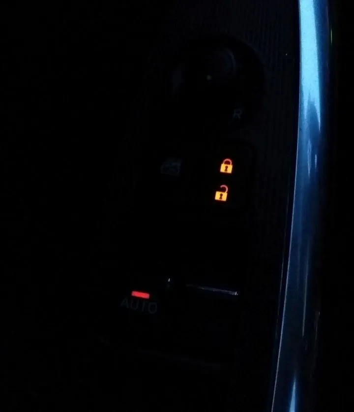

I have just replaced a previously installed amber LED, with an orange one. It looks way better(not 100% match, but very close) and brighter, than the amber from Digikey. I have picked up from Ebay, 100pcs for $1.39, if I remember right.
http://rover.ebay.com/rover/1/711-5...2&toolid=10001&campid=&icep_item=272173424833
I have took a picture, but in the picture looks way off, still amber. I don't know why, though. In reality, it looks like almost perfect. Even the chrome trim looks blueish.
