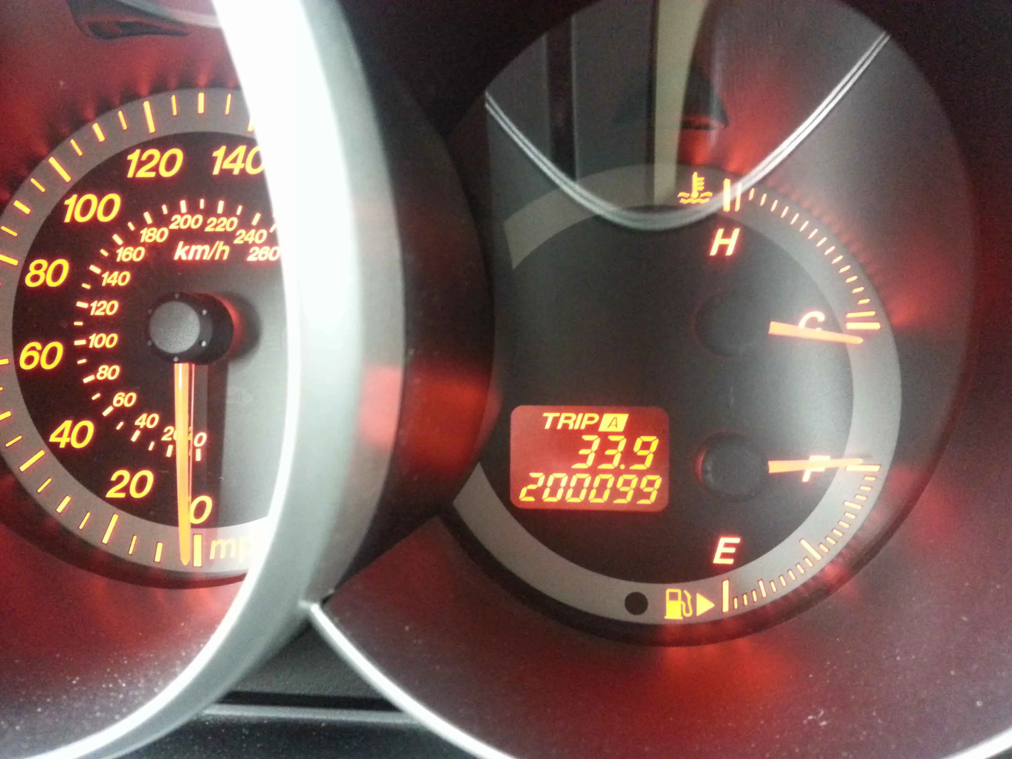

Do I have the first MS3 to go 200,000 miles?
VAspeed3
2007 MS3 purchased new October 2006
Wondering if anyone knows of another MS3 to go this far. 2007 Cosmic Blue. Car has never failed me. Replaced timing chain around 170K and the usual wear parts, but clutch and turbo seem fine. Been tracked several times at VIR.
must be stock or damn close to it
Except for Koni Sport adjustable shocks it is stock. Never thought I wanted more power, but the better chassis control is much appreciated by me, but not so much by the wife due to the stiff ride.
