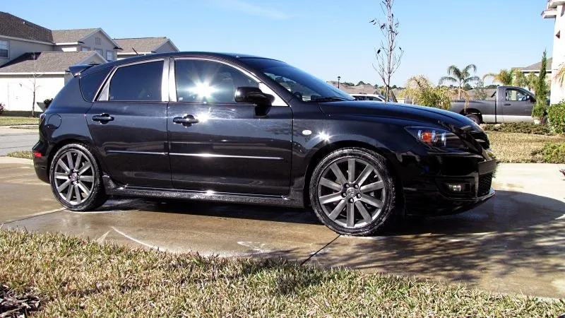

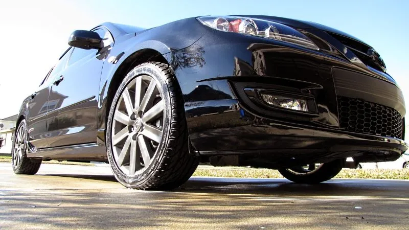

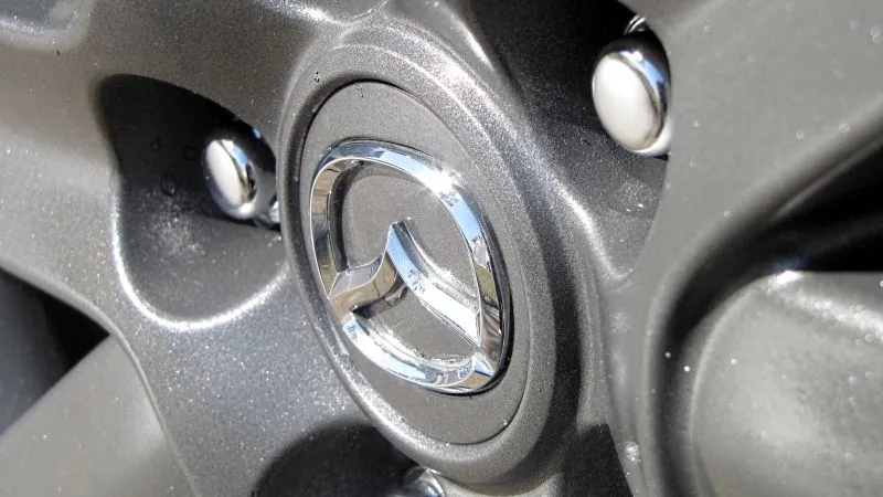

Here's mine I did last month
3 coats of primer
3 Duplicolor Graphite Grey
3 coats of clear

I dont drive a 3, I rock a protege but yea, I sanded the stockers down, 3 coats leveling clean metal primer, 3 coats duplicolor black wheel paint, 3 coats duplicolor protective wheel clear coat. Holds up great to everyday driving, but I had a leaky tire that I took in to get patched the machine they use to seat the tires scrapped it off right down to the metal along the lip ... not a big deal to me I just re-sprayed them.
my old wheels were painted with the same thing, and after a couple weeks you can actually chip the paint off of the emblem's chrome with your thumb nail.. kinda ghetto, but it works. my next set I'm actually going to do a light polish on and just go strait to the clearcoat.
